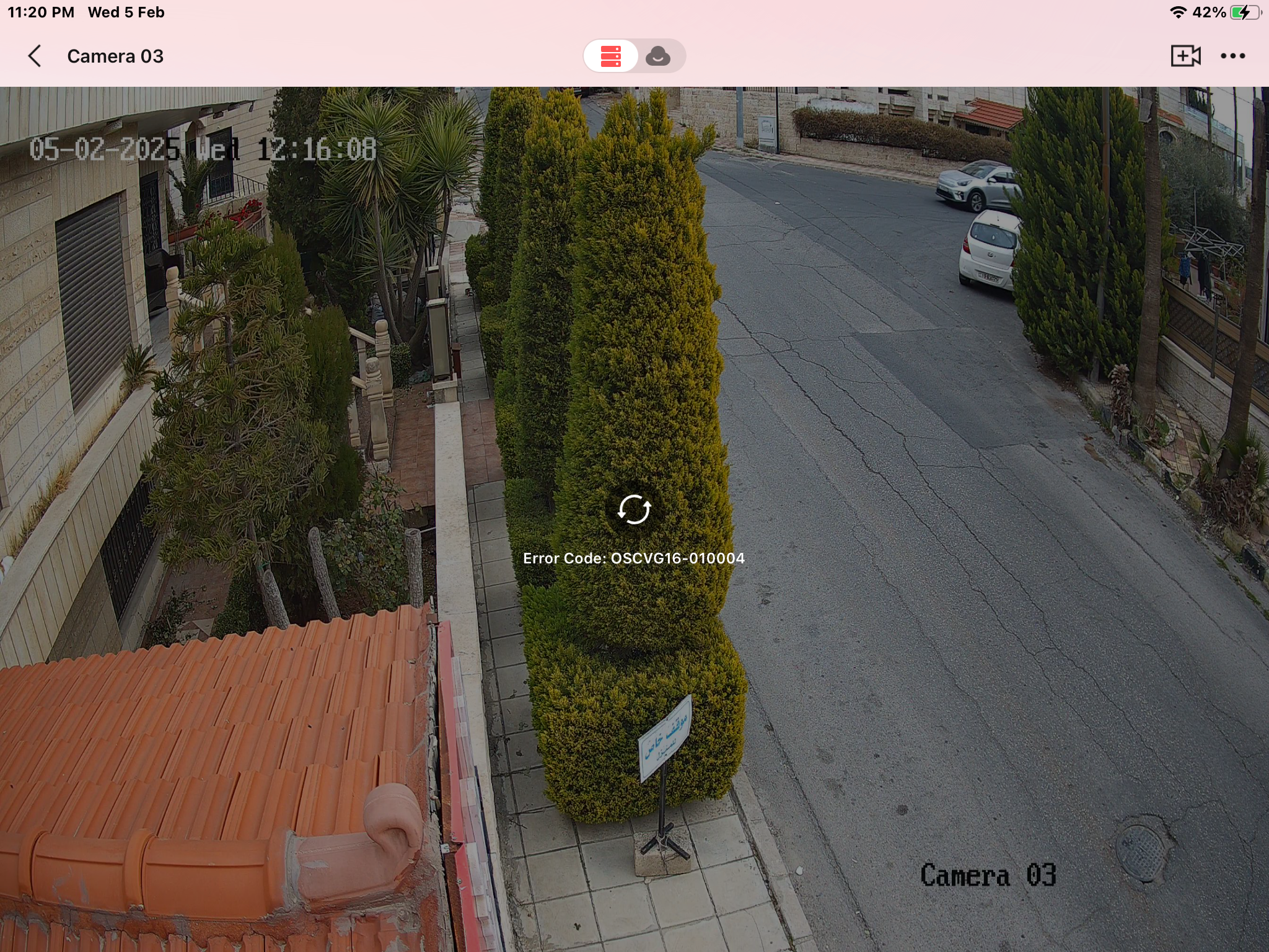

Hik-Connect Hik-connect "Error Code: OSCVG16-010004"?
windows700
9
Any idea why Hik-connect give me this Error when I play back video?

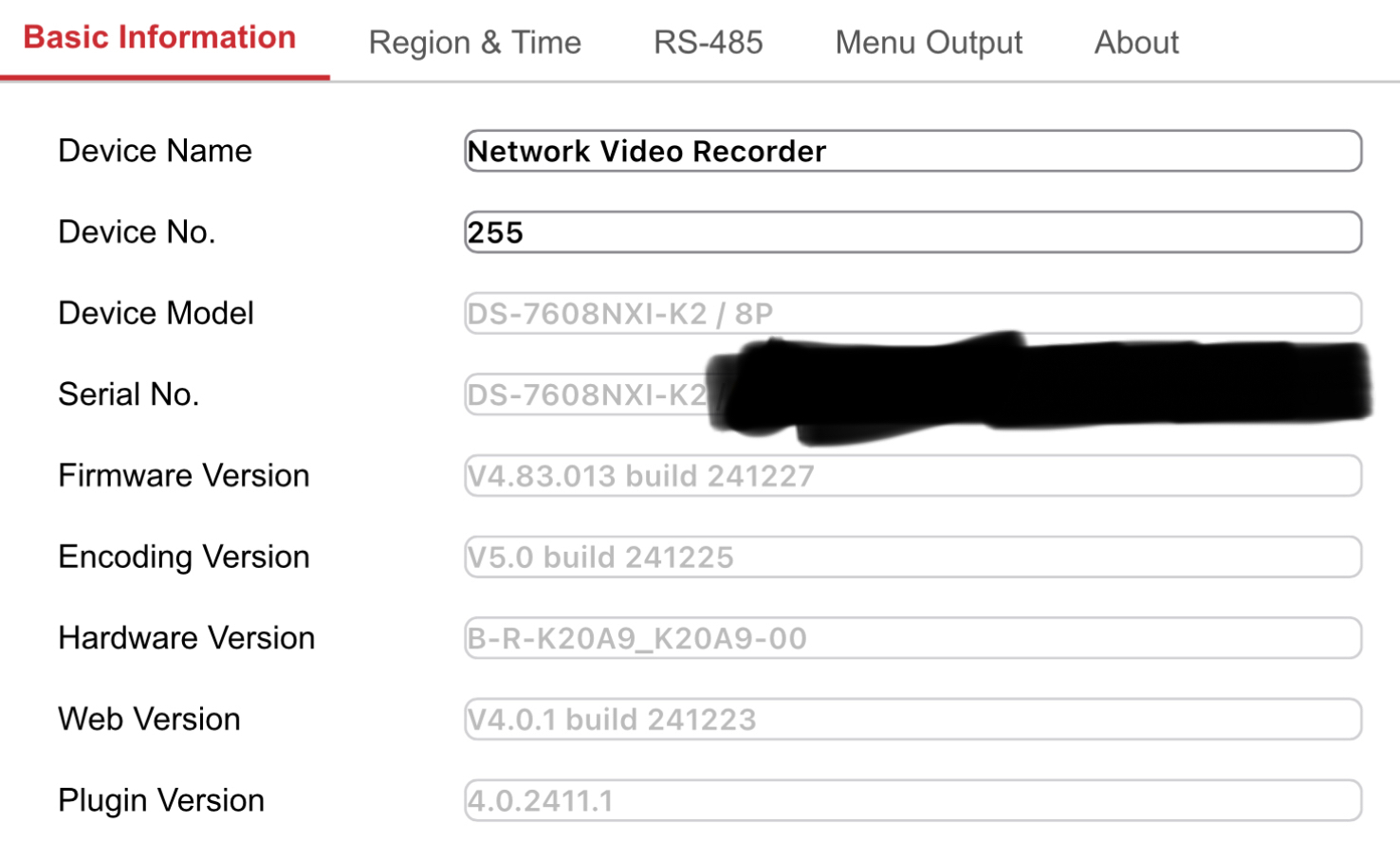

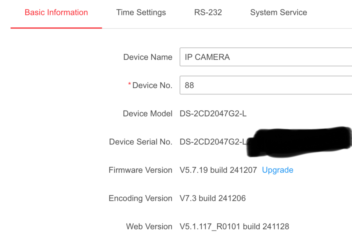

I have the latest update for NVR and cameras

Had this issue too with NXI-K firmware v4.83.013 build 241227
All versions of Android HikConnect after v6.6.500.1107 gave same error with yours OSCVG16-010004 or "Device decoding timed out. Check the device network connection".
Problem was either solved by going back to HikConnect v6.6.500.1107 or by now going back to NXI-K firmware v4.83.011 build 241205
Latest HikConnect v6.8.3.0208 works fine now
