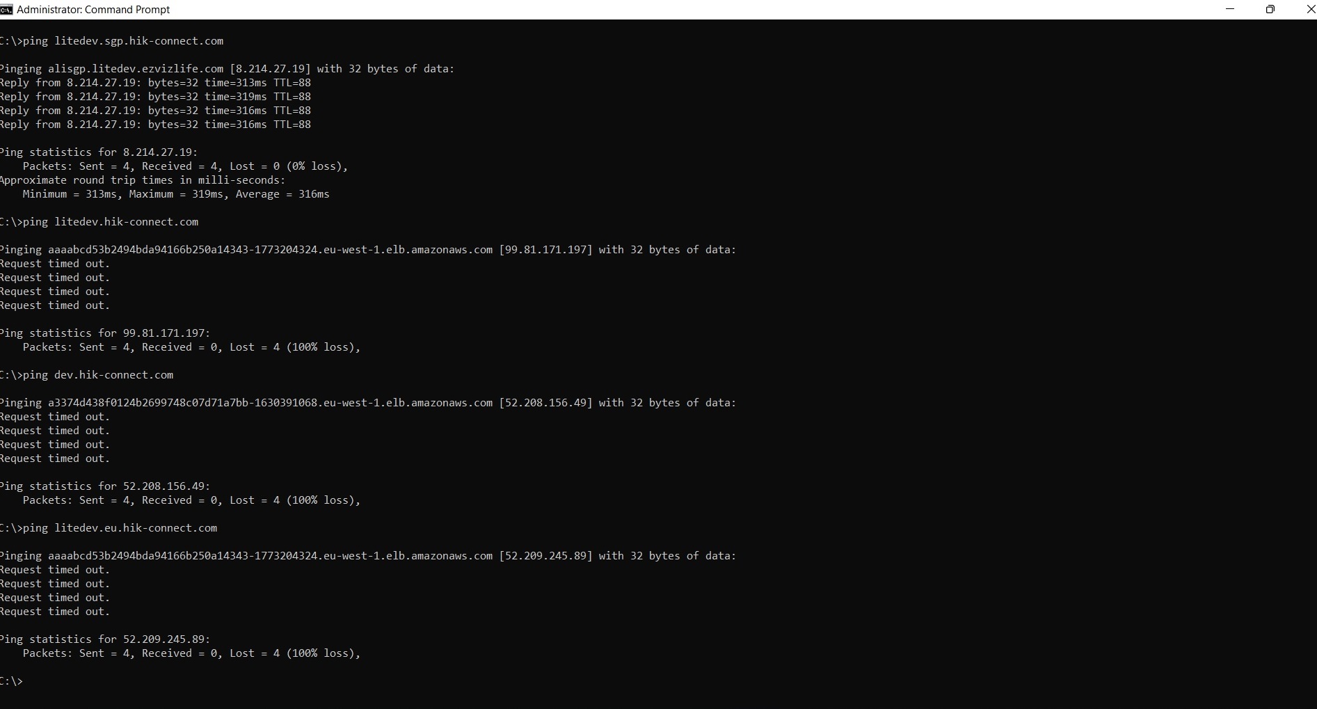

Pinging the Hik connect servers I get no response the only one I do is "litedev.sgp.hik-connect.com"

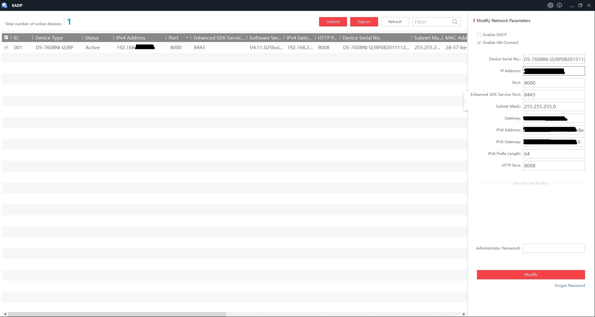

Using the SADP tool shows the NVR as online and HIK connect is enabled!

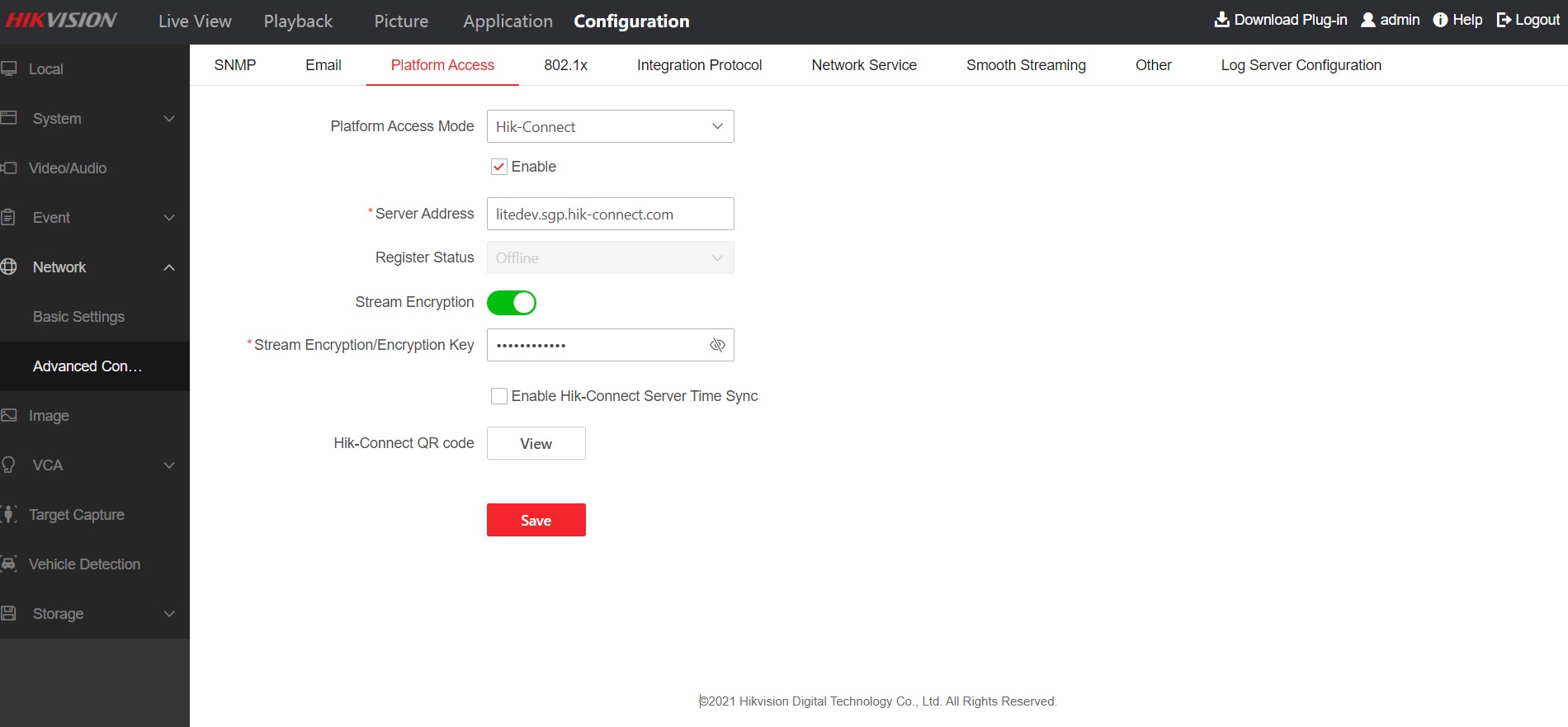

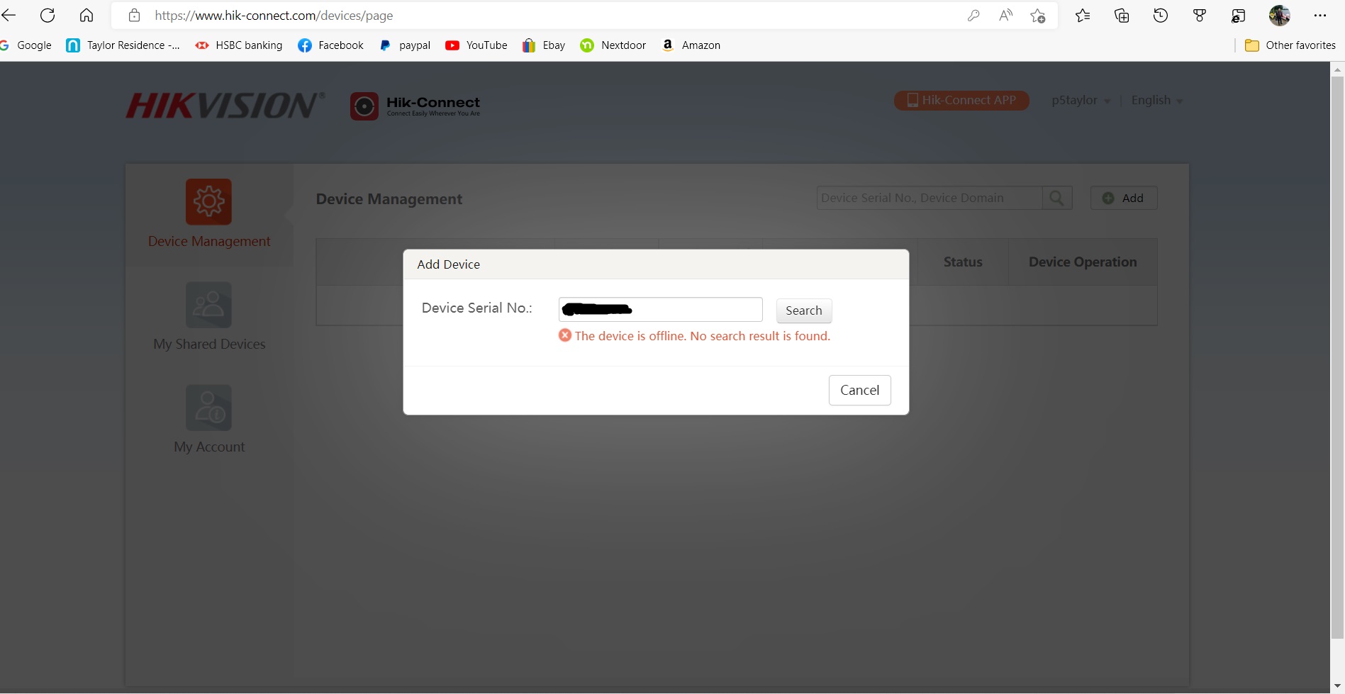

Web login for the NVR HIK connect always shows as offline regardless of server address entered, if I am correct from what i have read and from previous experience this will say online, then i should be able to use the phone app to add the NVR.​

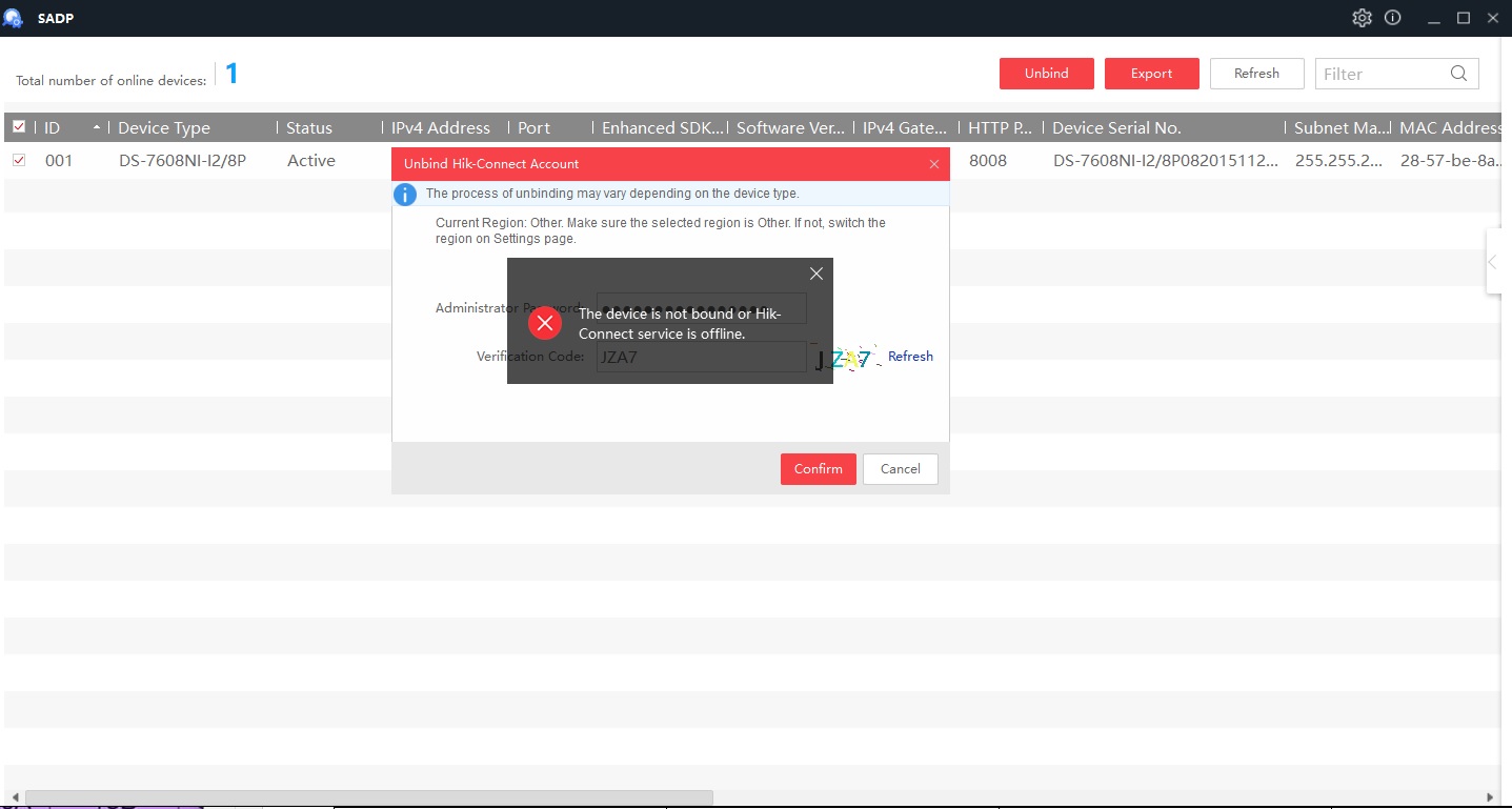

you may have to unbind your nvr / cameras from the hikconnect servers and then add them again. I would wait a few hours before re-adding them.
When I used hikconnect I had the NVR and cameras connected to hikconnect as I found it more reliable.
@p5taylor
Hi David i had already tried this in SADP and it says this:

looking at your ping tests some are resolving to amazon web services servers, what dns does your NVR use?
I used to use 8.8.8.8 and 8.8.4.4, there is also cloudflare 1.1.1.1, 1.0.0.1
@p5taylor,
Originally before the firmware update I used 8.8.8.8 and 8.8.4.4 with no probs i have also tried my router gateway as primary and 8.8.8.8 since after reading off the net with no joy, desperate times calls for desperate measures lol.

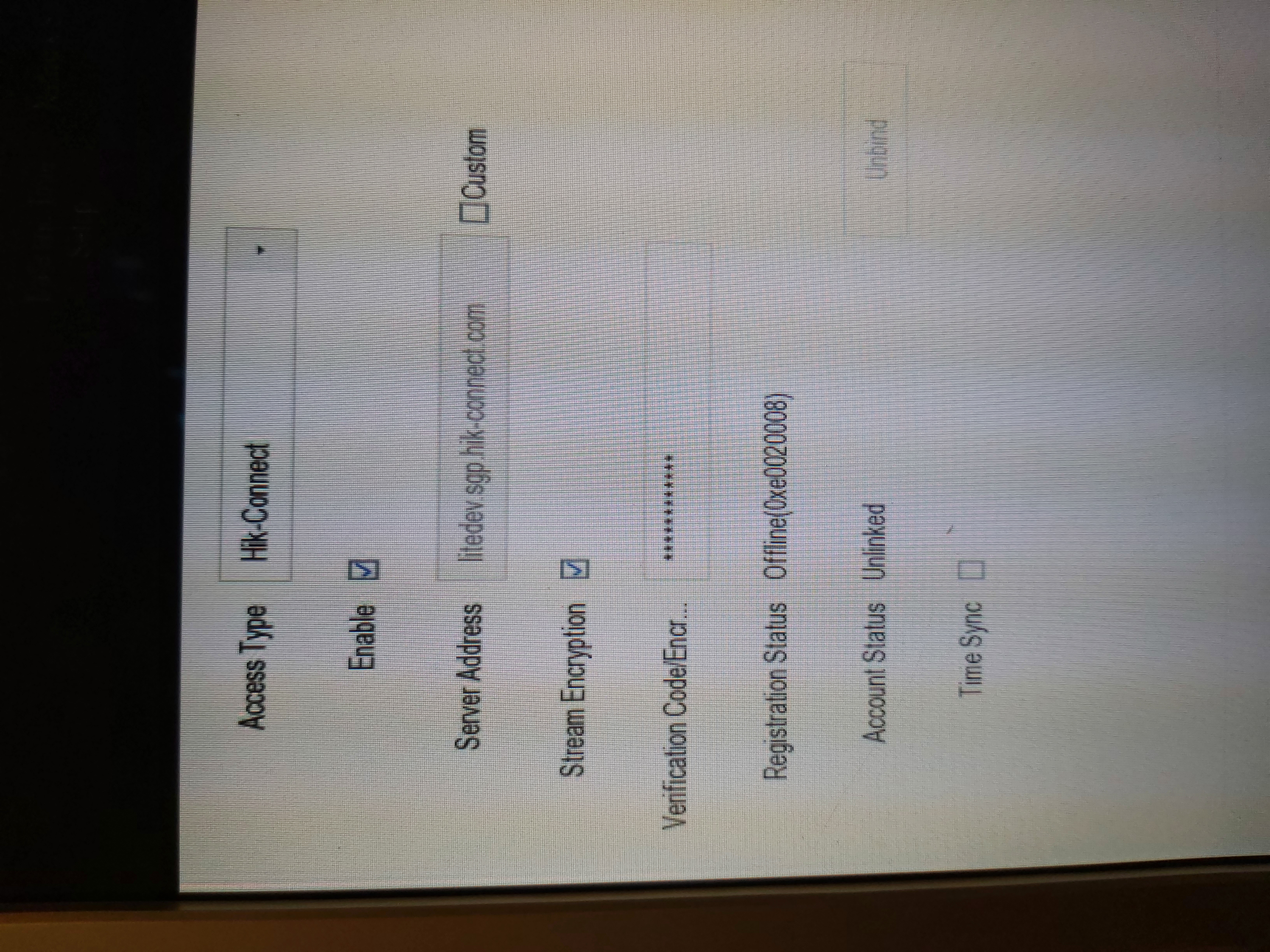

Interesting, I read the link. do you see the same error code "Registration status Offline(0xe0020008)"
The hikconnect servers could've seen your activity as unusual and put a temporary block in place, leave it a while.
I've not used hikconnect servers for a long time now, I use the app and remotely connect to my vpn server.
Hi David, No i dont get the error code but everything else ties in with pinging servers, firmware update ect., I have just tried calling the UK technical support number listed on the Hikvison uk site and what a waste of time that was "Is only for business" so no joy there. I have asked the original poster for the contact details they used, I can not think of anything else but this as I have tried every other combination and still not working.

Yes I do have virtual host on, interestingly while in the NVR last night I took a screenshot of the platform access page and I do have the same error code as the other poster had of 0xe0020008, now who do I contact to get this released.
