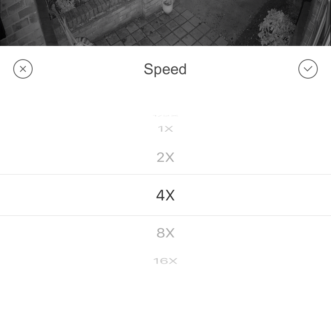

Hi, can confirm this works fine with an iPhone.

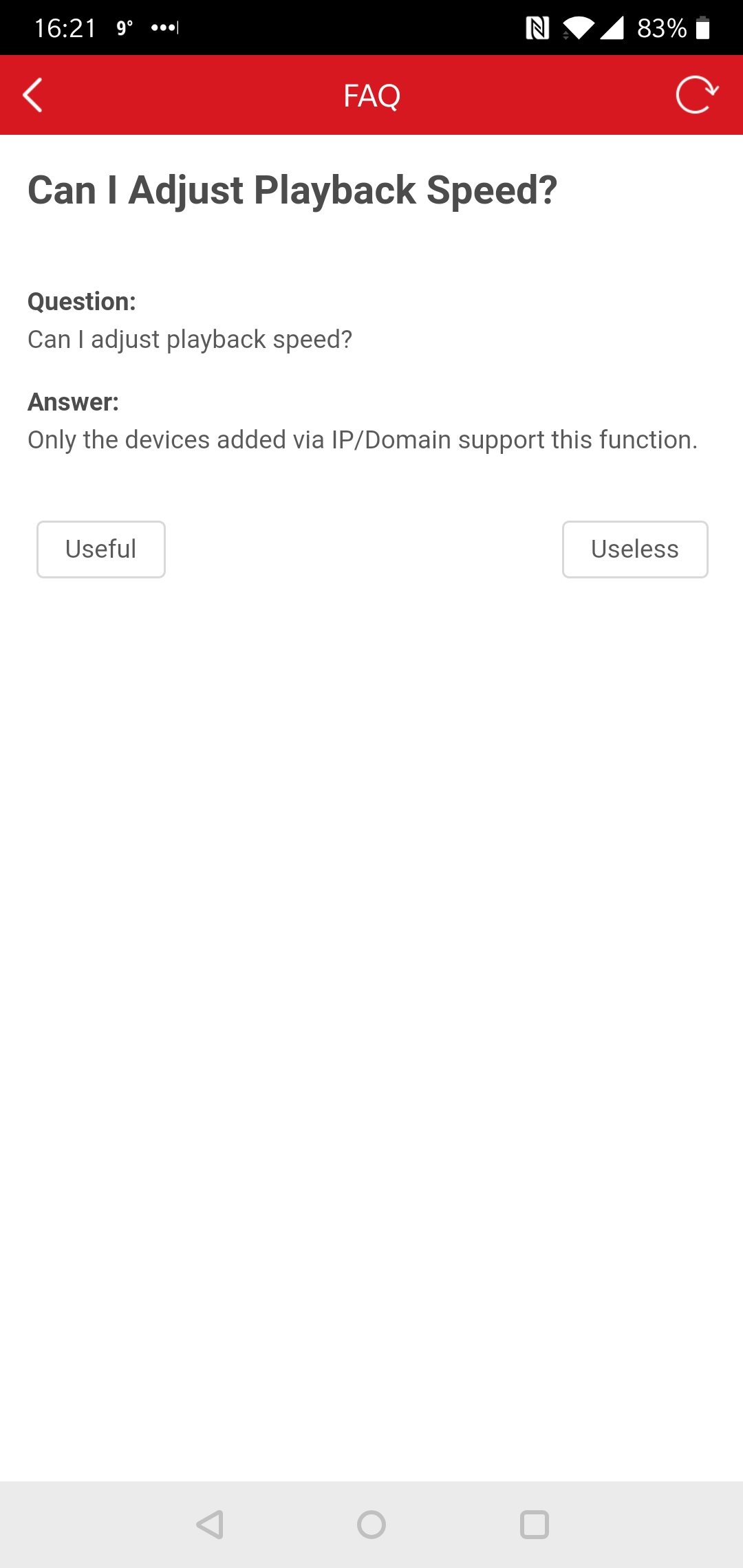

Thanks. So question answered - playback speed adjustment only for IP/Domain.
Probably because is there some extra bandwidth speed requirements or so.
See this link
https://www.hik-connect.com/views/terms/helpAndroid/Hik Editing Device Information H-C.html
It seems that Hik Connect connects directly via Hikvision DDNS service for some app features such as remote configuration,faster streaming and playback speeds faster than 1x
I've used Server port 8000 and HTTP port 80 (the link I provided shows HTTP port 8000 for some reason,maybe an error?)
Your router also needs to forward these ports for these features to work properly even though the Hik Connect app is not supposed to need any port forwarding according to what I have read.
One thing to note about the faster playback speed is that it reverts back to 1x speed after playing one clip and before continuing the next. Maybe this is bug in the app, because if you add your NVR in hik connect using a local or remote IP address or third party DDNS service such as no-ip, then faster playback speeds are continuous.

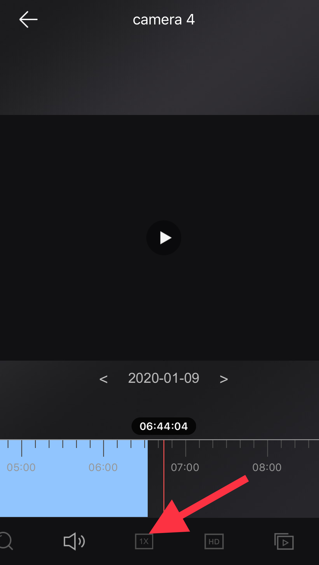

Hi im
In the same predicament and I view via an iPhone and it’s on the app . Please can you tell me how to get the speed up for playback? As you did on your iPhone?
Hi im
But that button is greyed out and doesn’t do anything . I had the cameras before in the old him connect and that gave me playback speed of 16x but this new app won’t do that
only greyed out as there is no image displayed. Well for me anyway

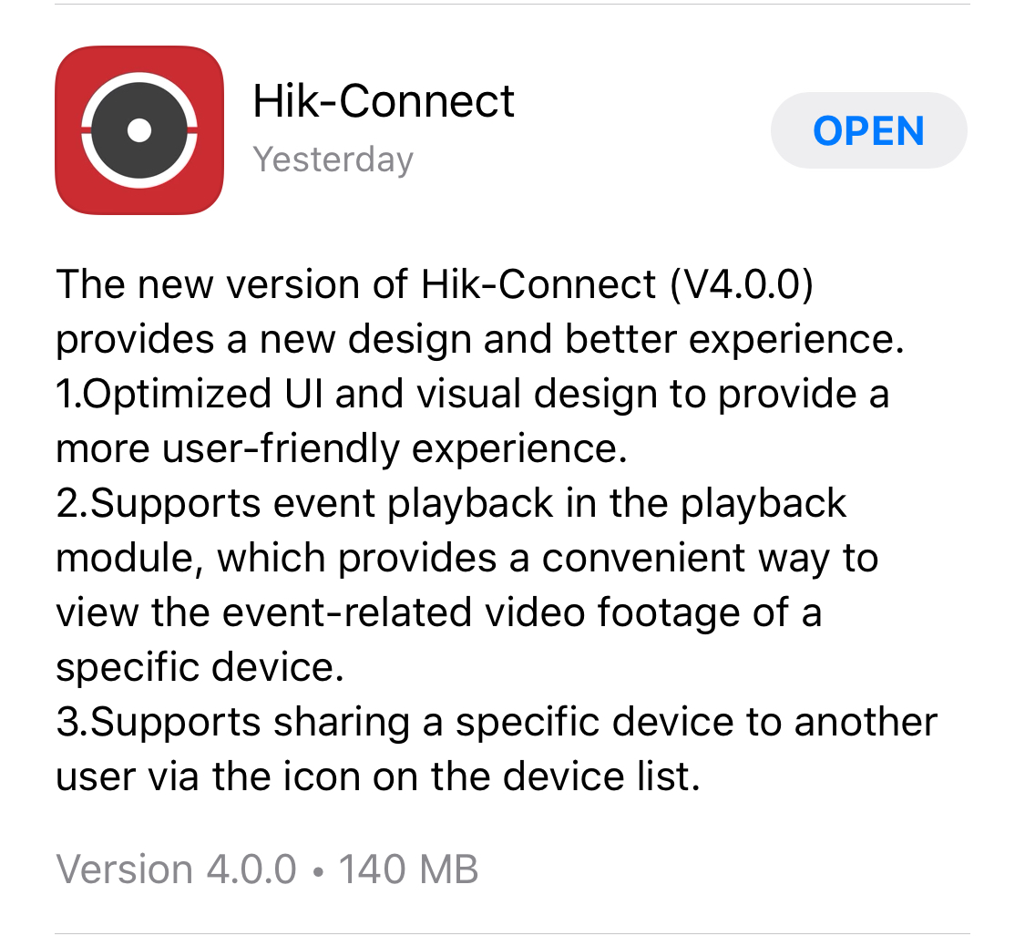

New app update :cool:
