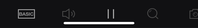

Check your sub stream settings. Hik-Connect shows the sub stream as defaults(basic) main stream(HD) needs to be selected manually.
I normally set the sub stream as 1080p @6fps.
I get this at the bottom of the screen. But it only shows “basic” or “HD”. I can’t choose the number of frames, etc.

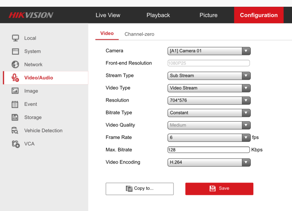

These are the settings I use for sub stream.

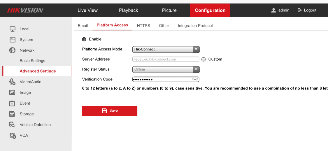

Is Hik-Connect showing online?
Yes. HikConnect showing online. I can access the streams on the app, but immediately shows the “network unstable” error.
Will change the settings on my NVR substream as you suggest. Not sure that the default setting would be ?
Hi again. I can’t seem to find that page in the settings ? I tried using the NVR’s operating system to find it but can’t see where that page is. The system is running “NVR 4.0” if that helps?
Or was your screenshot from the camera’s specific settings ? I can’t find such a page from the NVR master.

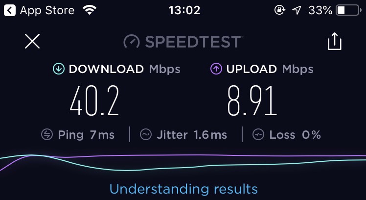

Thanks Stewart. Yes, probably more like 4Mbps which is much less than the 32!

I’ve run a speedtest on the internet connection: results attached.
Have also managed to change the settings for the substream to 6fps and the lowest resolution (320x240).
Now when I connect to the cameras, I do get a extra second or two of live streaming but then the stream freezes and I get the “network unstable” message again.
