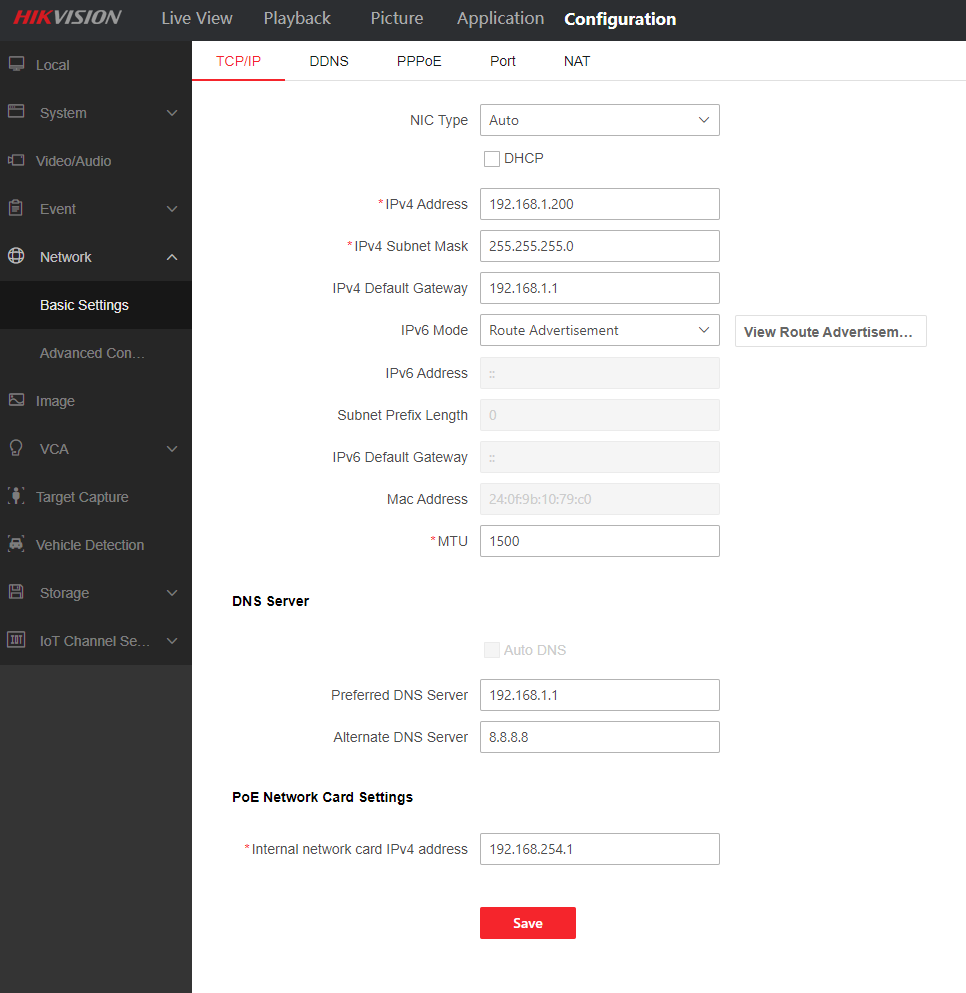

IP address of NVR on my local network is 192.168.1.200
gateway is 192.168.1.1 (my router)
have also put in DNS settings of my gateway and or 8.8.8.8 and or 8.8.4.4 but it wont come online at all

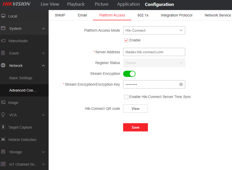

encryption key set
have tried several server addresses including
litedev.hik-connect.com
dev.hik-connect.com

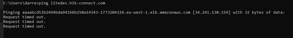

I cant even ping the address so cant see this will ever work... can anyone else ping these servers?

Hi @scotta
However unable to get the Hik-Connect online at all on the NVR.
The "Register Status" in the platform access configuration picture you sent above shows you are "Online"! :)
I think you have everything on the NVR set correctly.
I can't ping the Hik-connect servers either... I'm not sure if they reply to ping or if it's my firewall but in any case my setup is similar to yours and the main hurdle is to see the "Online" register status which you have working.

I cant believe I did this..I tried so many times with so many combinations and it always said offline. I put them back to defaults to take the picture snip and just noticed the status was greyed out so probably assumed it was still offline, was expecting it to go bold like the rest of the settings when online. Sorry for wasting your time, all set up now and working fine. thank you...i feel rather silly now!
