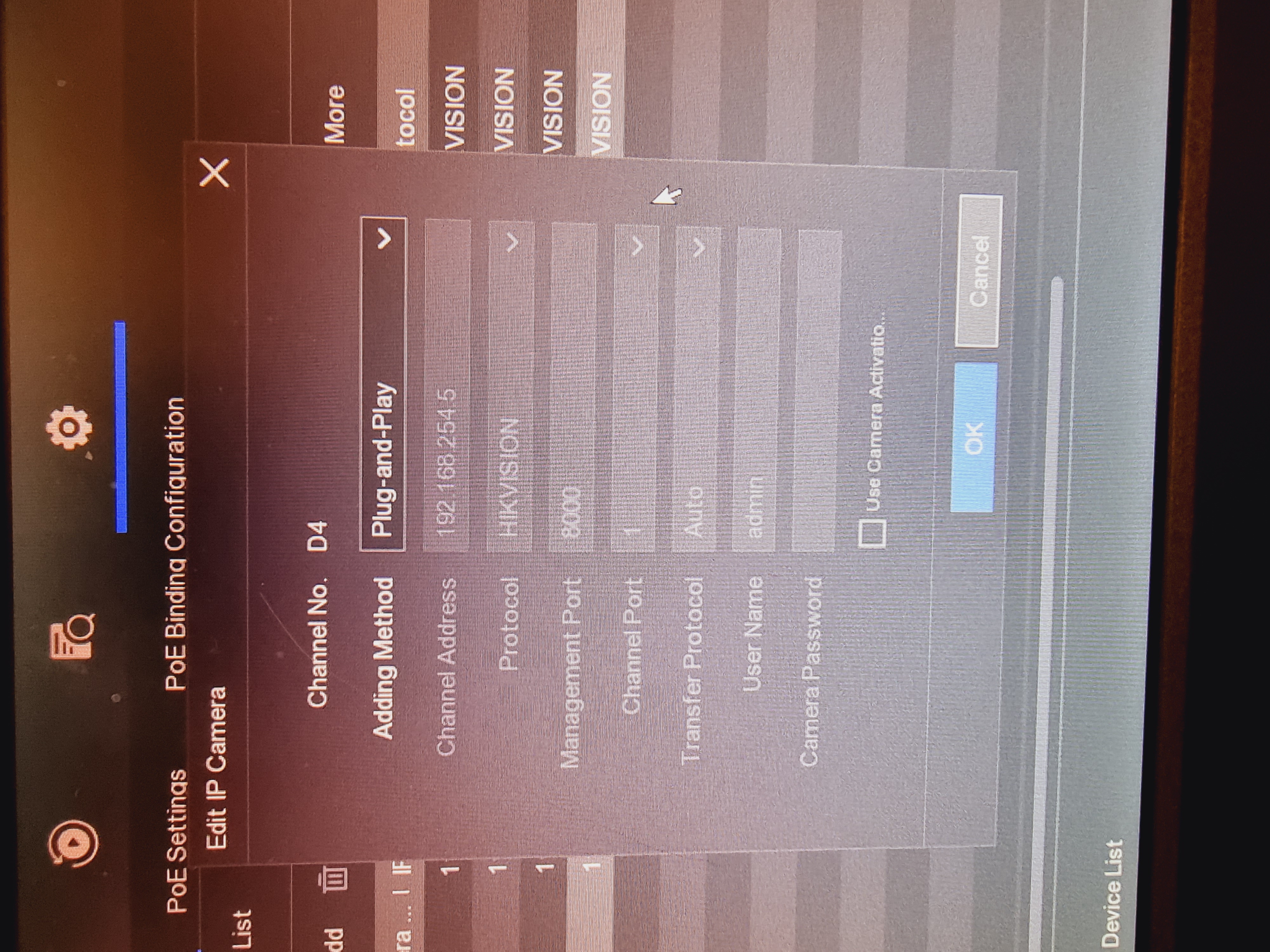

With regard to the cameras being out, the first thing to check is to go into the local NVR menu > Camera Settings. In the top right corner click the icon to put them in list view. Then on each camera click the edit icon to the right of the IP addresss. In the resulting pop up box, the third box from bottom "Enable IP Camera Time Sync" should be ticked as that is what ensures the cameras have the same time as the NVR. It should be ticked by default and I've never seen the issues you're having, so while you're in that pop up box can you also confirm that adding method at the top is set to "Plug and Play" for each camera. If it's set as "Manual" and the camera was set up manually BEFORE being added to the NVR then that'll be the likely cause of your issues as the cameras time settings may be set differently. Post back here what you find but don't change it to Plug and Play if it isn't already as you'll lose connection to the cameras and you'll need to reconfigure to find them again.

There is no option to sync the time on the camera settings

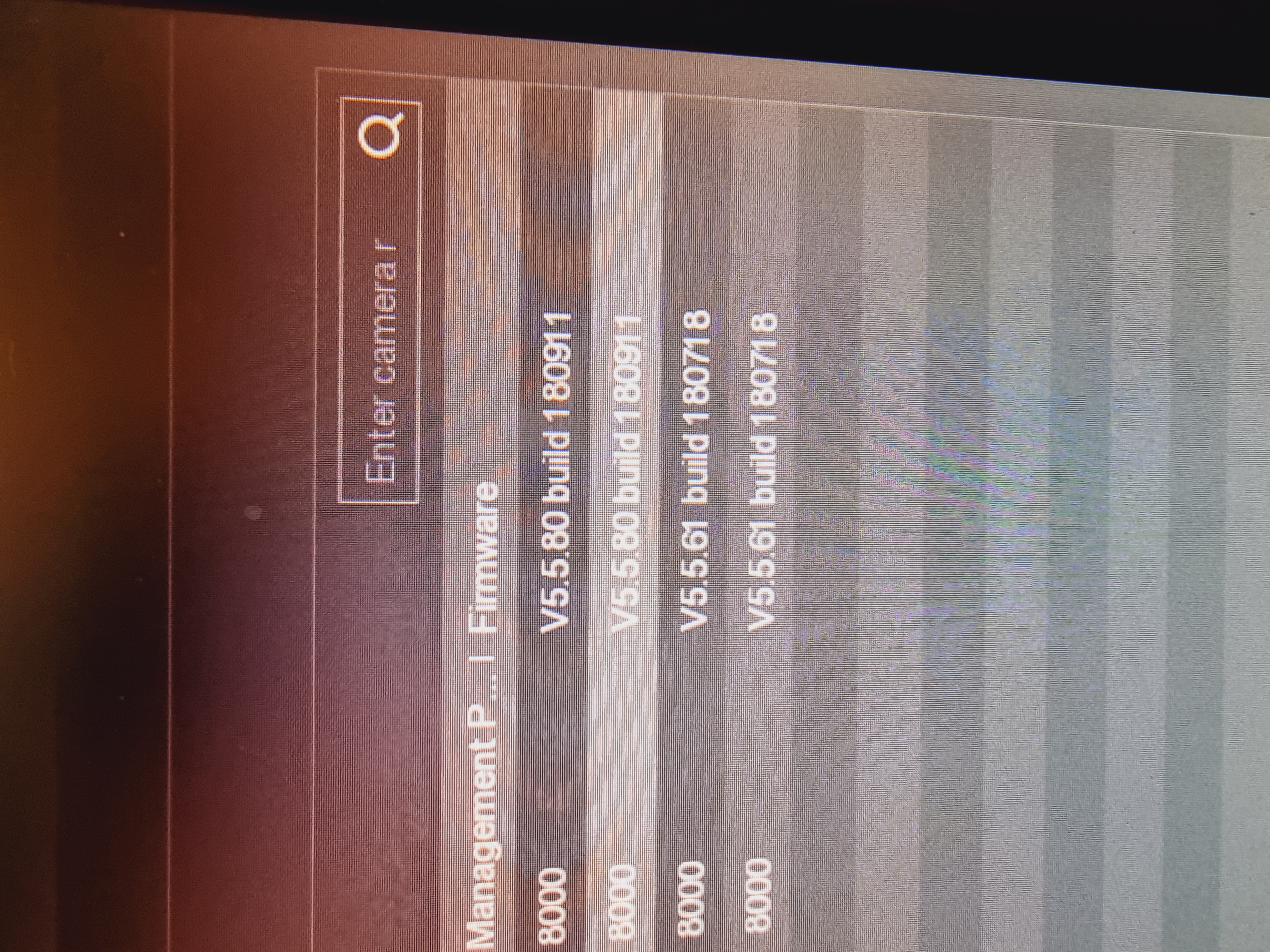

What I did notice is that the cameras are running different firmware, the two bottom cameras are the ones with different times.
Could this be causing the problem?

I've now realised the problem is that the cameras are about 9 firmware versions behind and two of them are running a different version of firmware to the other two.
So I now need to update all the firmware to the latest but I'm beat at the first hurdle, I can't login to the cameras.

So starting with that there's no option for the IP camera time sync. It's not a problem - mine are configured manually so I guess it's done automatically without an option when using plug and play.
Out of date firmware would be unlikely to cause a time sync issue but there's no harm and its usually recommended to keep NVR and cameras up to date.

Depends what version you’re on. Example - if a camera is on 5.1.1 and you wanted to get to 5.4.9 it would be wise to first go through any single 5.2.x and 5.3.x version before updating to 5.4.9 (3 updates regardless of how many are listed) However if a camera was on 5.4.1 you’d jump straight to 5.4.9 even if there was a 5.4.2, 5.4.3 etc. Hope that makes sense.
