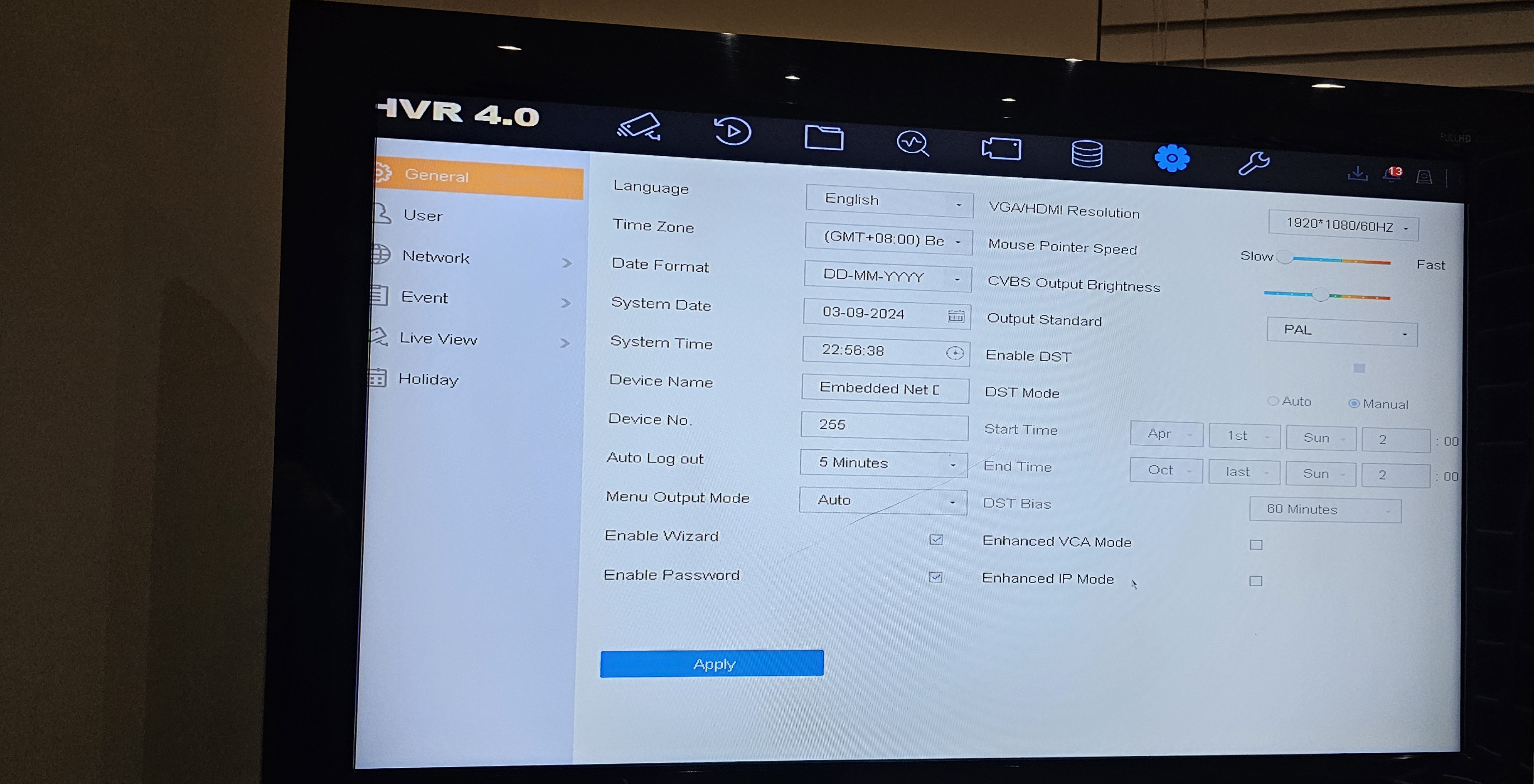

I tried entering the random IP address as suggested , but wasn't sure which IP address box to use as there were a few so just entered it in the first one as per screenshot. The dchp box was ticked already so I unticked it and followed your instructions.

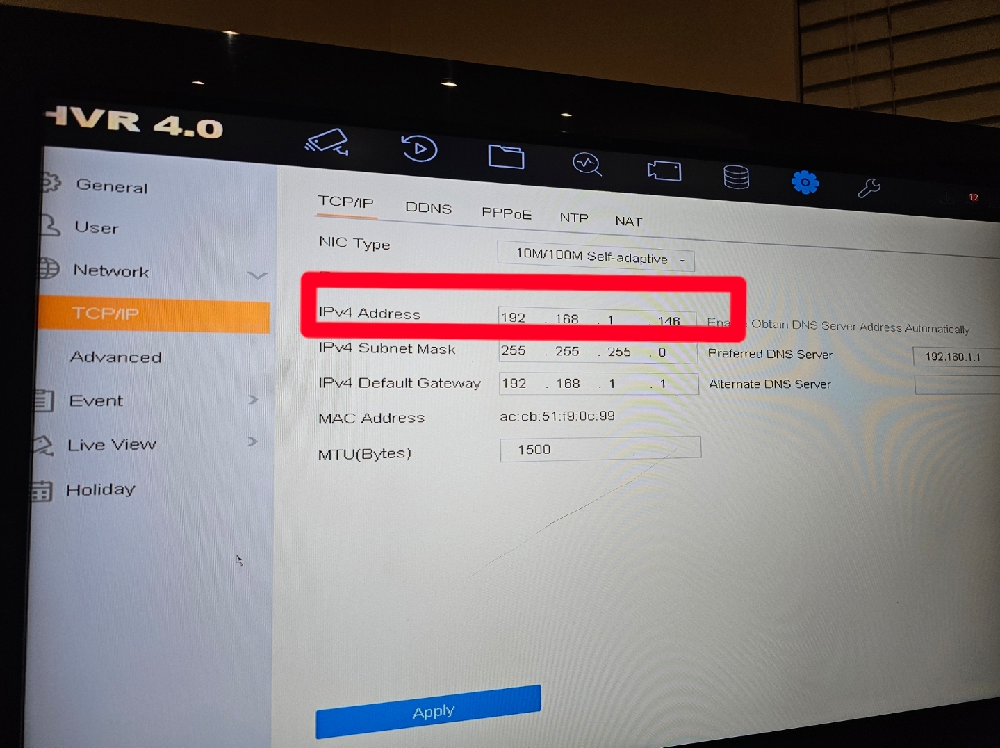

It DID repopulate the IP address as per screenshot
What does that mean?

That means it’s connected to your router, as it has assigned the NVR an IP address.
