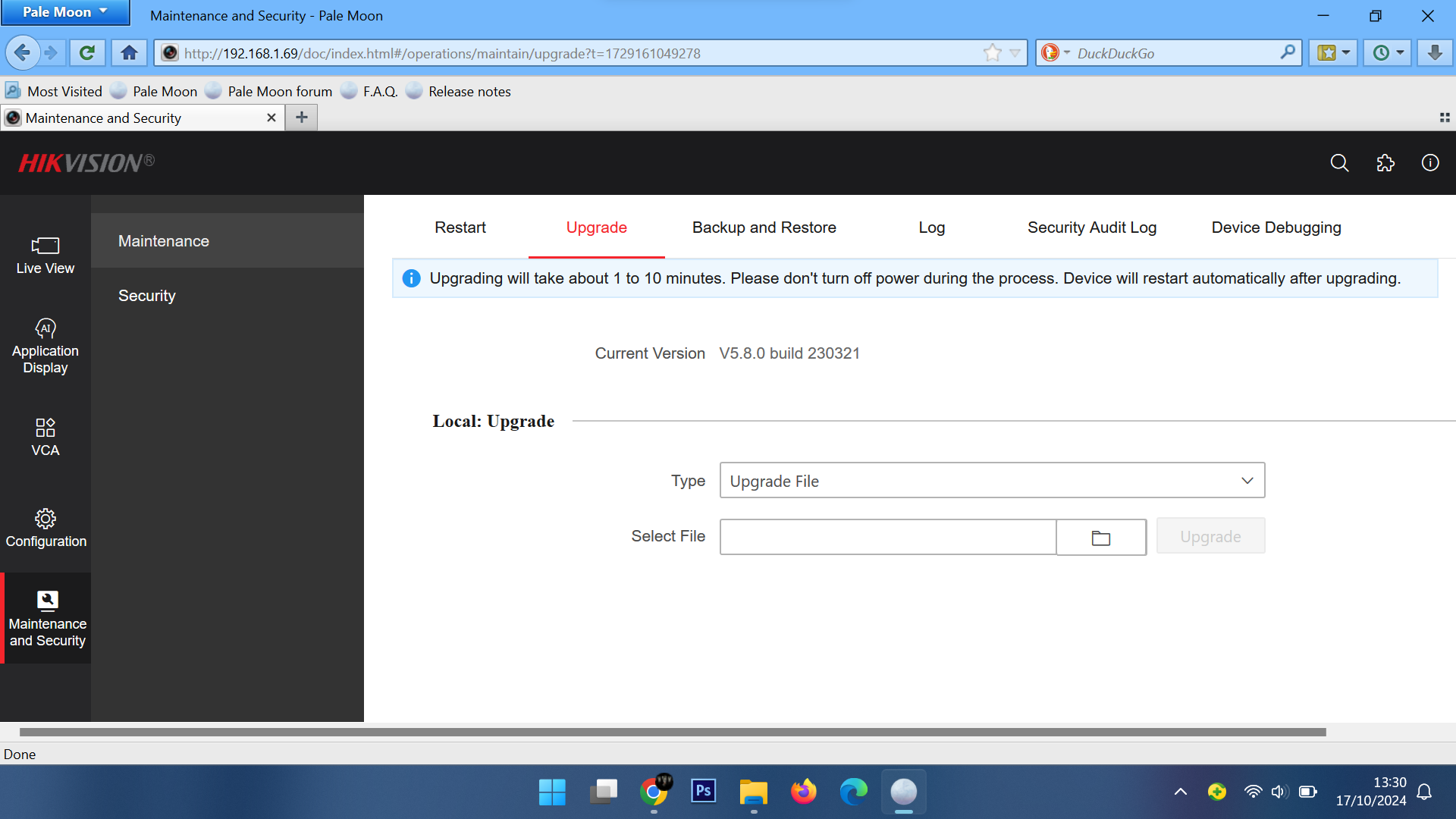

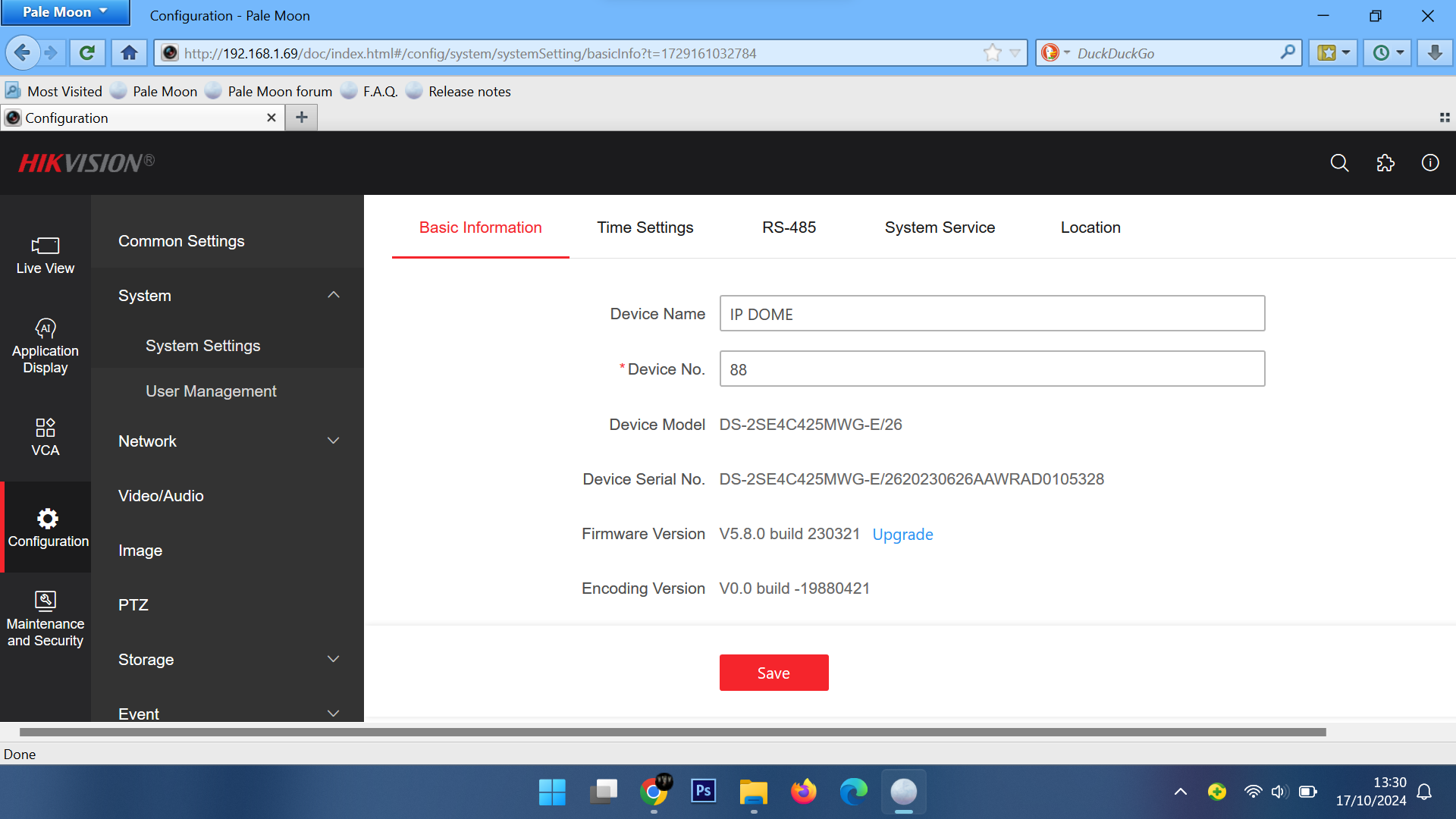

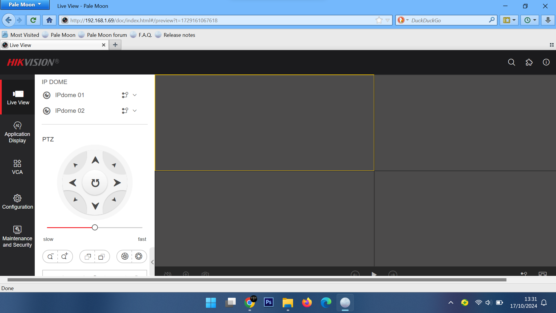

Hi guys.
I have this ptz ds-2se4c425mwg-e-26-f0 camera. I can view the camera in the SADP tool and in the web browser but the cameras don't show any images and videos.
I have tried to upgrade the firmware using the batch configuration tool but all in vain. It failed to show videos on the NVR as well. It also has a boot loop every after 15 minutes.
I have tried using Pale Moon browser 32 bit and IE but the issue of the reboot every 15 minutes is still existing.
Surprisingly I have 3 cameras and it's the only one doing this.
Unfortunately, I can log into the camera and access its settings but it won't display anything. Attached is the image of what I see.
Any other advice, please..

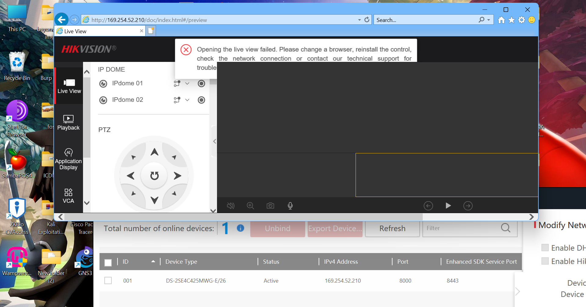

Save this code as Internet_Explorer.vbs
CreateObject("InternetExplorer.Application").Visible=true
Run this script
Install plugin/Allow on web interface opened.
Do you see the video now?
Run this script
Cheers,
Hello, trempa92
I have saved the script as .vbs but I still can't view any video.
Attached is an image of what the camera shows.
Could be an issue because you have set yourself in the subnet of default IP address when there is no DHCP server. Would you please try and assign a normal subnet range?
I have tried assigning it to another address class C 192.168.1.5 255.255.255.0 and also tried DHCP, but it still failed.
I am considering using the TFTP server, but can someone advise before trying it, please?
Is the problem boot-looping camera installed?
e.g. on the end of the intended site cable
Have you tested it with a short factory-made patch lead network cable (not screened)?
