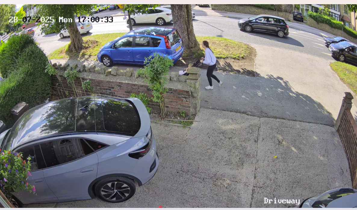

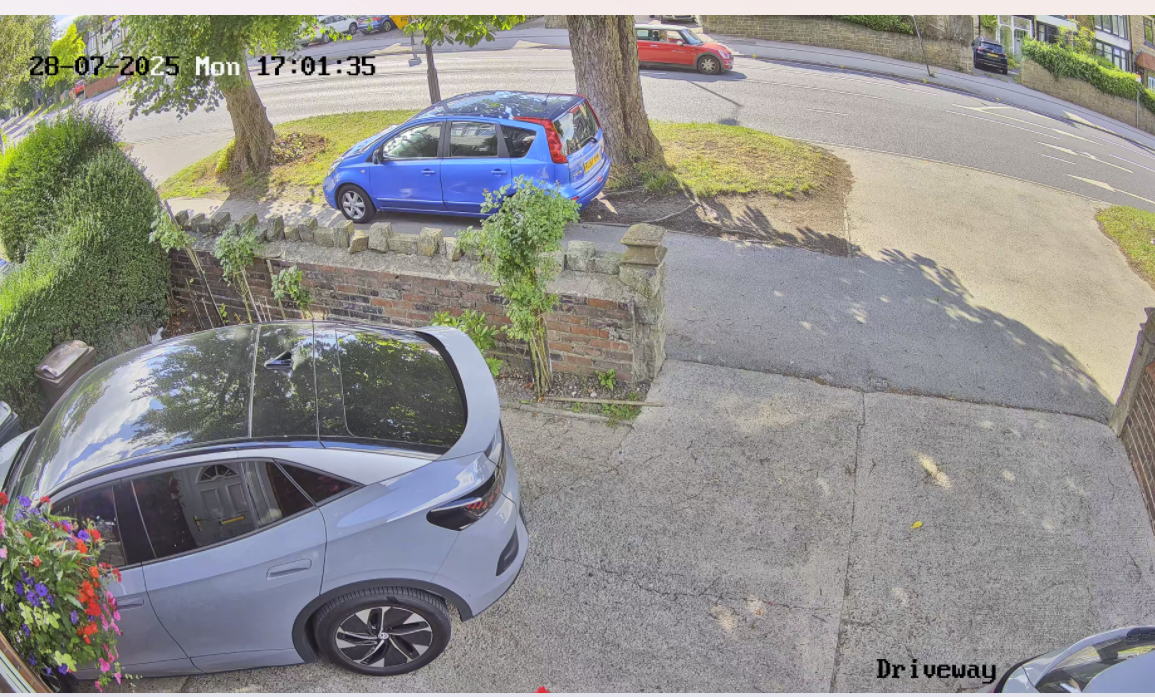

Sorry I’ve got another few questions about wdr on the g3 4k hik cameras. I think I’ve wrongly assumed that when wdr is in auto mode and the slider at 50, the camera will automatically apply however much is needed between 1 and 50 to optimise the scene. That doesn’t seem to be the case.
If you see the attached images the washed out image is with wdr on and the image where the scene looks quite crisp is with wdr off.
Therefore I am best just to keep it off all the time?
Thanks

@JB1970
Thanks
The 4MP versions I have use a different firmware to the 8MP ones. I've left Auto WDR on and it does not apply it all of the time, so I'm not sure why it is on yours. Perhaps leave it on and check footage when the car is not there. When mine is parked in front of the camera the WDR kicks in and brightens the image. Nothing that's 'auto' will ever be perfect as your relying on the camera to interpret what's in the scene and adjust itself accordingly.
