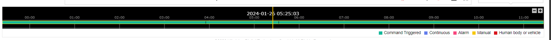

I have SD cards in all my cameras as well and ANR function is enabled. For now everything is okay. The problem/issue that i am facing is the fact that a week ago one of my cameras lost connectivity for some reason( the issue was in the switch, because when i restart it everything is working). The camera power was not lost and the recording was stored on the SD card. When i checked the playback from the NVR i can see the ANR(it is mark as green - command triggered) in the event but it is only continues. It is recording 24/7 without stopping. This means that for the past week that the camera was network disconnected i have only for the last 24 hours the recordings(everything from the other 6 days is gone because it was overwritten).

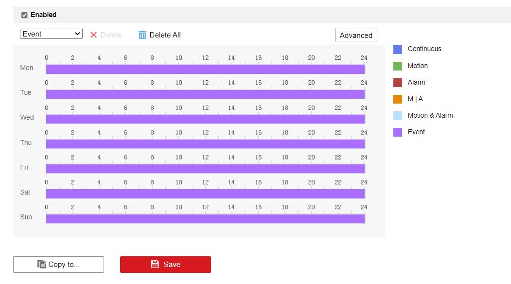

These are the settings from the NVR :

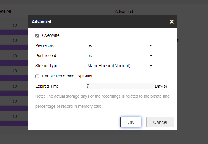

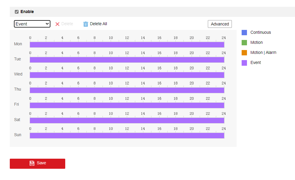

These are the settings from the camera:

ANR records to the camera SD if the network is unavailable and then when reconnected to the network, copies the video from the SD back to the recorder. Your screenshots show that you have 24/7 event recording enabled so I'd expect the camera to only record on event when ANR kicks in, but maybe it overrides that setting and records continuously.

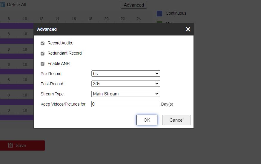

What's the 'Redundant Record' setting you have enabled? I'm not aware of that setting. Could that be causing a conflict?
Edit: ignore last remark - I see that redundant record is for use of spare HDD for backup
