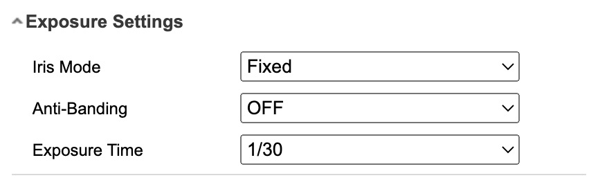

The "Gain" settings are completely gone now (which used to let me fine-tune the image for the night environment):
Gain is still there but as always it's only available in 'Day' mode:
Config > Image > Display > Day/Night Switch - Change Auto to Day
Config > Image > Display > Exposure Settings - Adjust Gain as required
The older cameras (certainly the G1 hardware models) always defaulted to Day so that the Gain setting was visible.
