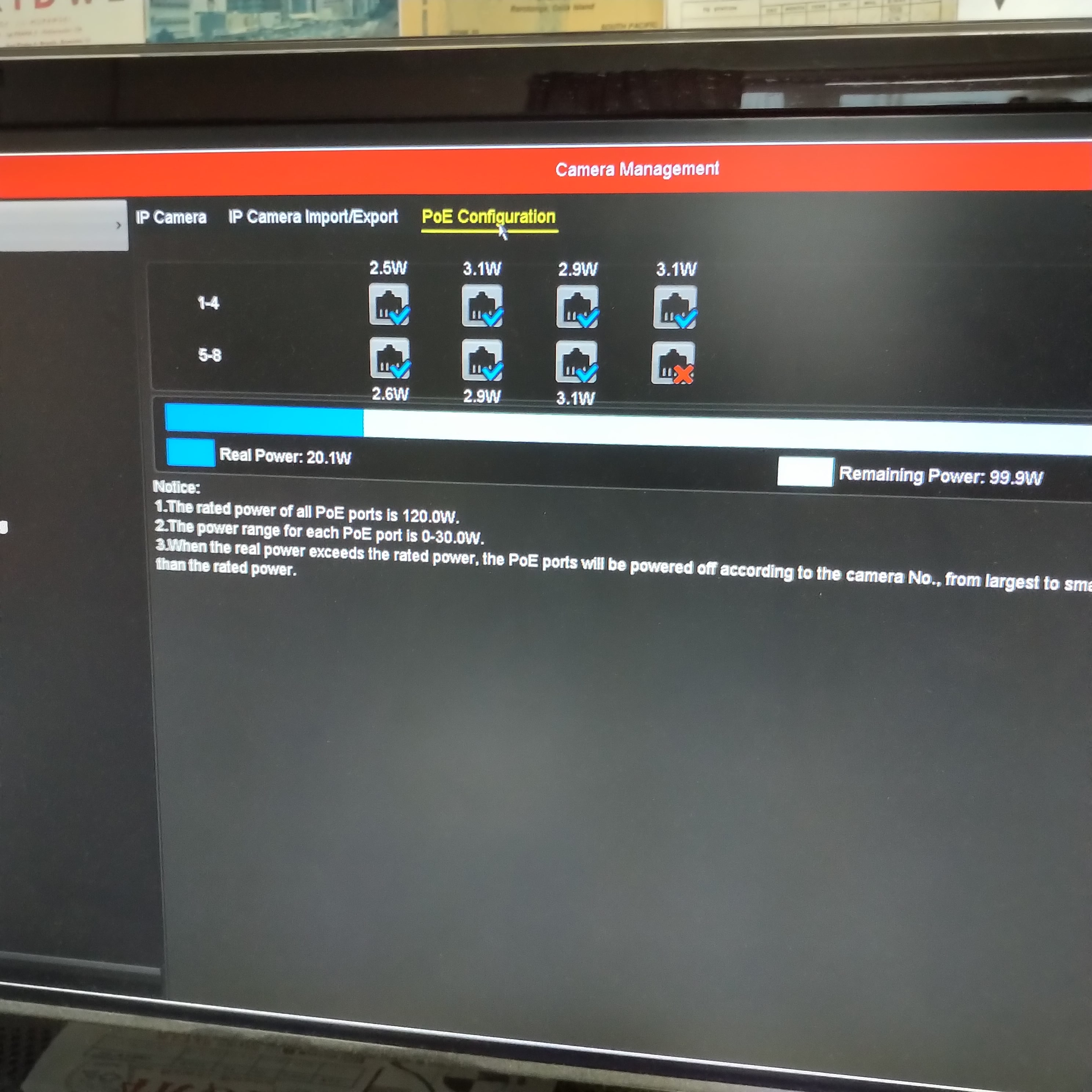

I wonder if I am alone with this problem or if others are have the same problem , From past experience when they do a firmware update and you dont update they turn off my number 7 camera and you need to restart your system again .However when you have updated your Camera and NVR firmware all is well again .This time however they are still turning off my number 7 camera .
Here is a log over the past month : -
Off 09:15 PM 03.06.2020
Off 11:45 AM 23.06.2020
Off 11:50 AM 25.06.2020
Off 14:50 AM 25.06.2020
Off 03:00 AM 04.07.2020
Off 11:00 PM 06.07.2020
Off 03:00 AM 13.07.2020
Off 10:00 PM 13.07.2020
Off 10:15 PM 13.07.2020
Off 10:45 PM 13.07.2020
Off 14:27 PM 14.07.2020
NVR Firmware is V3.4.103 Build 181226 NVR is DS-7608NI-E2/8P/A
Cameras firmware V5.5.82 Build 190220 Cameras are DS-2CD2742FWD-I
As far as I know firmware is all up to date . I have changed out number 7 camera and it still gets turned off ? If I pull the plug from the router every thing is fine so what ever it is coming from the internet and the only people that have the password is HIKVISION .
Even as I write this email its been turned off again ?
Any thoughts from anyone am I alone with this problem or maybe its just me . I fully understand that the DS-2CD2742FWD-I is a old camera and I dont think they support it any more but does this mean I need to change out my cameras every 6 years .
Many Thanks .
