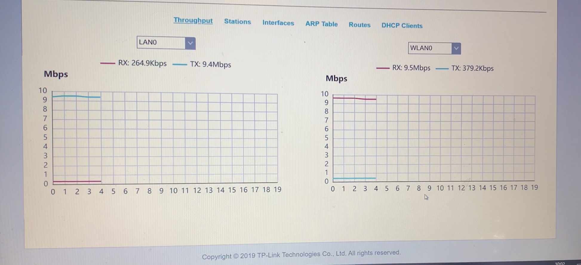

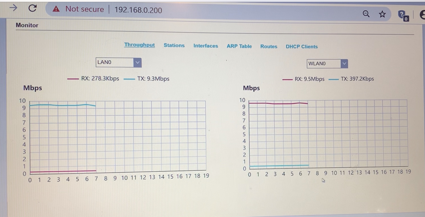

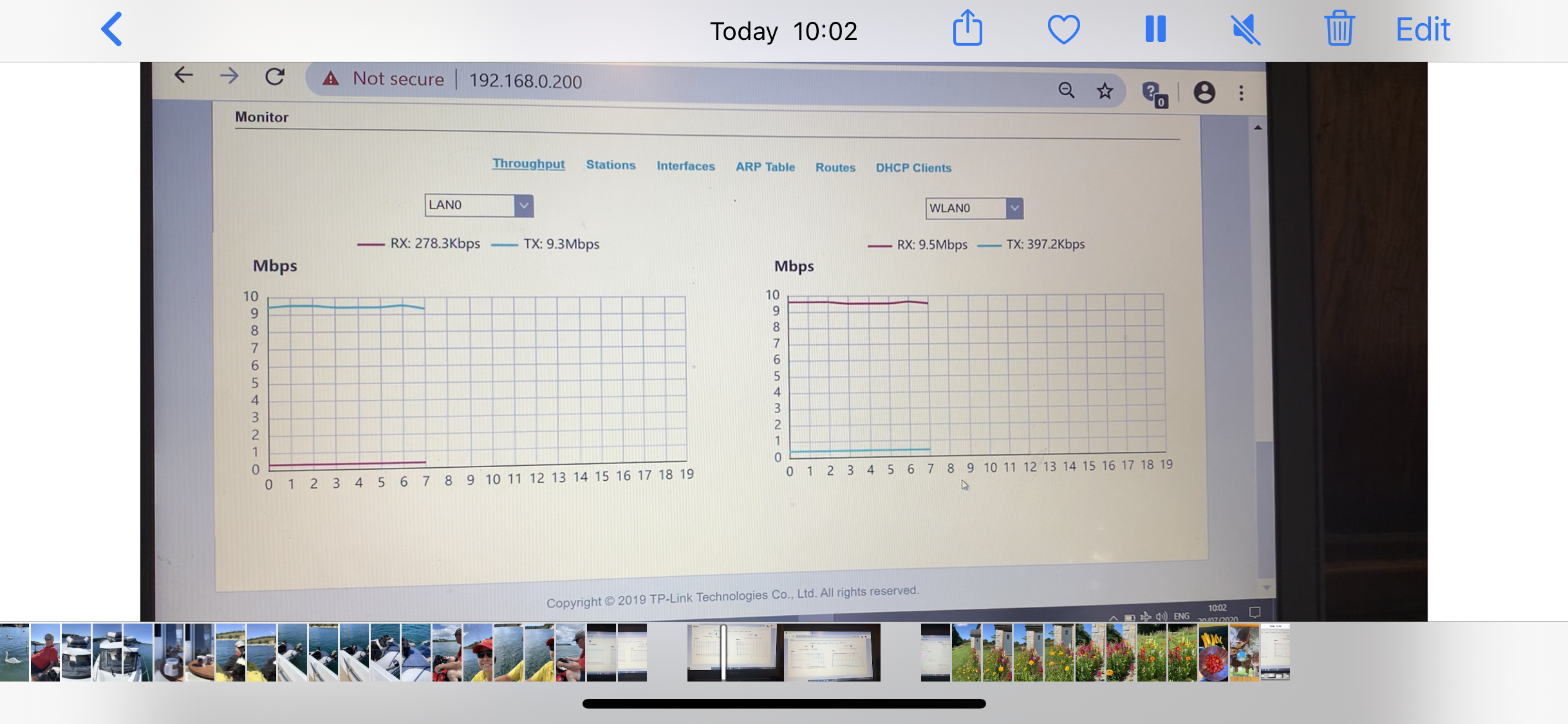

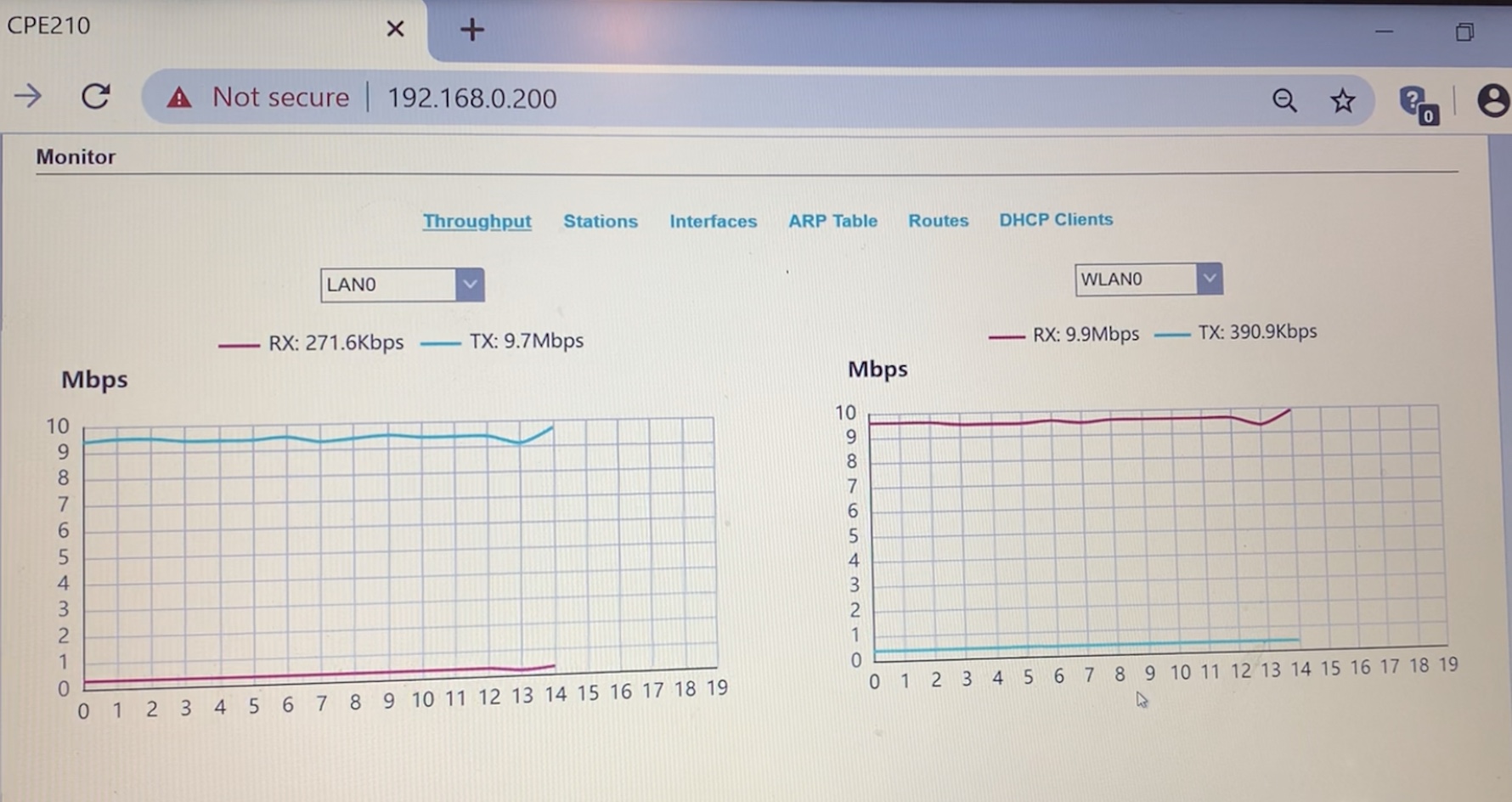

I did record the status page for the TPLink for your suggested 60secs - however I'm not going to upload the video as it is 70mb and will cripple my broadband for the foreseeable future...... (the joys of rural broadband 'service') However I attach a couple of screen shots - AFAI can tell it suggests a stable connection, but I admit to very basic knowledge re Access Point workings.

Antenna LoS is uninterrupted, there are some trees on the periphery, but no buildings or other structures. Certainly when monitoring the TPLink stats over time there doesn't seem to be any wavering of the signal to point towards signal interference.
I take what you are saying about some of the 300Mbps being taken up by the link management system usage, but it appears that the user payload draw from the cameras is 20Mbps at most - and what is being transmitted from the remote station is getting received at the base station without significant data drop.

20Mbps is not a lot. Have you checked the latency (buffering) across the radio link? As the radio link data load increases latency may increase and give you playback problems. Ping will give you an indication of latency but bear in mind that ICMP packets are low network priority and may be dropped by error correction.

I think the TPLink statistics you see are after error correction, video playback will be sensitive to any buffering delay during error correction. I've fixed quite a few wireless bridges that have this problem.
