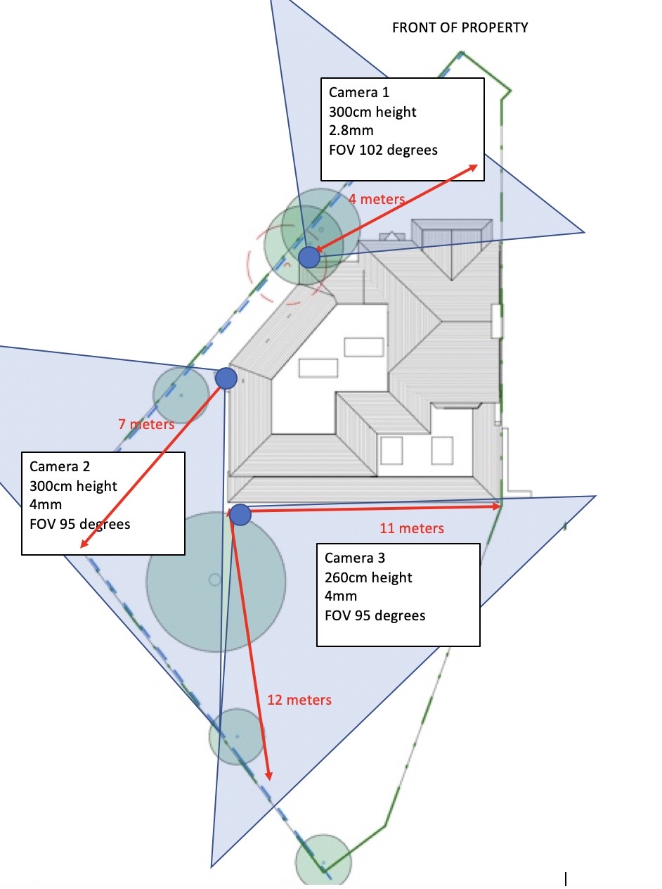

I purchased 3 CCTVs originally spec'd as 1x2.8mm and 2x4mm but the vendor sent me 3x2.8mm by mistake. These are 2347G2 units. The shop can replace 2 units as they are still sealed with the 4mm that I had originally requested.
Can you please take a look at my plan and see if you agree with my proposal? (i.e. 1x2.8mm at the front and 2x4mm at the side and back). I cannot change the location of the cameras sorry. I used the focal length calculator linked in the sticky on this forum, very useful. Ideally 2x6mm at the back would be even better but I cannot do that as the number and location of the cameras is fixed.
