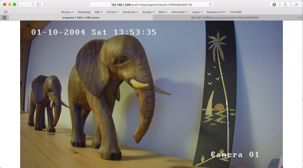

I tried this with one DS-2CD2022F-IW with a slightly obsolete firmware. It logged in fluently with my rogue davinci wi-fi test network. Then it was very easy to use the previously reported backdoor and bypass all authentication and take e.g. this snapshot. Upgrading to the latest available firmware V5.4.5 closes the backdoor but leaves this wi-fi issue open.

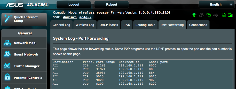

Additionally, the other default settings include UPnP ON and depending on the router settings this can open the access from outside.
