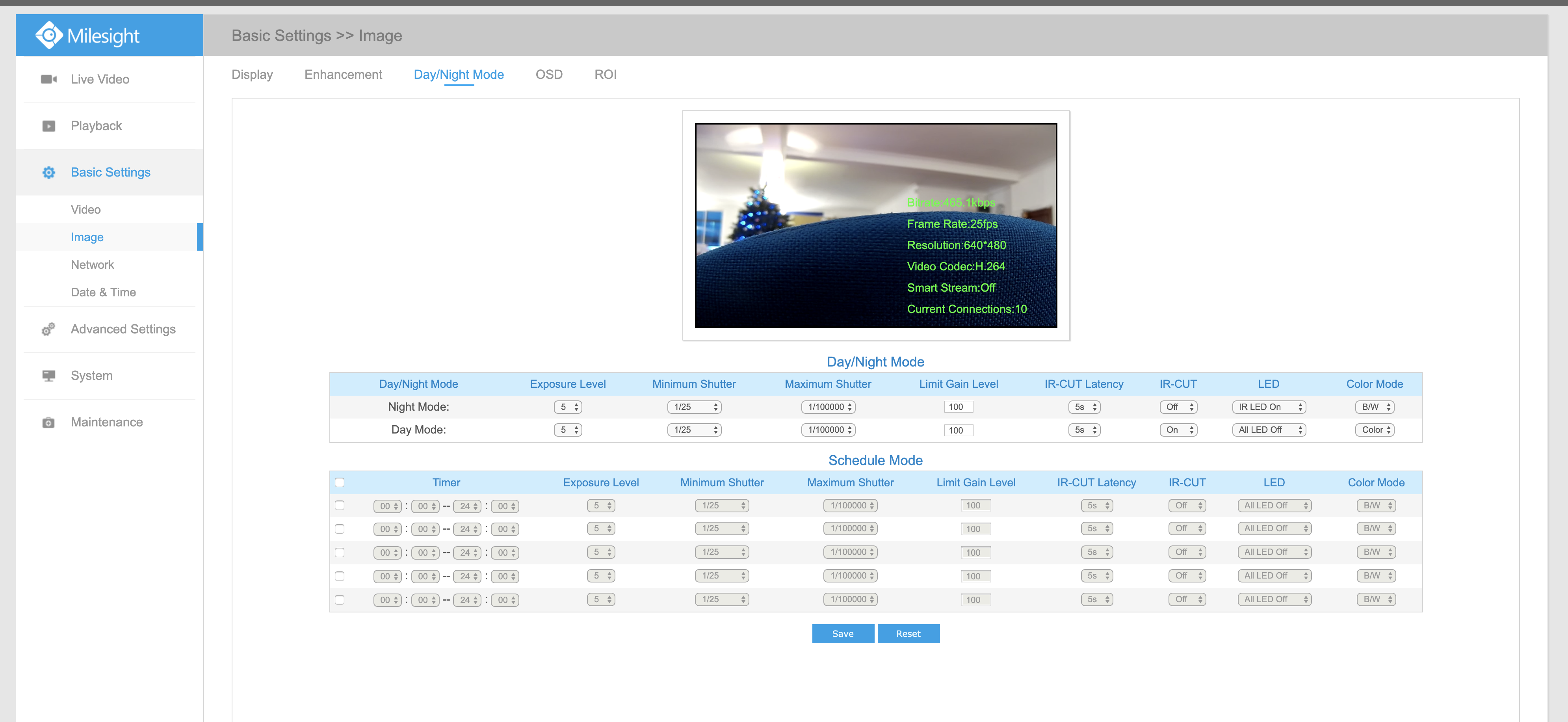

The feature you are after is actually rarely found in the software of any IP manufacturer, one of the rare examples of a brand that does support this level of control is Milesight (see below screenshot) who give very detailed control over the day and night image settings, whether they are set to switch automatic or schedule.
