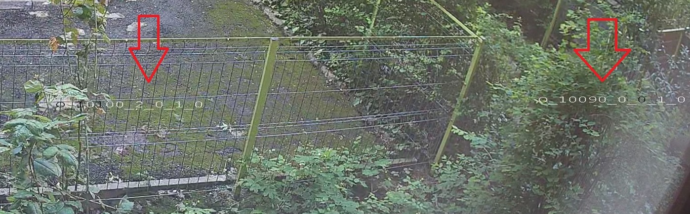

Hello!

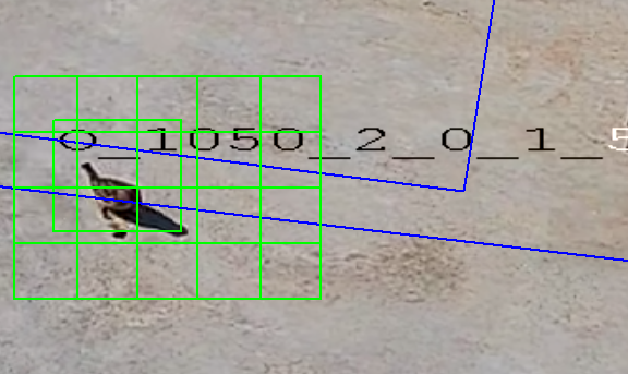

Today I did a firmware update on a ColorVu camera and now strange codes appear on recordings and when I watch live in areas where it detects motion, even the movement of leaves.
Have you seen anything like this before?

Me too. Just watched on a house sparrow in my roof :) :)

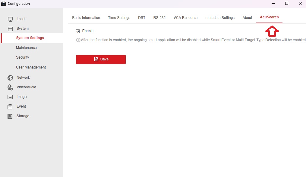

Yes, in the menu after the update, another tab appeared, I will uncheck it to see if it does the same. I sent an email to hikvision, maybe they have a solution, I'm already thinking about downgrading the firmware

This is a feature(Accusearch) also added in my NXI-K2, I think since firmware 4.82 but doesn't work. Possibly because of missing the above feature(tab) that you mention on Accusense cameras. Accusearch on NXI-K2 finds no similarities and all Accusense cameras are fade, selected, but cannot be unselected.
I went back to 5.7.14 but I might re-install this new 5.7.15 240411 to check. Can someone corfirm if that tab for Acusearch existed on previous 5.7.15 240201 ??

My G5s are still on 5.7.15_240201 (I hadn't realised there was another build until reading this) I'v just checked and the previous 240201 version does NOT have the AcuSearch tab
I cannot understand the note: "After the function is enabled, the ongoing smart application will be disabled while Smart Event or Multi-Target-Type Detection will be enabled"
Possibly my English is not so good. Can someone explain what is the "ongoing smart application"?

It's difficult to say without trying it. It could be the 'Smart Event' option in metadata settings tab perhaps? (that's not normally used anyway)

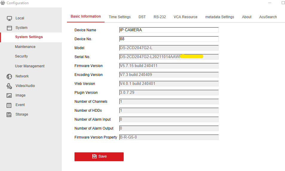

This is the basic info for new firmware:

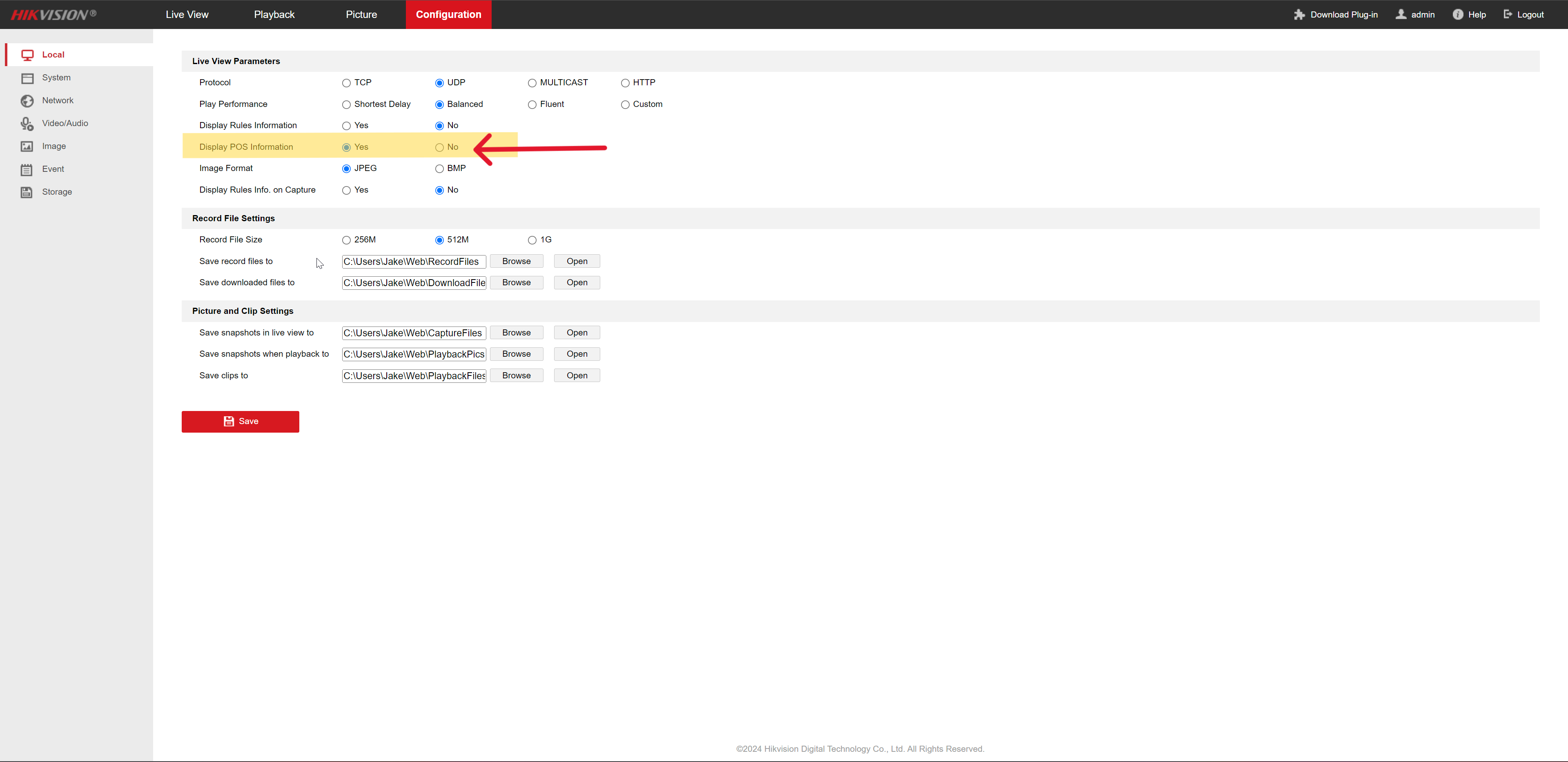

For this issue, could I get you to check whether you have the below setting set to 'disabled' or 'no', if not does the code disappear after disabling this, please?
You can find this setting by selecting the Local Tab when in Configuration in a web browser.
Yes it's selected by default on both, hybrid and G2L. I'll deselect and inform you.
But I do not remember if it was previously also set so on 5.7.14 and 5.7.15 240201 by default. I did not enable either previous firmwares or new one.
