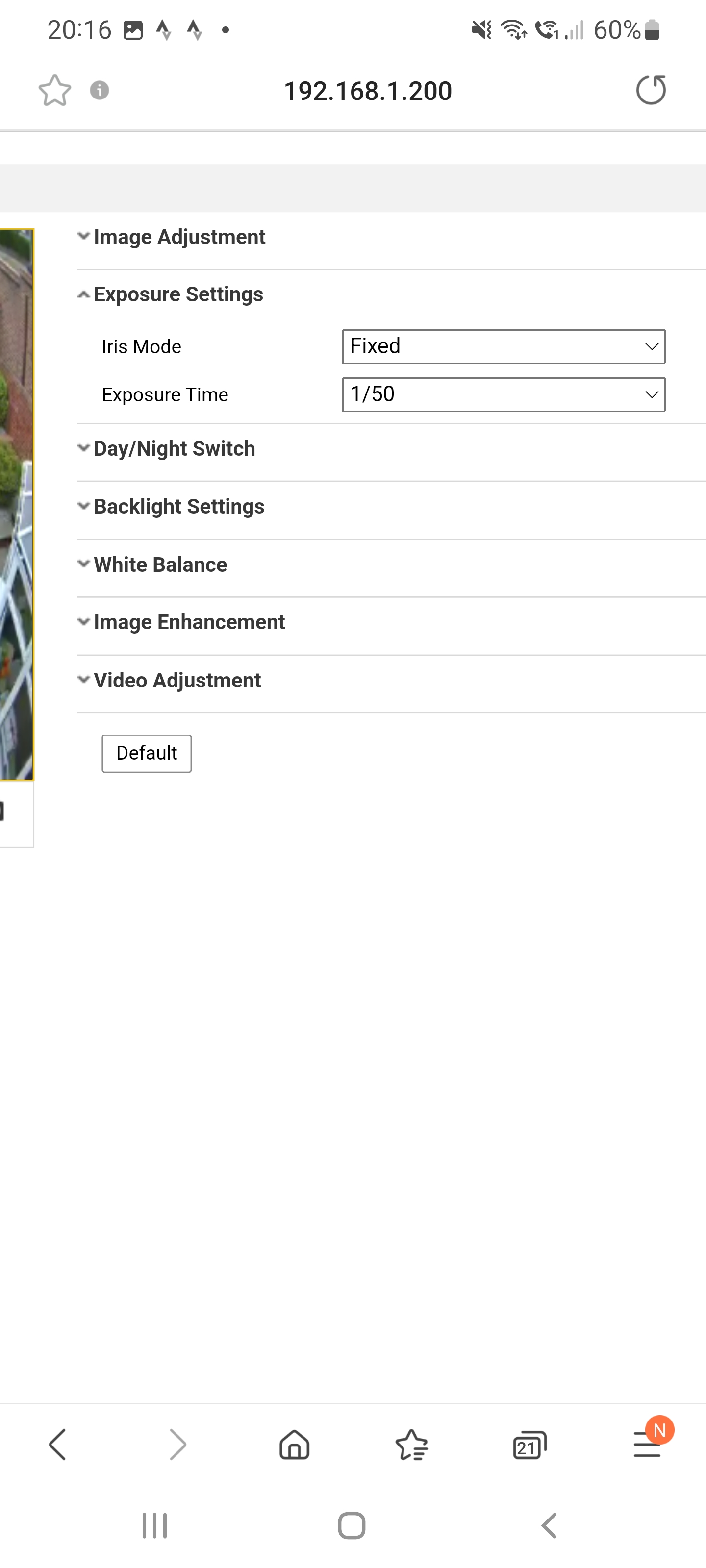

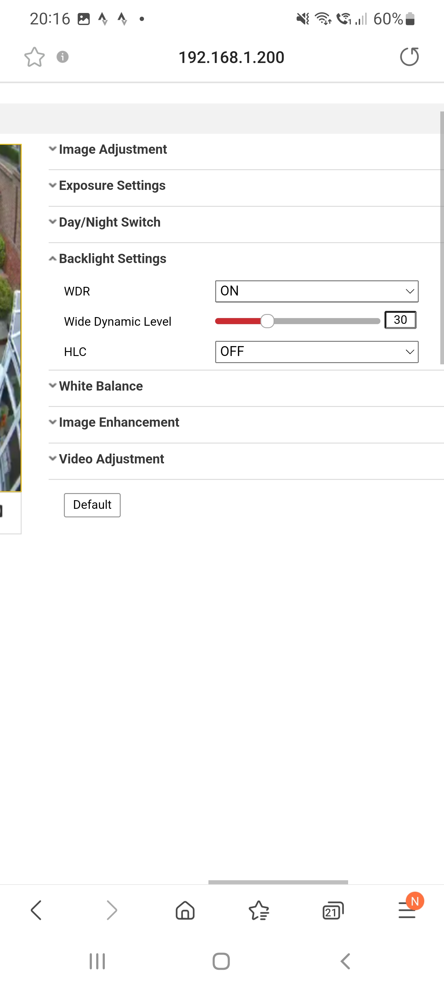

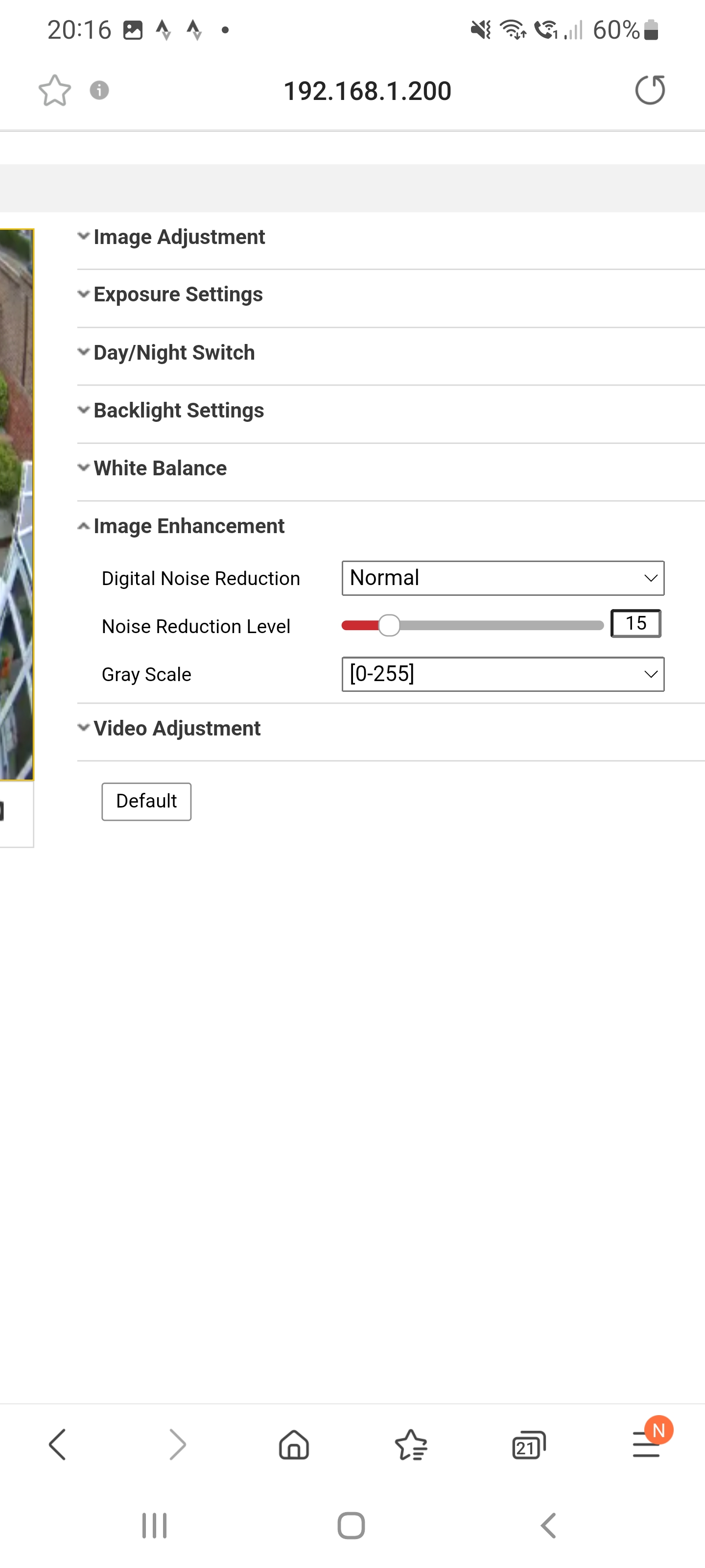

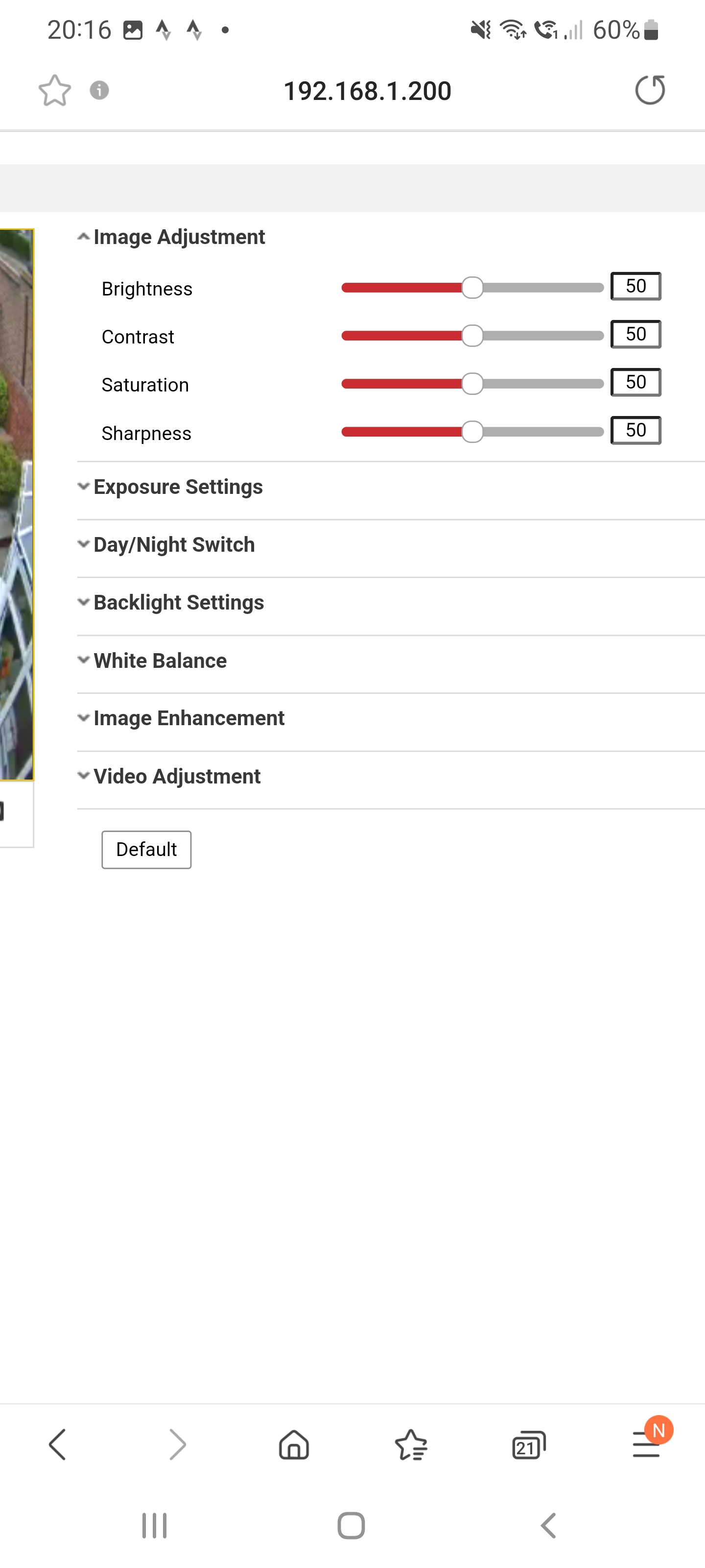

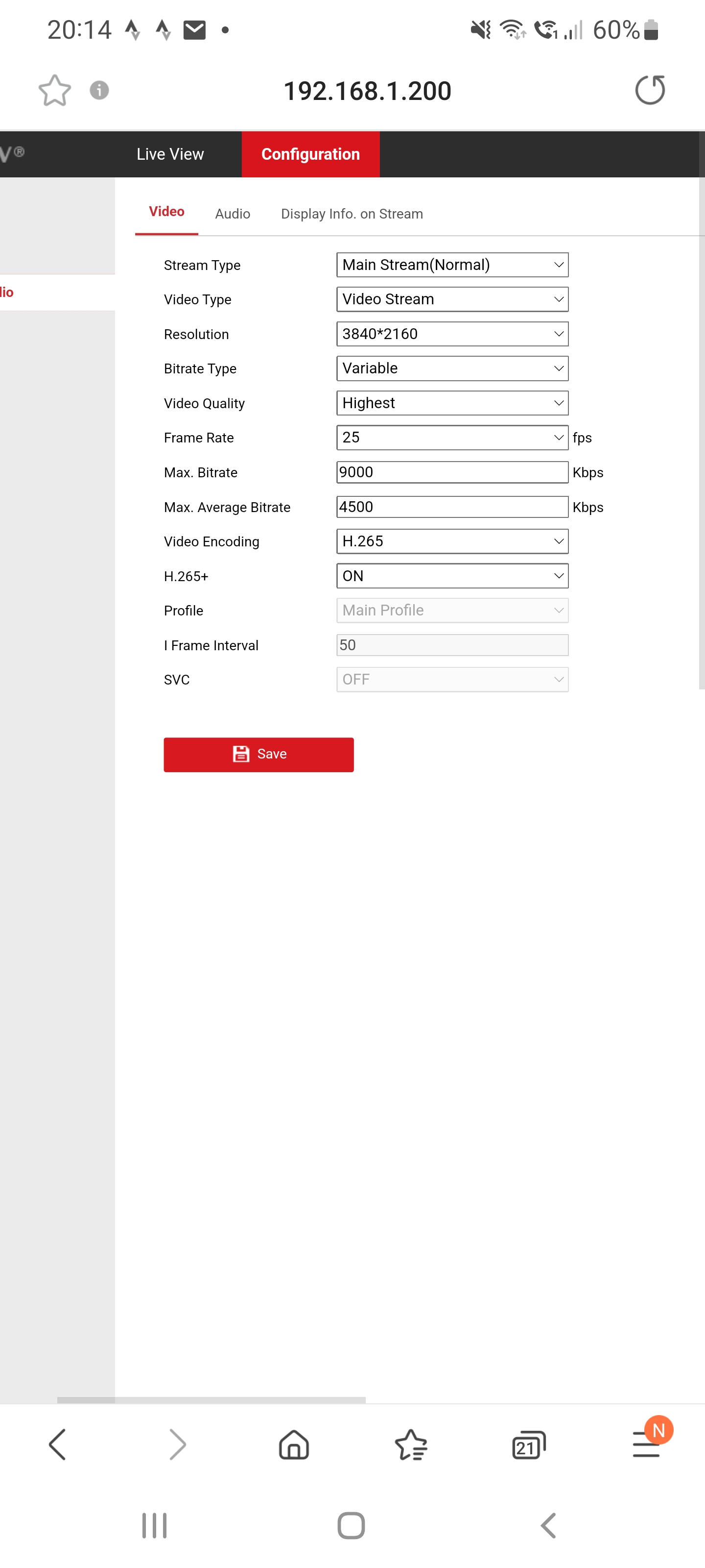

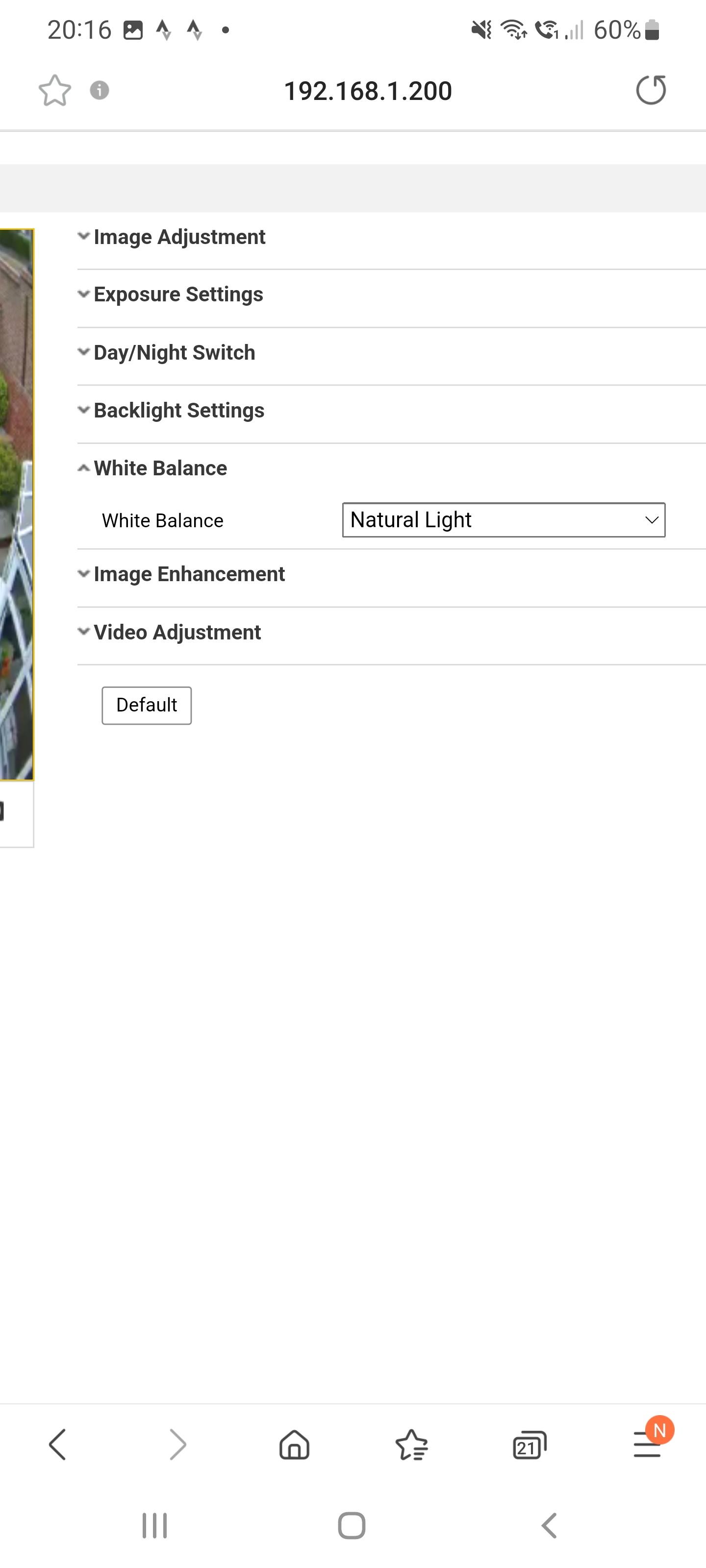

Hi I have a hikvision ds2cd2386g2 iu (c) in the daytime the picture looks washed out and at night very blocky. Any help
Follow along with the video below to see how to install our site as a web app on your home screen.
Note: This feature may not be available in some browsers.
I've found that it seems to ignore the set level with Auto. If you set it to Auto, it seems to crank up the WDR regardless of what value is set or whether it is needed. If you don't need WDR switch it off and just drop the contrast by about 5 to lighten the shadows. If you think you do need WDR try it on Manual at 5 rather than Auto.Wdr auto 30 had it on and 30 and off still no change. I will put setting up later
It may be fine but I'm not a fan of it myself. I occasionally would see ghost/repeat images and people appearing to have 2 heads (though the latter is not uncommon in Middlesbrough!)ok thanks i will try that i have 7 g1 cameras and have h265+ not got a problem with them just this new one
