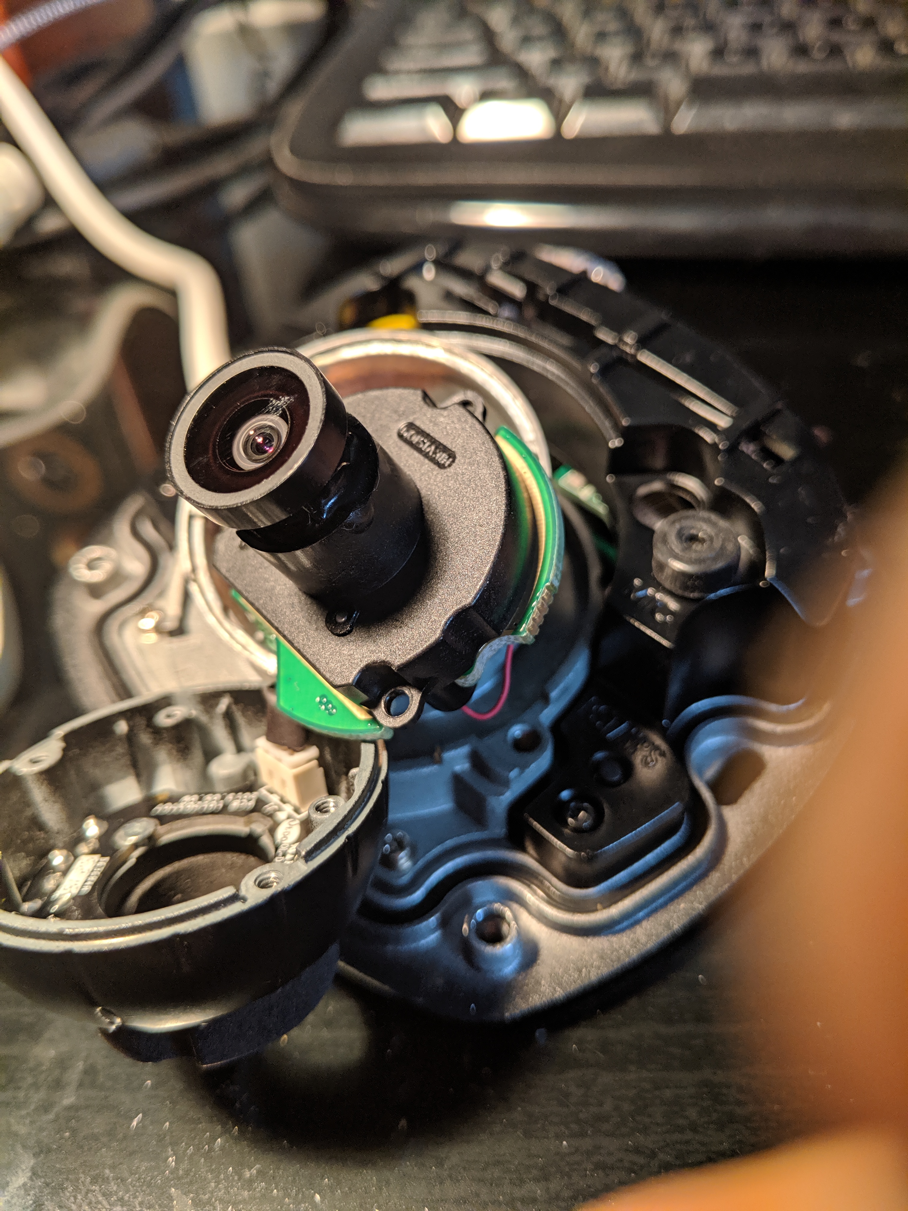

I am attaching a picture of the filter in question, that is installed with screws on the electronic base and glued to the lens, so it as the 12mm thread. It is marked as Hikvision.
