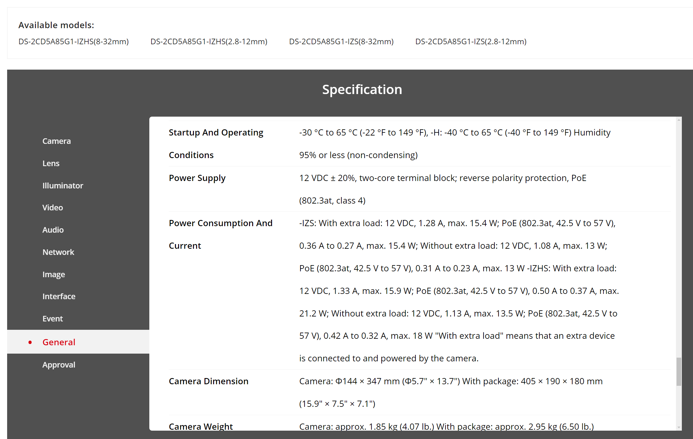

Also, make sure that you are providing sufficient power for these cameras:
(if your NVR is powering many cameras, it may struggle)
