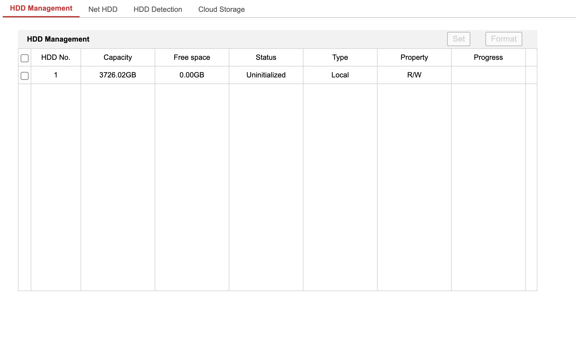

Recently I've been getting random beeps every 2 mins or so from the NVR. Upon further investigation it says there is a disk exception:
This is what the status of the HDD shows:
When I try to format it, it fails and says Error in the Status column.

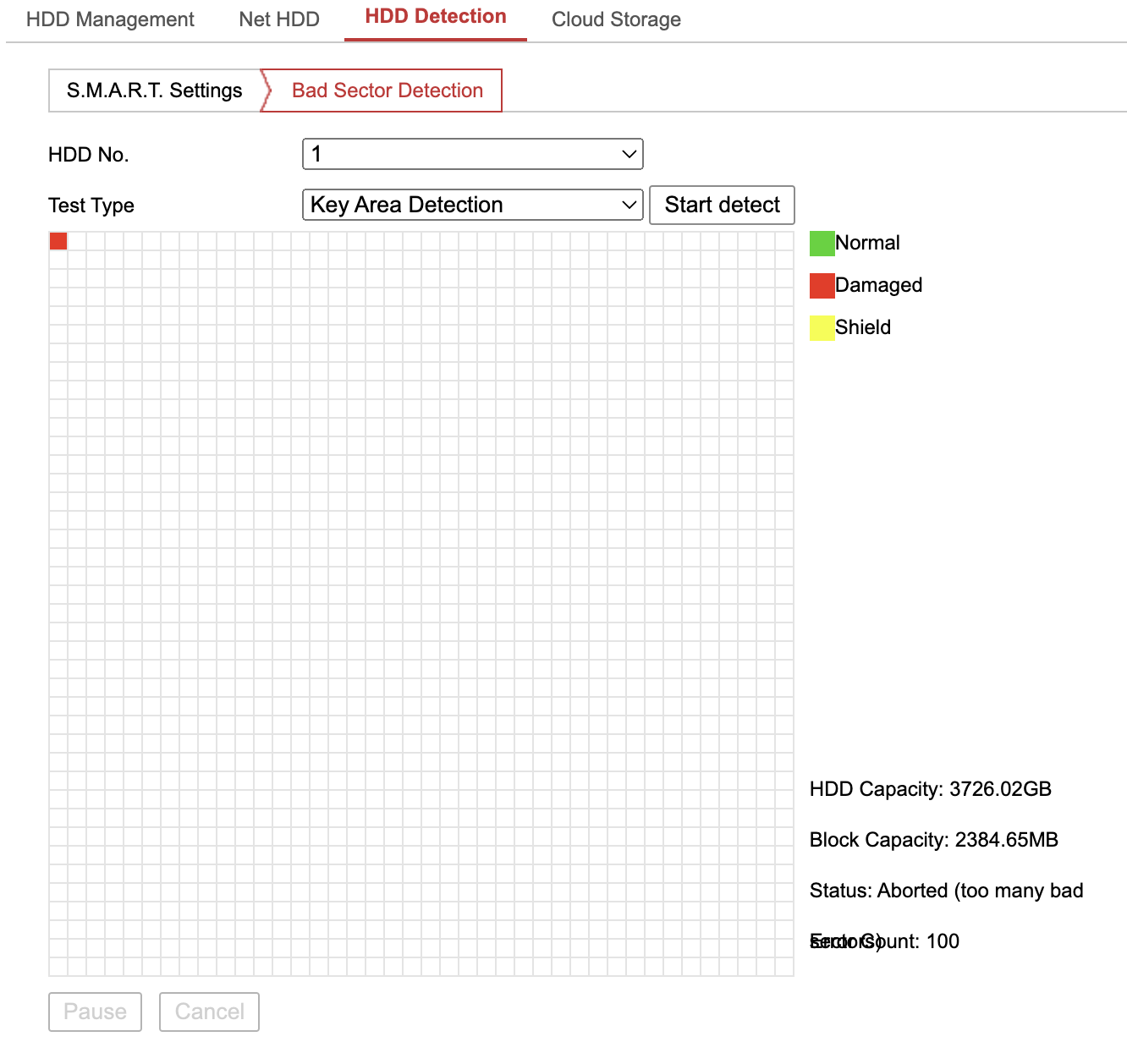

and when I go to bad sector detection, this is what it shows:
It reads:
HDD Capacity: 3726.02GB
Block Capacity: 2384.65MB
Status: Aborted (too many bad sectors)
Error Count: 100
Does this confirm that the HDD is busted and needs to be replaced?

Hey all
View attachment 12530It reads:
Error Count: 100
Please let me know, thanks!

Yes it needs replacing. Power down, switch it out and once powered up format the new one from that page.
