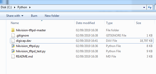

Please can someone in the know offer a Newbie some assistance, I've been onto HikVision and downloaded the latest K71 firmware for my device and proceeded to upgrade the firmware, this appeared to go okay and offered to reboot which was duly completed and from there I don't get any screen output at all. I do see the red HikVision splash screen upon boot but nothing else.
I've setup my computers IP to 192.0.0.128 and I can ping the 7208 on 192.0.0.64 but cant login in any way, I've run a port scanner to get a list of open ports, this returns no results.
I've tried using SFTP with my latest firmware and a base version but my device does not get listed in the results / information area.
I've tried SADP - no device listed
I've tried Batch Configuration tool and scanned all IPs within 192.0.0.1 - 254 and nothing, I've tried also scanning 192.0.0.64 ports 1 - 9999 and again nothing.
My device does not have a RS232 port on so can't console on in the normal fashion.
I've also tried a web browser via http & https to the .64 IP.
