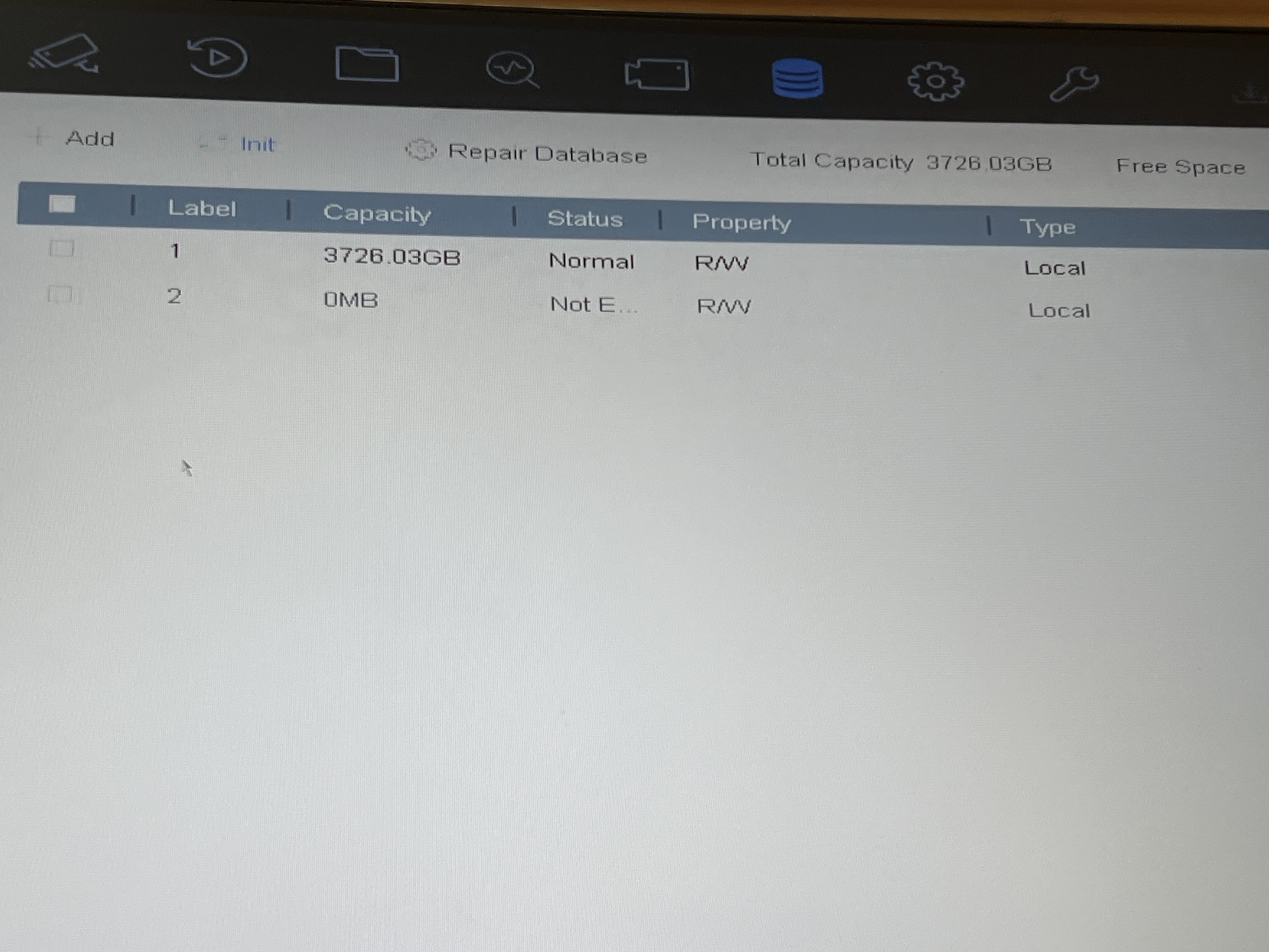

Theres no option atall , just this

No nothing happens, no option. I managed ti figure out how to disable the audio beeps so its gone off lol.
