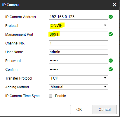

I don't have any experience with the Ctronics range so I'm guessing.
Check the Protocol/Management Port. Hikvision will use the default port of 8443 normally. It looks like Ctronics uses 8091.
The user is: admin and password:123456 for Ctronics cameras, unless you changed it. Keep us posted.
Thanks Stewart for pointing me in the right direction.
After hours and hours of trying different things I finally found out what the problem was, I think.
When I loaded the camera up in the browser there are two boxes that were not ticked. Hikvision and Dahua. I ticked then both to see if it changed anything and it allowed me to choose under plug and play, Hikvision and the NVR then saw the camera as an Hikvision using port 8000. I can now adjust the bitrate variable and the fps.
