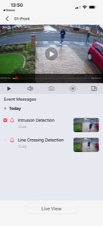

So if I'm reading this correctly, Intrusion Detection is in use and triggers but you don't get the clip beneath 'Event Messages' in the lower half of the screen beneath that cameras live view. However if you configure Motion Detection you do get the clip there when it triggers, so the issue is specifically linked to Intrusion Detection? You might have discovered a bug specific to Smart Events on that build...
One other question. Does the push notification work at all to the Hik-Connect app and it's just the video clip that's missing or is nothing received? You probably already have done this, but if not I'd have someone do a shutdown from the menu and re-power the NVR to re establish the NVRs connection with the Hik-Connect server.
The only thing that was springing to mind was the tickbox in Maintenance to 'Keep VCA Data' (or similar wording) but I think that's enabled by default if the NVR is registered with Hik-Connect. Unfortunately that setting isn't accessible from the web browser menu (I just checked), just the local menu.
I'll temporarily set up an Intrusion alarm on the NVR with that version and report back later as to whether it works for me or not (I'm heading around there for Sunday Lunch!).
I’ve just tried and everything worked normally (I’ve not upset my wife - just wanted to trigger both line crossing and intrusion detection to prove both)
