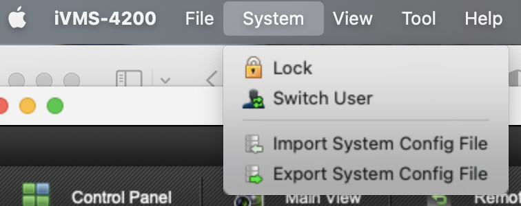

A little tip (not much use to you now unfortunately) but if you do ever need to delete/reinstall iVMS; from the toolbar at the top, export the config. Once you've installed iVMS again you can import it to get back up and running without re-adding anything:

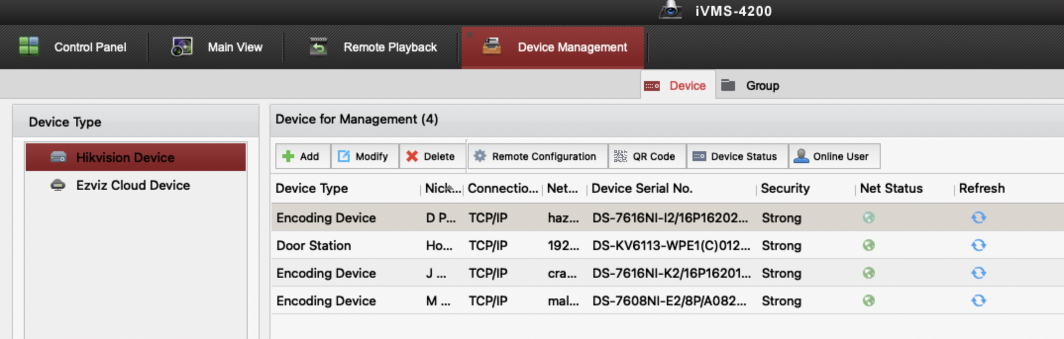

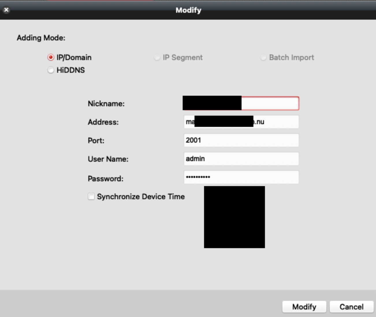

If you've added your NVR already, you should see it in 'Device Management', and if it is logged in successfully beneath 'Security' it should be showing 'Strong' and beneath 'Net Status' you should have a green light. If not - double click the line for your NVR and make sure that the admin user and password fields are correct (password will be masked), then click 'modify' to update. I can't think of anything other than incorrect NVR 'admin' user credentials that would cause an incorrect user/password error to be displayed:

Remember the SuperUser account details are only for logging into the app itself and the NVR admin password is still needed in Device Management.
