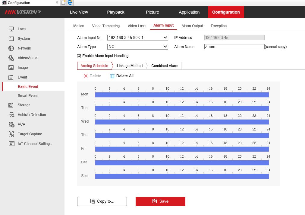

I have the Hikvision DS-7616NI-I2/16P NVR on the latest firmware, with 2 fixed bullet cameras and 3 PTZ cameras.
I have motion detect/recording set for all 5 and this is working as expected.
I am having trouble setting a trigger:
When one of the fixed cameras detects motion, I want one of the PTZ cameras go to a preset location (Preset 3 in my example)
All the cameras are capable of this as well as the NVR, I know I am just missing a setting somewhere?

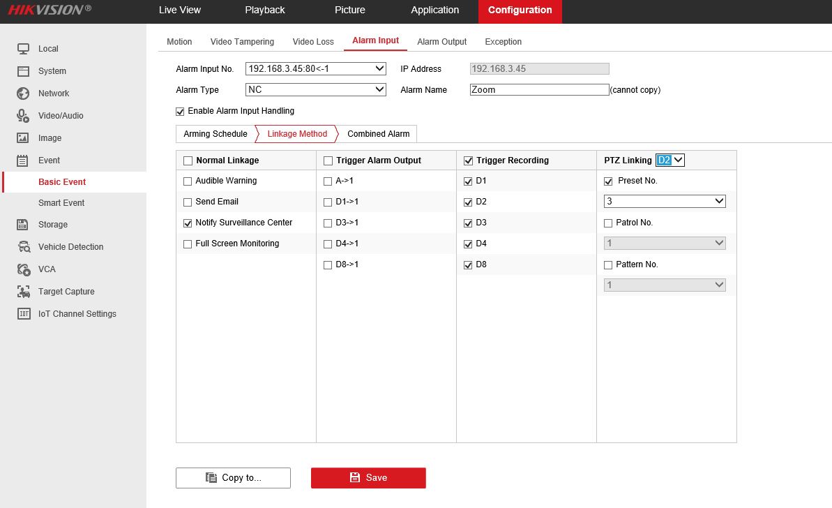

192.168.3.45 Is the fixed bullet camera or Trigger camera.
D2 is the PTZ that I want to move to Preset 3
Help a guy out please.

Yeah you're in the wrong tab. What you've set there is:
"When the physical alarm input (on wired terminal block) on the camera at 192.168.3.45 activates - send the PTZ (D2) to preset 3."
You don't want the physical alarm input as the trigger though, you want motion as the trigger... So:

EDIT: I've just checked and it's not possible to use motion detection on one camera to trigger a PTZ preset on another - there is no PTZ linking in the linkage method tab for any Basic Events. What you'll need to do is use a Smart Event on your...

  3. Click the linkage method tab and set the PTZ linking there.
EDIT: I've just checked and it's not possible to use motion detection on one camera to trigger a PTZ preset on another - there is no PTZ linking in the linkage method tab for any Basic Events. What you'll need to do is use a Smart Event on your trigger camera - this could either be intrusion detection or line crossing to replace your motion detection (or use it in addition to). All of the so called Smart Events have the PTZ linking option available in the linkage method tab - unlike the Basic Events.

I do not have those settings under motion. Only under Alarm.
Not sure you read my edit. You won’t be able to use motion but you can use line crossing/intrusion as the settings are there - though obviously you’ll need to set that up to cover the area you want to cover. As I said alarm input is for detectors that are wired to the camera or NVR so you can’t set it there because you’ve got nothing connected to those inputs.
