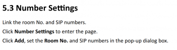

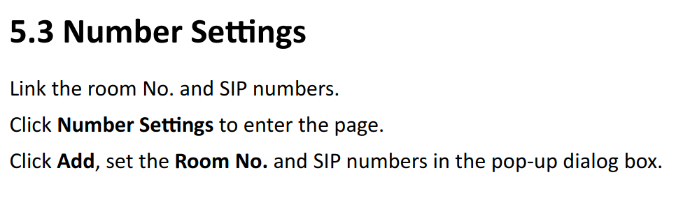

Hik documentation is very poor. It seems that you have to setup room numbers. Set # 2 to the room 1. Intercom will call to this number. I also wish it to call the next room in the list, if nobody answer the first, but it doesn't do that, so I had to setup this with asterisk.ok, i have setup my FreePBX @Roelli
i registered my indoor station fine with extension nr 1
but i am lost now? where the hell can i tell , that when someone pressed the doorbell, it also needs to call extension nr 2 ? i cant find that setting
