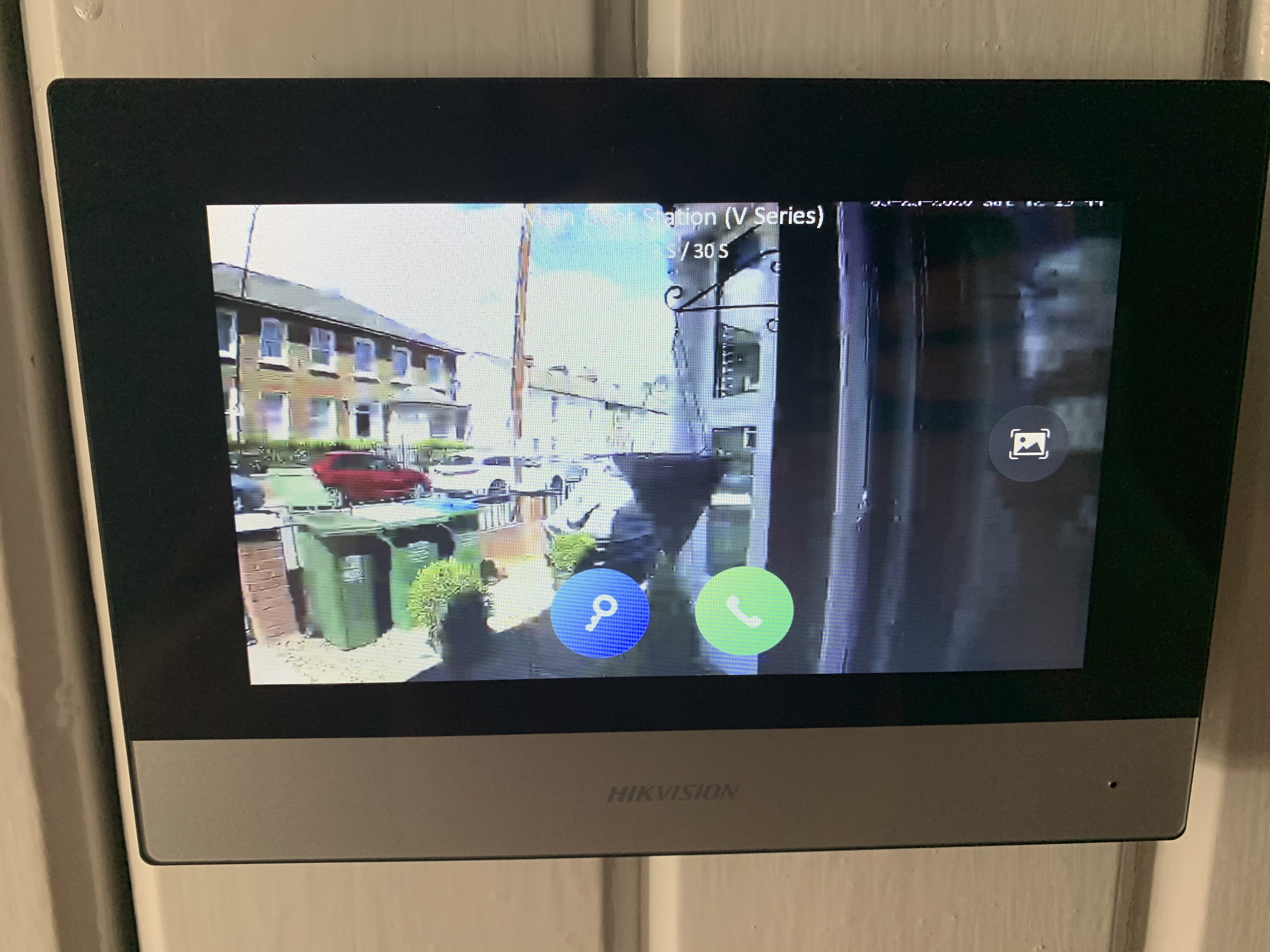

I have this indoor unit which is software version 2.1.2 200321 working with a Hikvision DS-KH6113 IP Video Intercom System on the latest software version however this is academic.

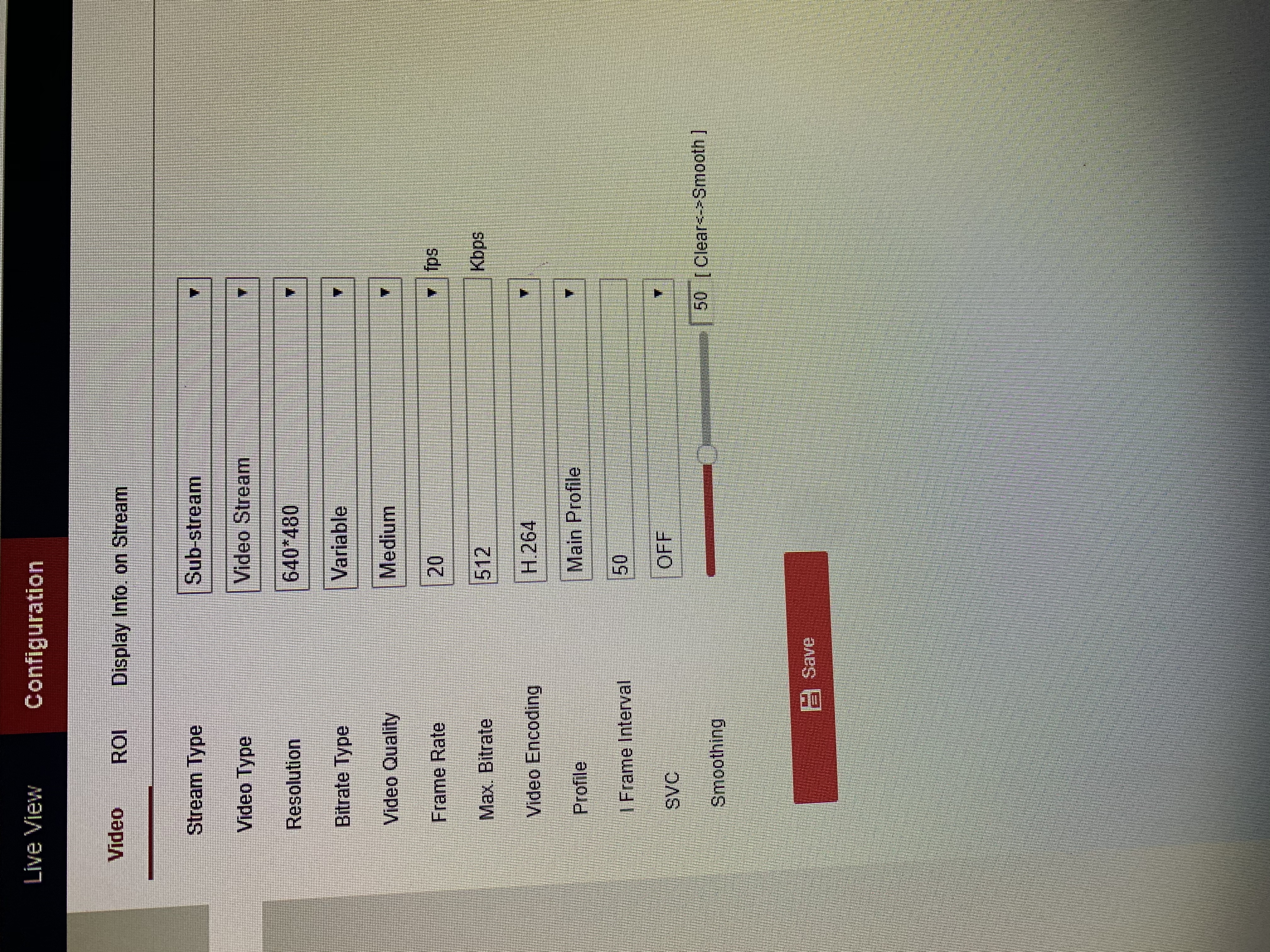

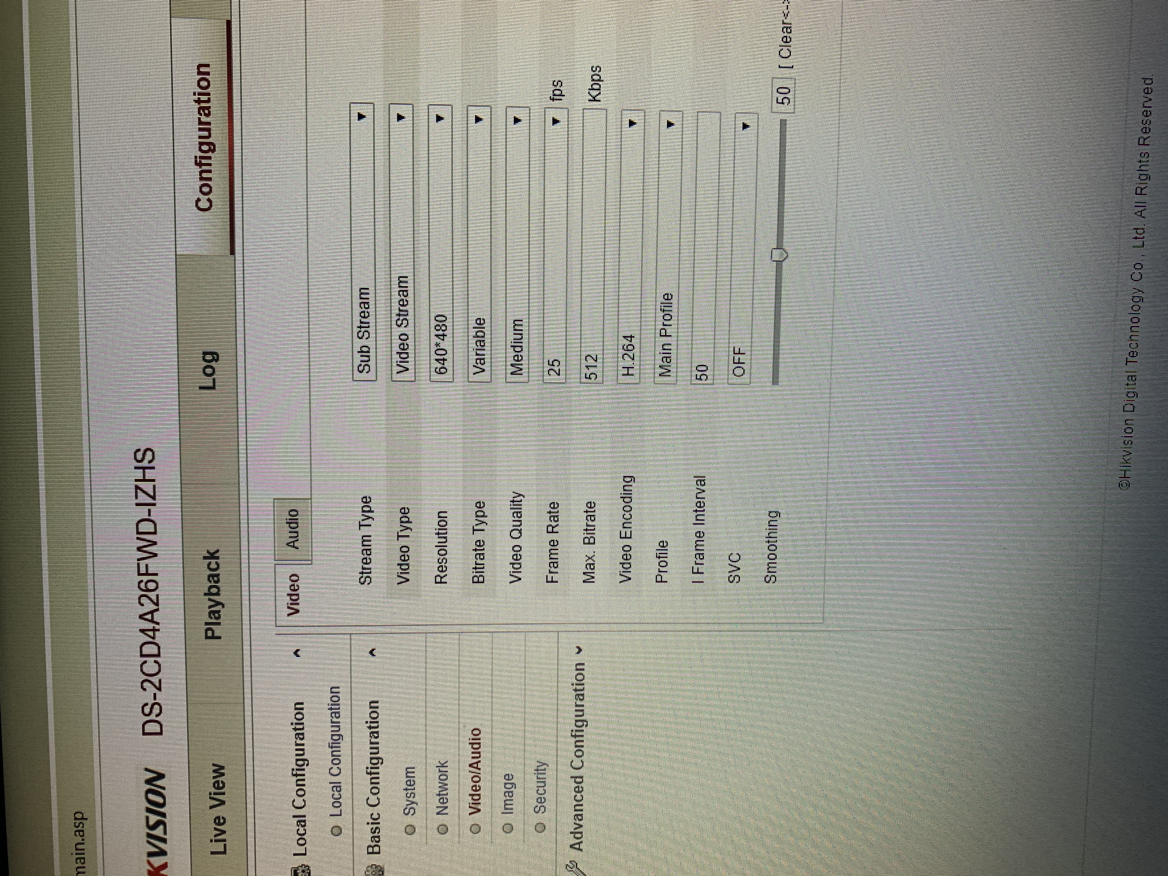

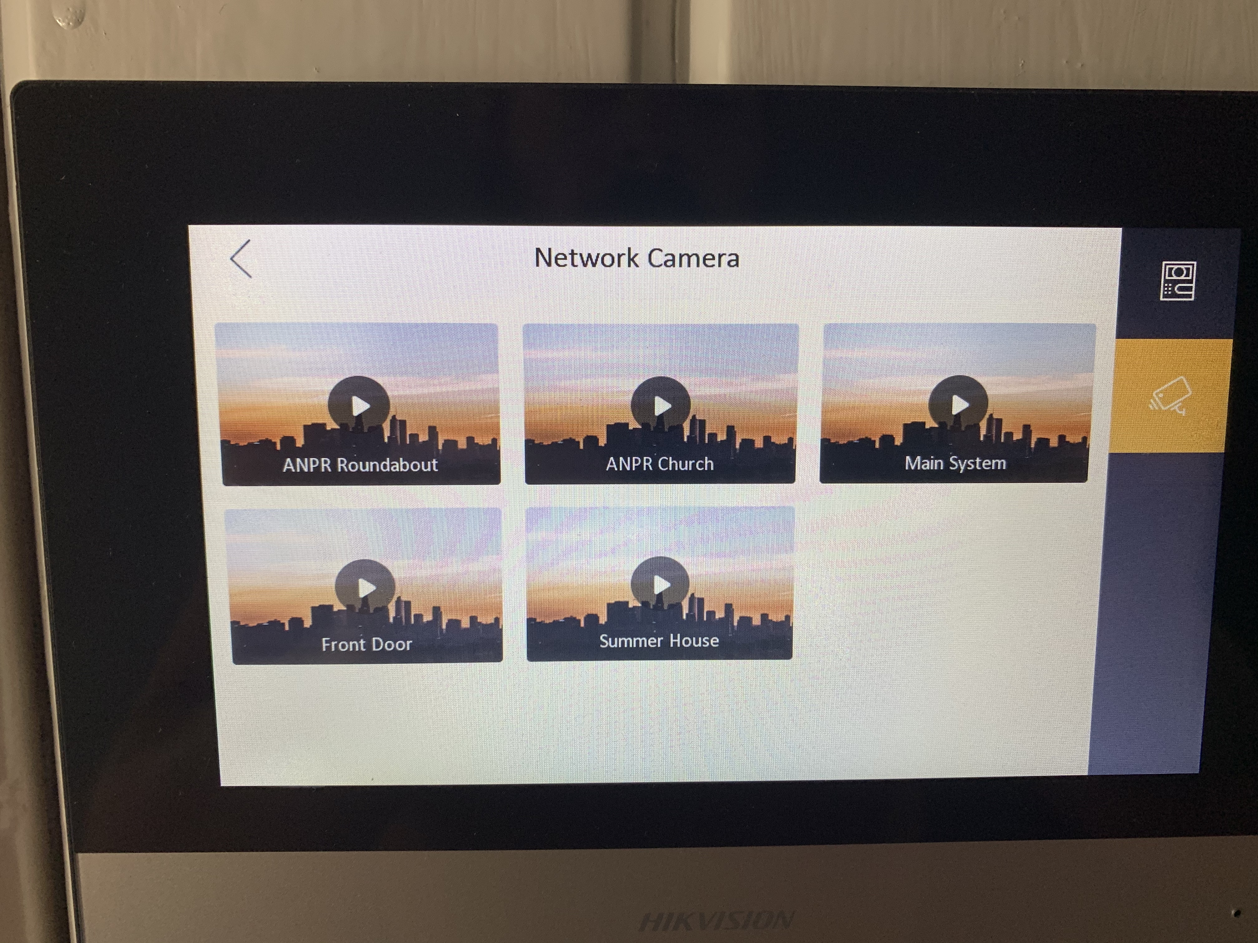

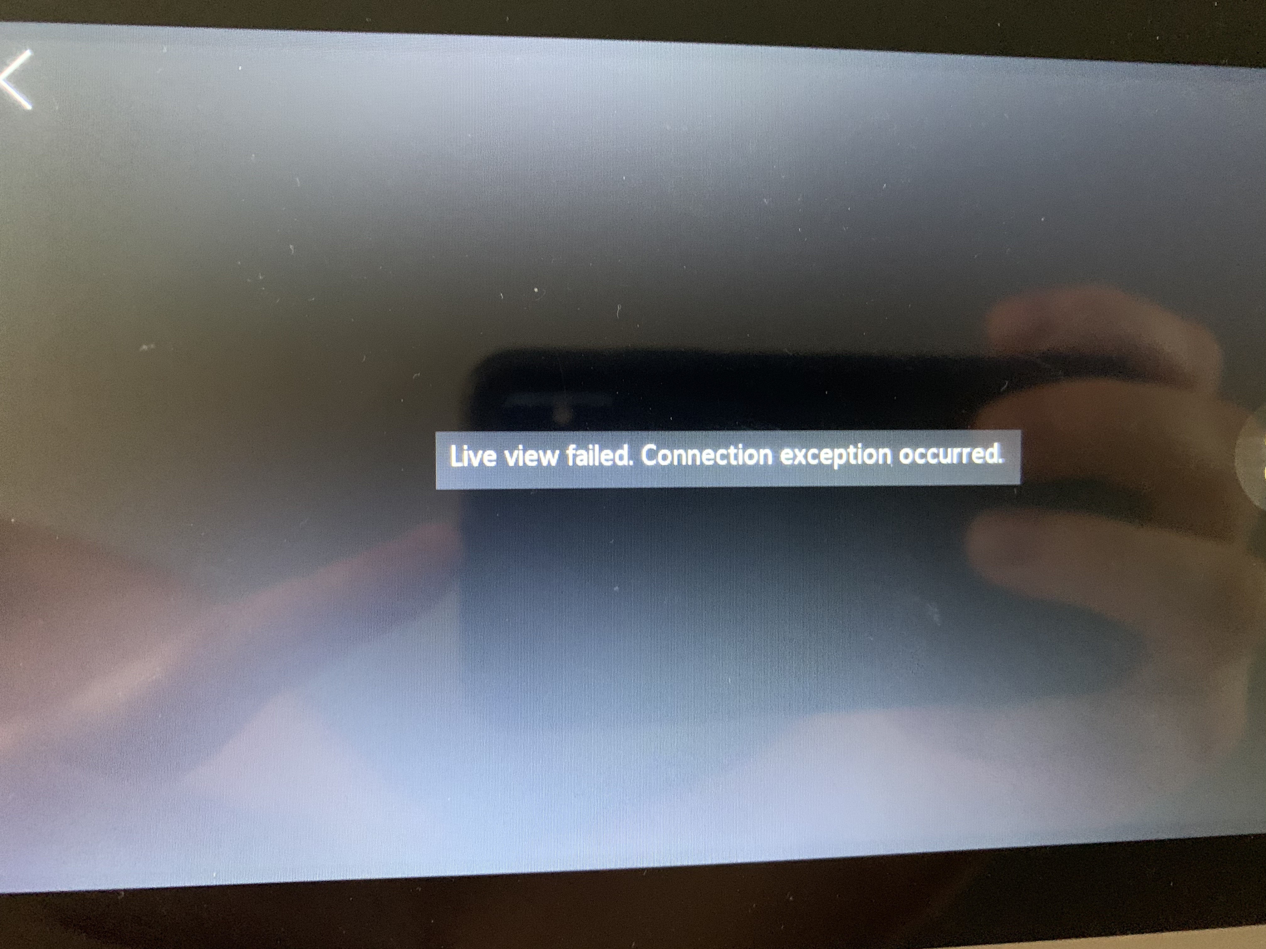

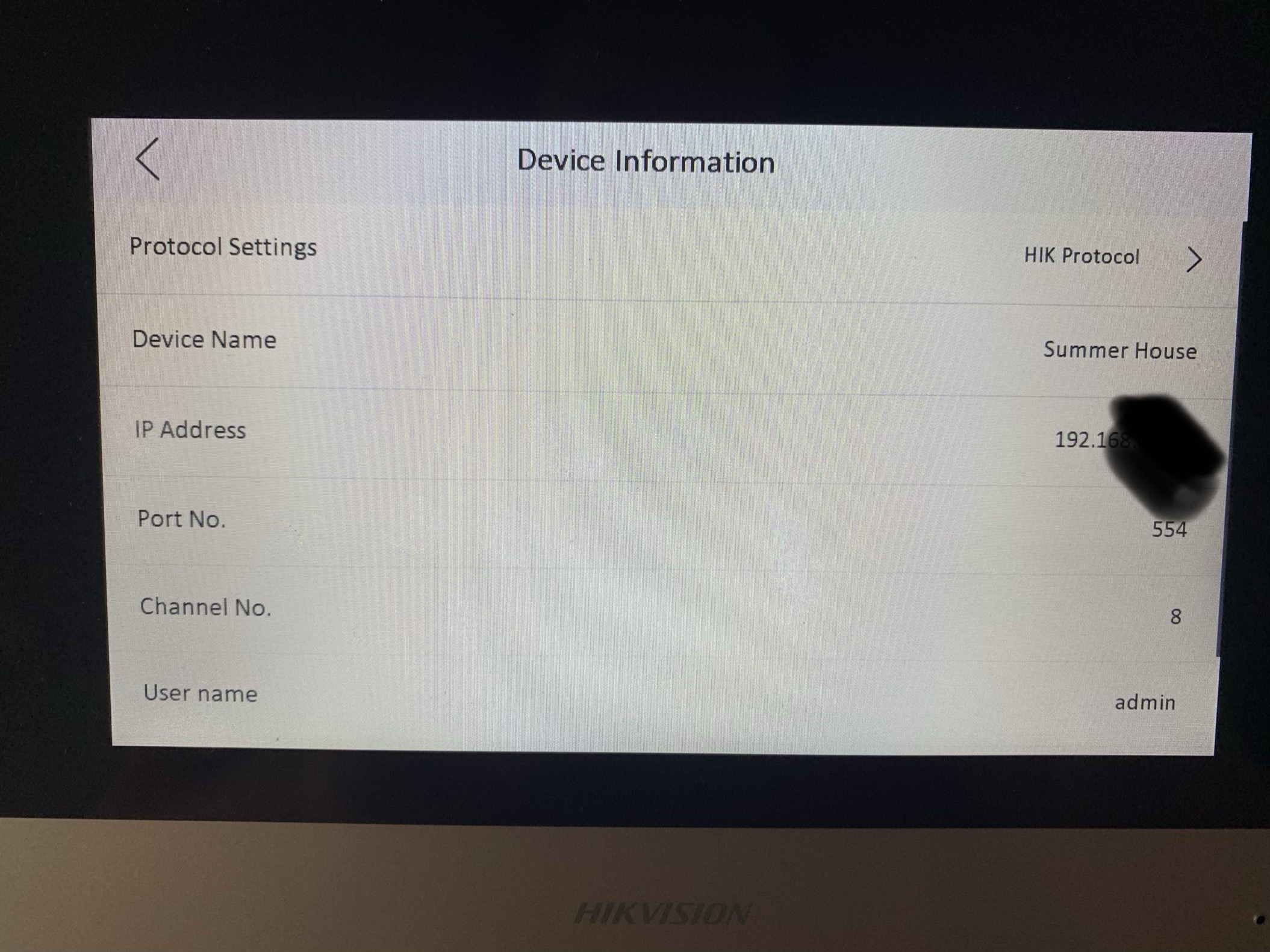

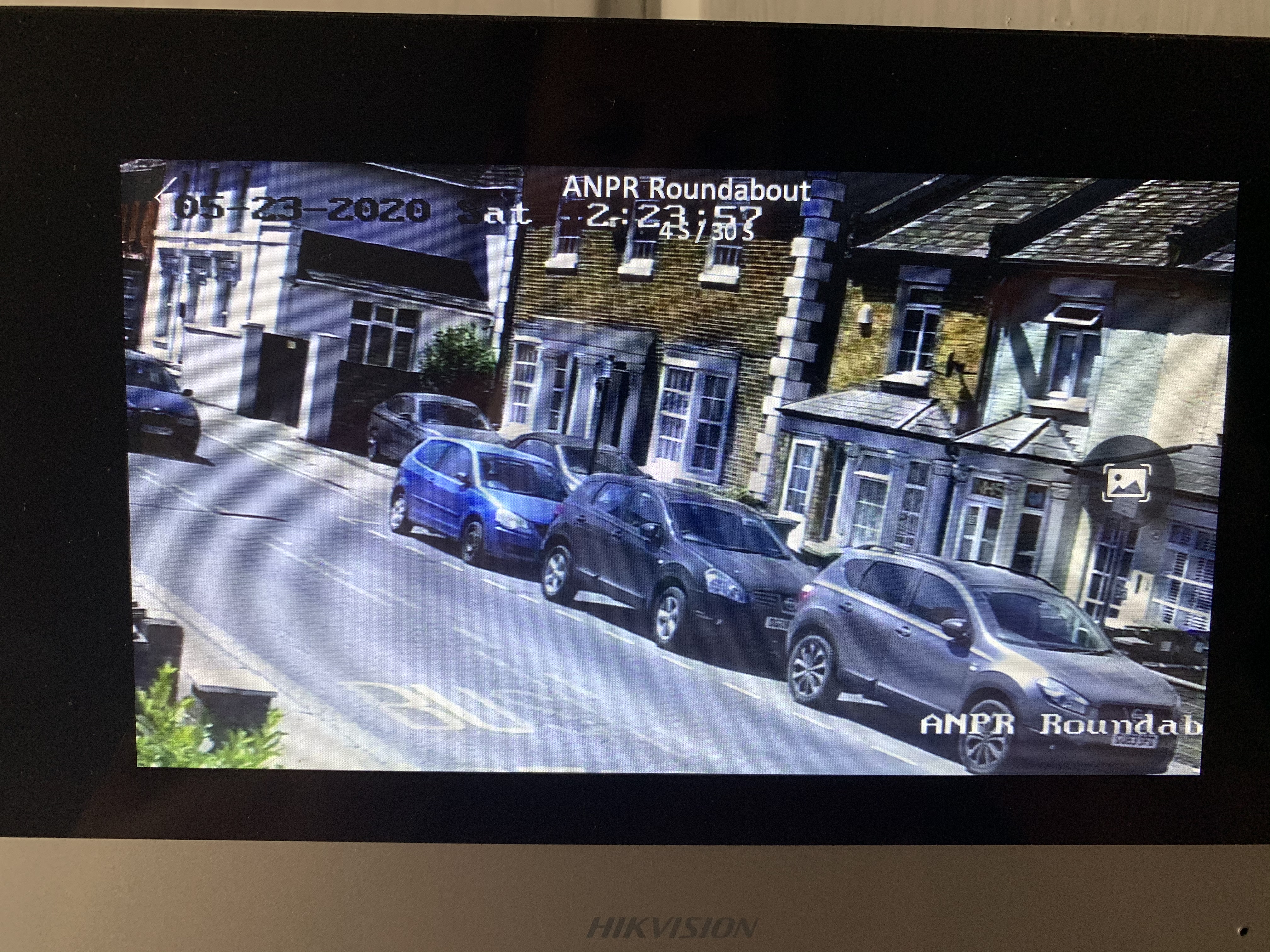

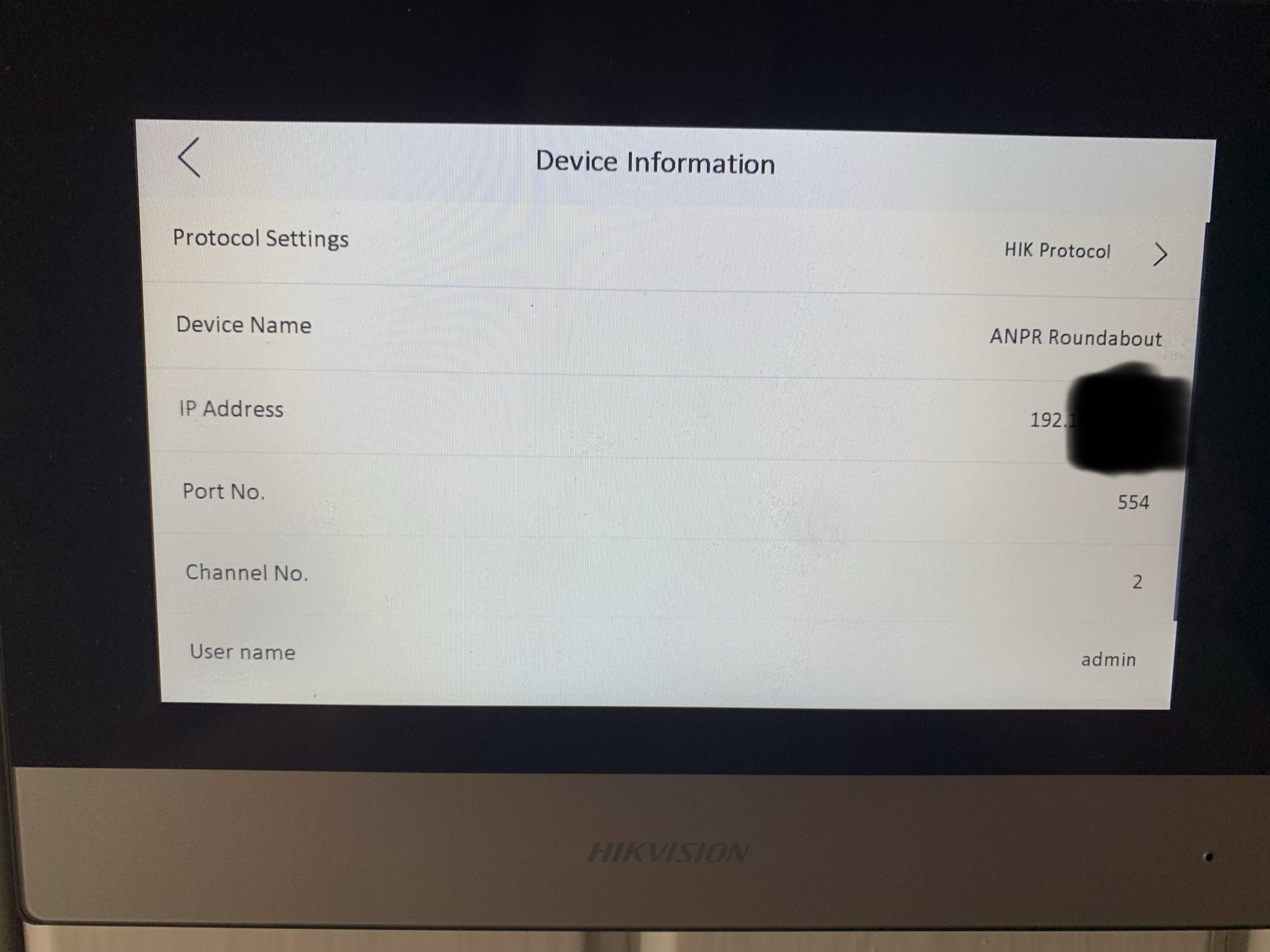

My issue is you are able to add additional camera’s to be viewed from the 6230, when I add an ANPR camera 2CD4A26FWD it works perfectly on port 554, although it’s not the camera I want to view, when I am any of my several 2CD2385FWD I get an error of network exception. I though it might be because they are set to 256+ however that is not it as I’ve tried even on 254, they are on port 554 like the other anpr camera’s but I cannot get them to work, I have also tried all other ports listed in the 2CD2385FWD setup so 80, 443, 8000, 8443 without success.
I’ve added a few photos of the intercom camera working, the anpr camera working and it’s settings screen, a 2385 camera setting screens but the exception message I get when I try and view.
