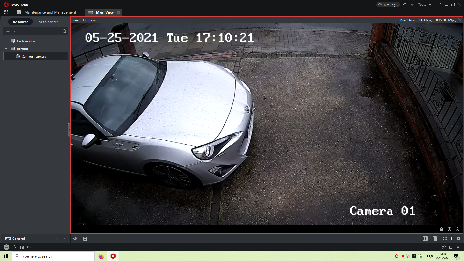

I logged in and discovered the live stream to be very dark.

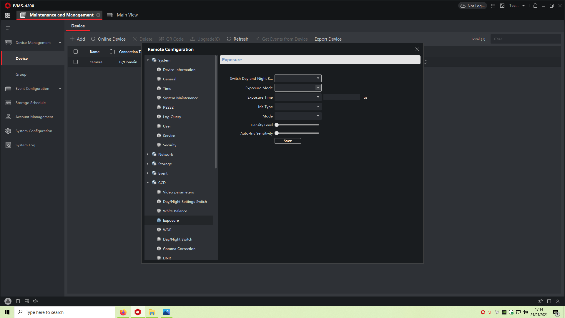

I found I am no long able to alter anything in the "CCD" menu to change the image.
I can alter resolutions, FPS etc just not anything like white balance, gamma, exposure, day/night switch. There is the menu, and all the options but nothing in the drop down menus. I also get "The start time can't be equal to end time" if I alter a slider.
I've tried uninstalling/reinstalling, rebooting the camera and resetting to factory. Nothing helps.

Hi @tubbs
Can you please share a screenshot of the darker live view image you are getting and the CCD menu?
Have you tried logging into the camera with a browser? Is the menu also missing there?
Thank you for the reply.
It probably doesn't look it, but this is a lot darker than how it was only a week ago. Literally none of the options now work in the CCD drop down menus.
I've tried viewing via Firefox, but am unable to. I've been down the rabbit hole of older verions of FF and adding strings to about:config. Nothing seemed to work. I even downloaded VLC player and tried the option of streaming it via that.
Barring being unable to change image settings everything seems to work.

Have you tried logging into the camera with Internet Explorer?
What firmware version is your camera currently running? (confirm this under device information in the remote config window)
What version of iVMS-4200 are you running?
I've tried Edge. It asked to install a plugin, then didn't work.
The camera is FW v5.4.6 build 171016
I am using iVMS 4200 ver: 3.5.0.7
Thank you.
Hi @tubbs
Edge is different to Internet Explorer, unfortunately, some older Hik camera models including HiWatch/HiLook camera models do not fully support modern browsers like Edge, Chrome, Firefox, etc... and so you may have to use IE. (There may not be an icon for IE on your desktop so you may need to search for it)
Have you ever updated the firmware of the camera? The firmware you are currently on would appear to be out of date, the newest version I could find for the IPC-B620 is v5.5.92
I would recommend updating to this firmware either using the browser (if you can access the camera that way) or using iVMS-4200. This forum post will explain how to update the firmware, with iVMS-4200 it is slightly different as you will find the maintenance menu under remote configuration.

I got the file downloaded, but in both Internet Explorer and IVMS I kept getting errors and it wouldn't upgrade.
A file mismatch error or something and "Failed to get the upgrade status"
In IE I can alter colours/gamma/bright etc, everything I can't in iVMS.
So to be honest I might leave iVMS and just use IE for any maintenance/image tweaking.
