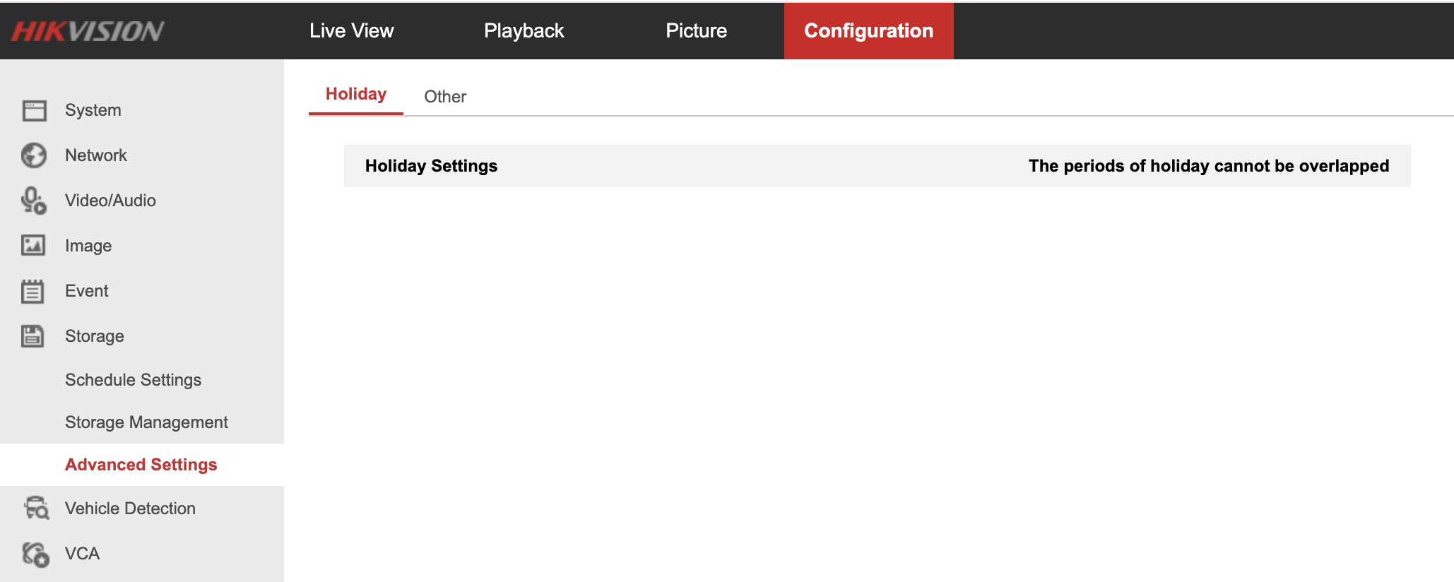

Edit: The above is V5 - I just noticed it's an I series you have so I'll guess if it's up to date it's 4.61.030. When I look at Storage > Advanced Settings on a V4 all I see is "Holiday Settings" and an empty page with no ability to add schedule (possibly as I'm on Mac using Windows in a VM)

That's exactly what I see. Empty page with no ability to add a schedule. It didn't use to be like this.

On a DS7616NI-K2/16P running V4.74.210 build 240108 the table is missing:

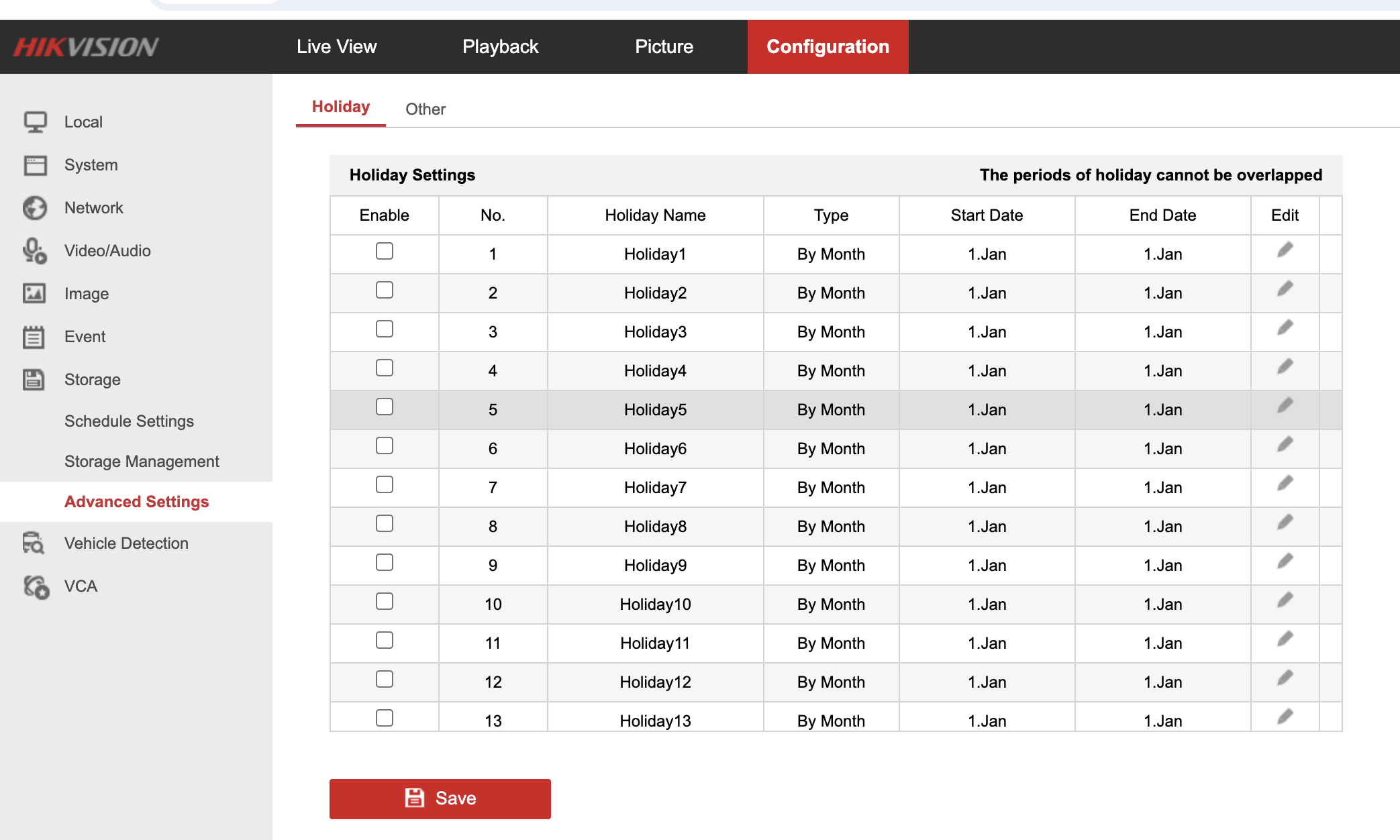

Whereas on a far older DS7608NI-E2/8P running V3.4.106 build 230316 the page is complete with the table for editing the schedules:
Thanks for the pics, and it shows I don't understand something. I DO have the page in your last picture. When I click "edit" it give me the opportunity name the holiday and set the dates. What I don't understand is *where* I set the arming schedule for the holiday.
So a simple example, for Camera 1 I have intrusion/line crossing set for 10pm through 7am only. For the holiday schedule I want to set intrusion/line crossing to 24/7 while I'm gone. Where do I set that new "holiday" schedule for Camera 1? Under smart events I do not see anywhere to set the alternate, "holiday" arming schedule so that when I enable it in the pic above, it overrides my normal settings. Any help is appreciated.
Just had a peruse through the I/M series manual and it only indicates that the recording schedule is affected rather than alarms. So let's say your normal schedule is 24/7 event recording - it will allow you to set holiday schedules and have a different recording setup for those dates. Nothing else needs to be set as the Holiday schedules take priority. But that doesn't allow you to schedule the alarms and their schedules, just recording.
