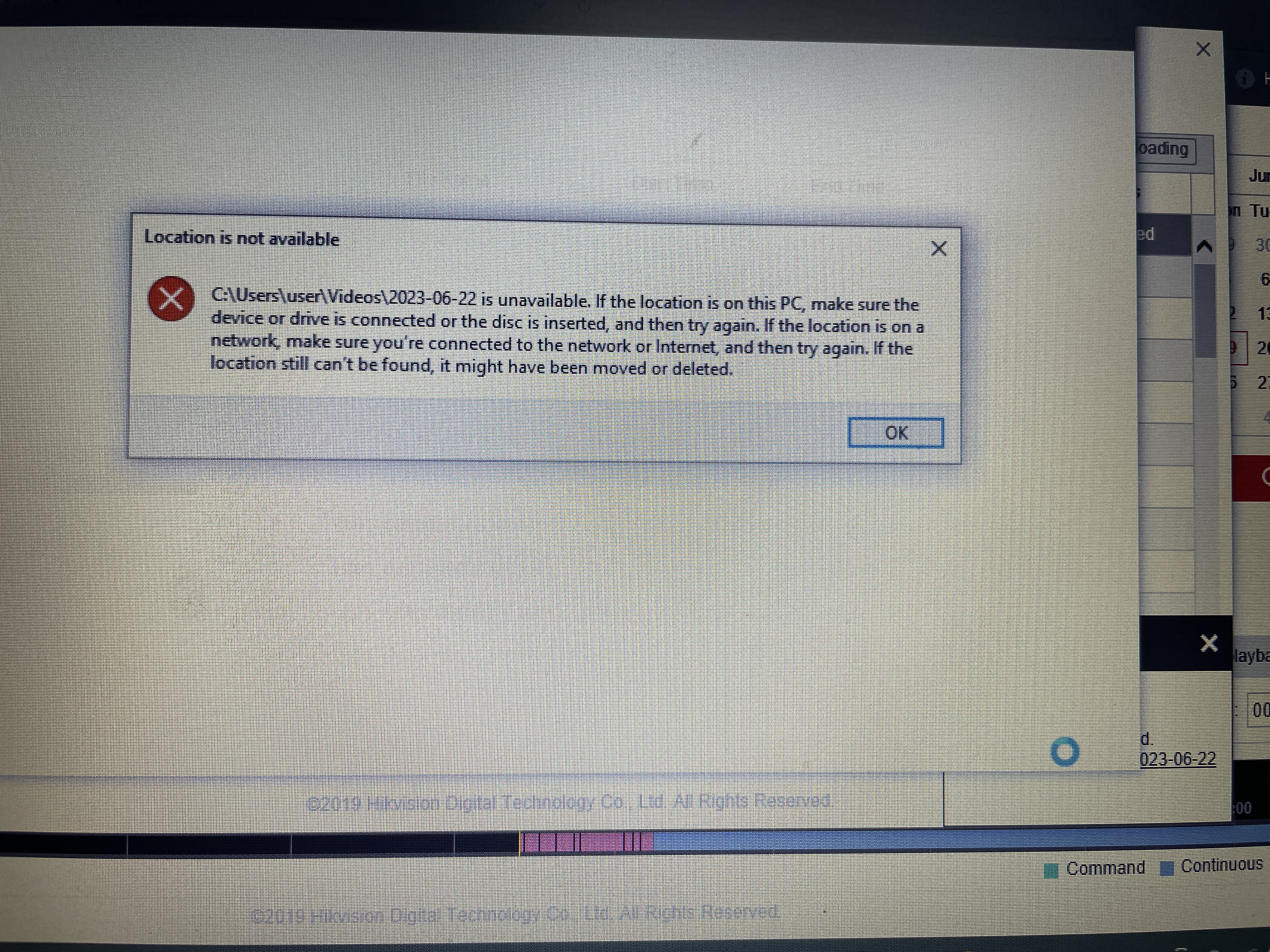

Hi Everyone!
I m trying to download some footage from two Hikvision Ip-cameras, though the network, using Microsoft Edge in compatibility mode. I already tried to tinker around the settings, but without any luck. The footage seems to be saved on the pc, but the directory is simply not created. I disabled the built in windows defender, changed the local setting in cameras settings, changed the protocol, file size, save location, ran the browser as Administrator, etc... but since Internet explorer is not supported, and i m forced to use Edge, this feature simply does not work.
Does anyone have any solution for this type of problem? Each camera saves the footage locally on it s micro sd-card.

No, i even get a download successful message in the bottom right corner, as the attached pictures show.

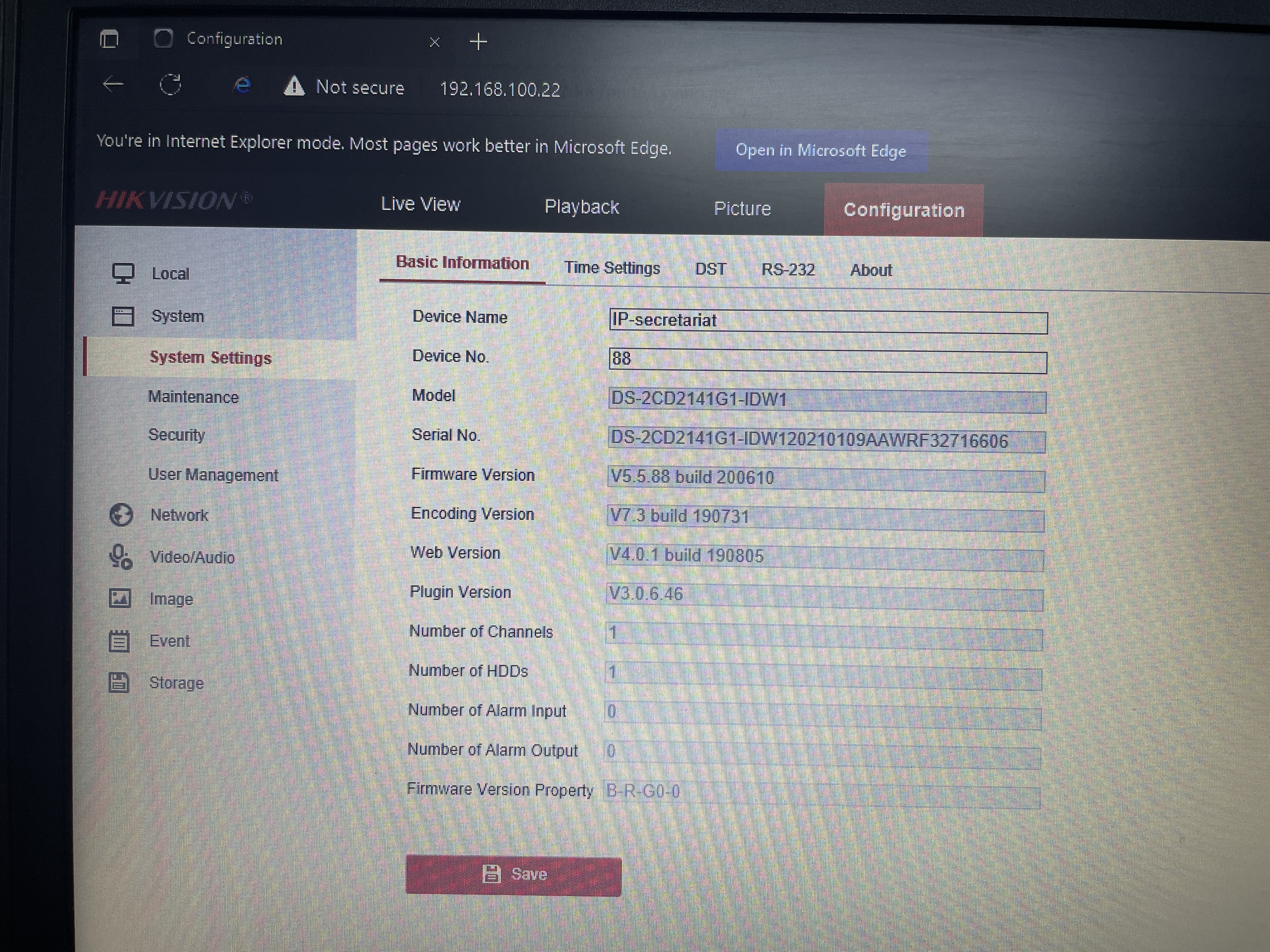

What's the camera model please?
And what firmware version is it currently running?
(apologies for not properly reading the info you provided / scanning the images first ~ busy peeps)
Model DS-2CD2141G1-IDW1
Firmware: V5.5.88 build 200610

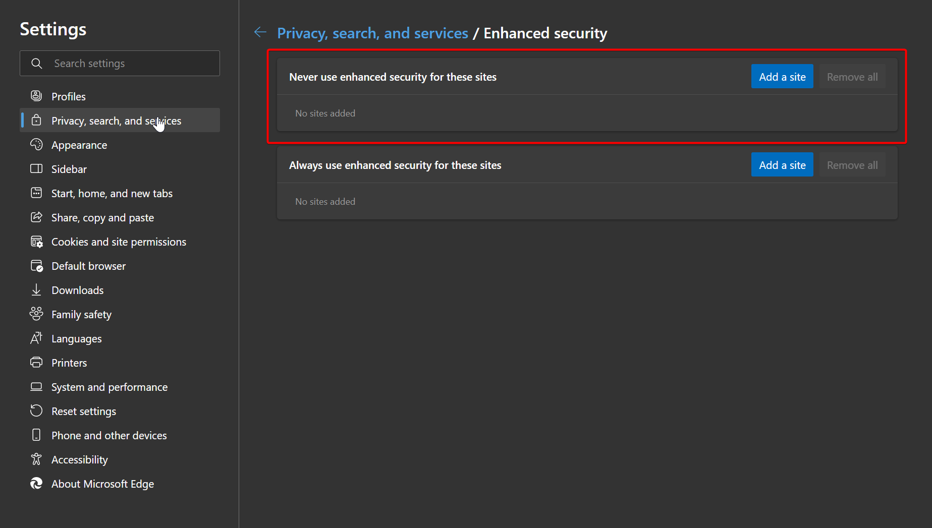

Hi @c.steve, I was speaking to a customer about the same issue and the fix was to go to Internet Options > Security [tab] > Trusted Sites in Edge, and then add the IP address of the camera.
As soon as they did that, the files started saving again - does that resolve it for you too?
EDIT - when looking on the latest version of Edge, I think this setting is in Privacy, search and services > Enhanced Security:
