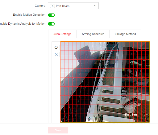

When i place the motion detection grids on one output of the Hempispheric cameras, hit save, change to the next camera, set the grids, hit save. Then, when i go back to the previous camera, the motion detection grid is gone?! reset it, save, then the next one has gone! i originally assumed it was to do with the software dewarping of the units, but hikvision assured me this was possible but have since been unhelpful in getting to a solution aside from the standard " reset the system/ firmware" solutions.

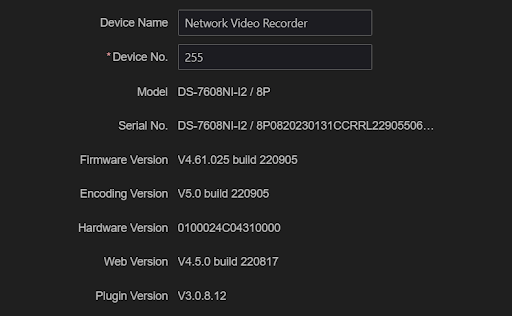

NVR Firmware

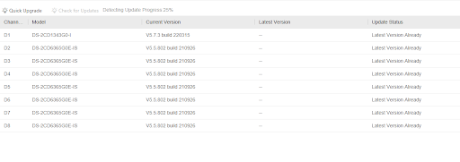

Cam Firmware

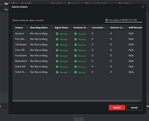

No recording??
Motion areas set on hemispheric cameras, but will not save selection.

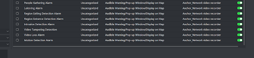

Fixed camera has motion detection options
Hemis have no motion detection option

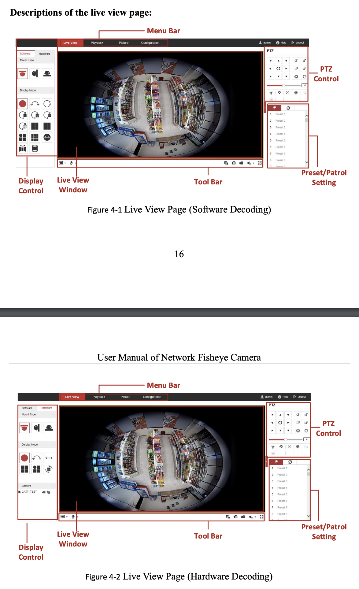

Hi @Navcom
If you log in to the hemispheric camera you should see the Display Controls on the left of the live view to change how the fisheye image is displayed, see below:
