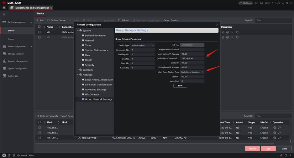

Solution1: VMS-4200
  1. The correct door station type/IP has been filled in the indoor station configuration.
2. Check that the indoor station details have successfully registered onto the door station’s device management page
