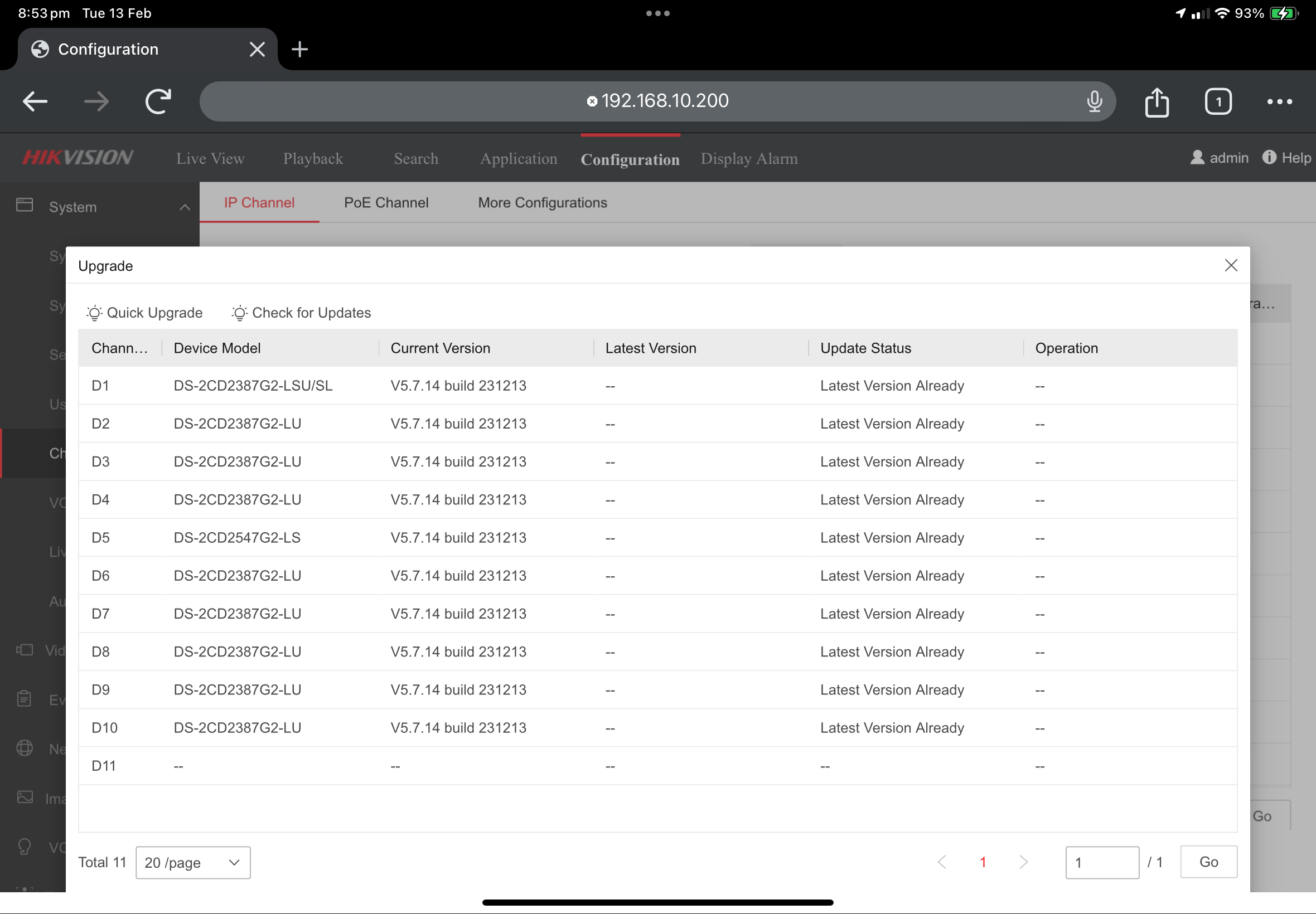

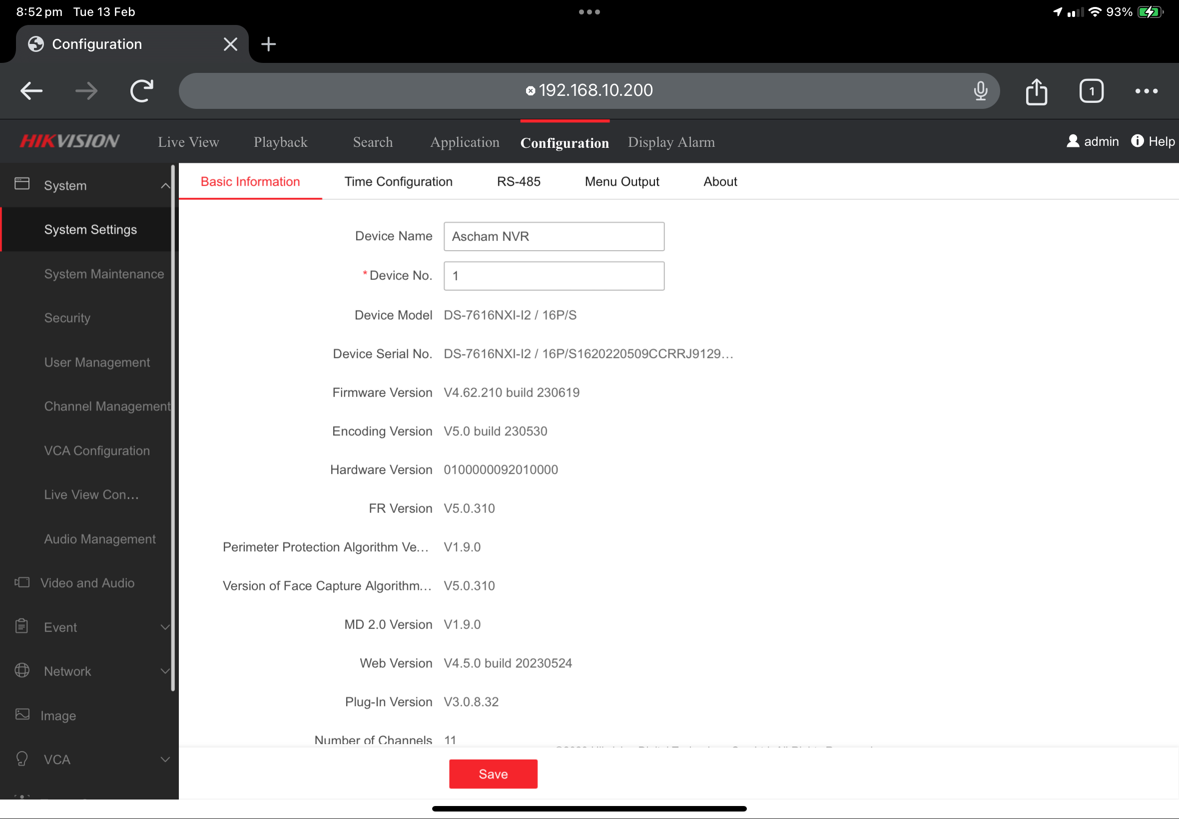

NVR and Camera details in pic below.
Cam 11 is a RTSP feed of a 2N Door Station.
Thanks @kinros
So the only camera you have that supports the Live-Guard features is the 2387G2-LSU/SL, have you tried opening just the live view of this camera to find the Live-Guard settings/controls?

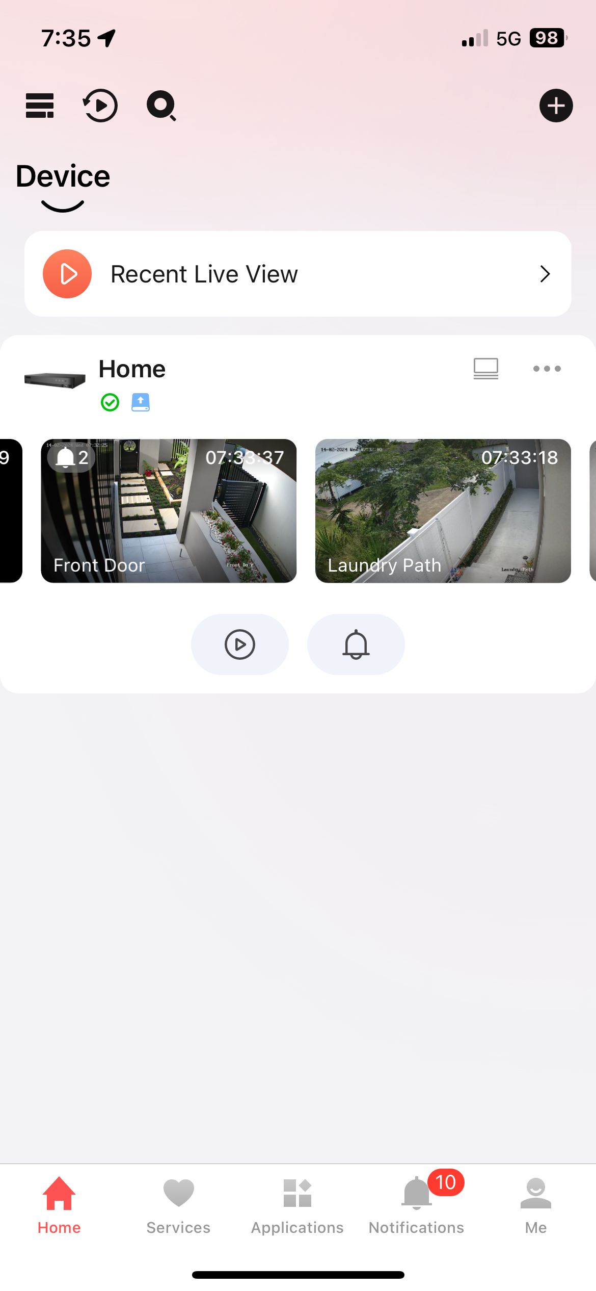

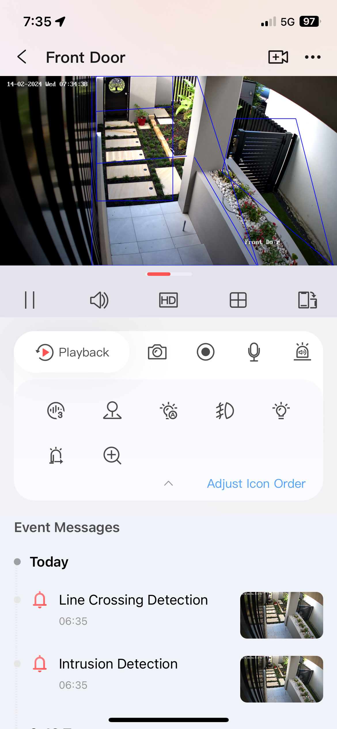

Can you please share screenshots of your Hik-Connect app?
Thanks @Dan,
Yes, some of the other cameras are set to trigger the audio on this camera.
Please see screenshots of Hik-Connect app attached.
Hi @kinros
Thanks for sharing those screenshots.
What exactly do you mean by "Notifications icon does not have the cog on it"? Have you seen mention of this cog icon in some Hikvision instructions somewhere?
The NVR definitely does support Live-Guard cameras and I can see in the 2nd screenshot that the app is displaying the button to manually activate the strobe/audible alarm, what else are you expecting to do in the app?

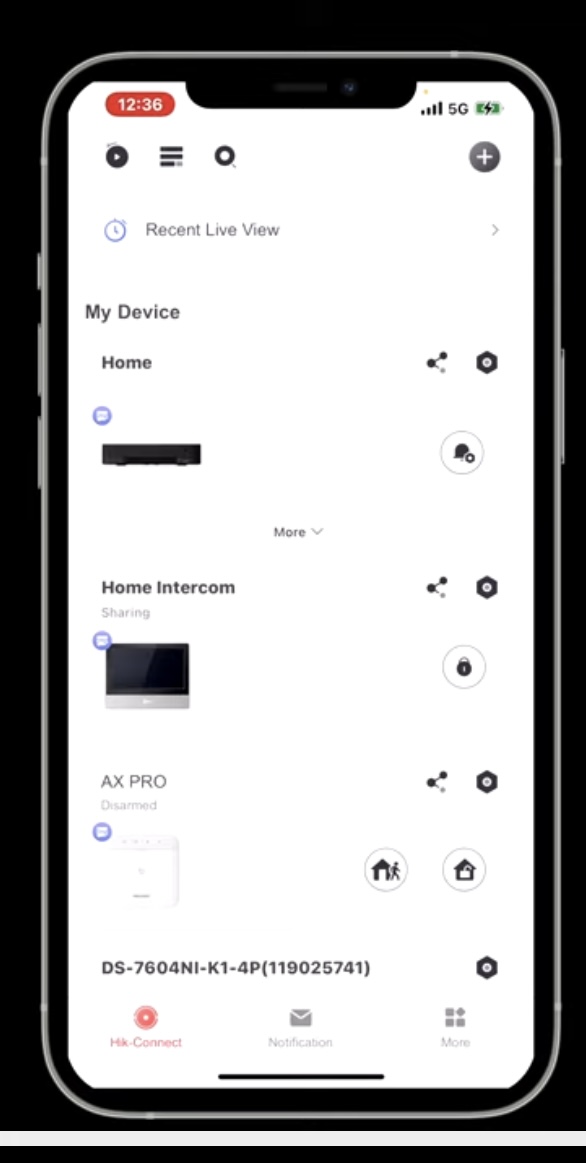

Hi @Dan,
See below screen shot taken from a video explaining how to setup LiveGuard. The alarm icon has a gear cog in the bottom right corner … mine doesn’t.
I am expecting to be able to arm and disarm the alarm/strobe by a press of a button and also set a schedule when the alarm / strobe will activate … this is a seperate schedule to the smart event schedule which is on24x7. This is so it will alway send a push alert and mark the event on the timeline, but only trigger the strobe light and audio alarm say after 10PM at night.
I hope this makes sense
