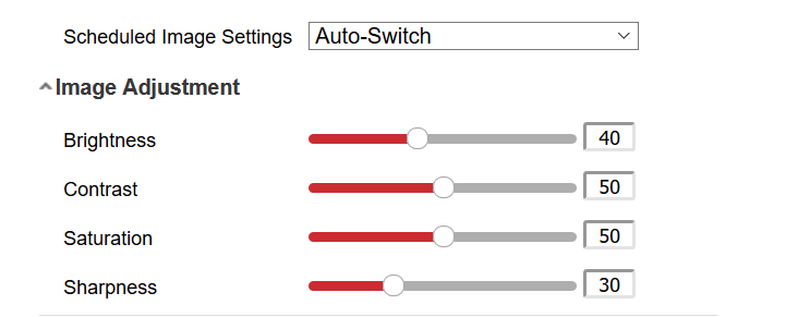

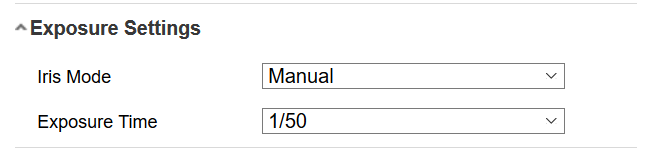

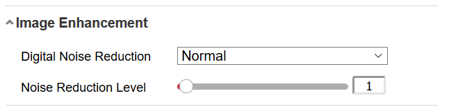

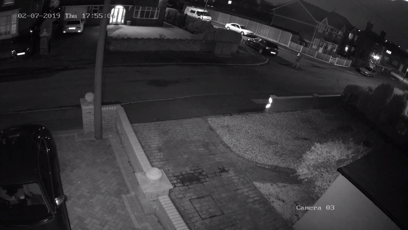

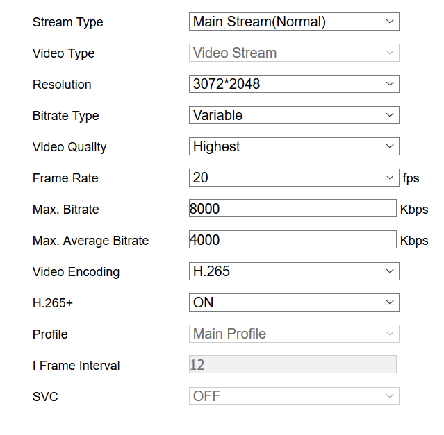

As you advised i have updated the firmware to the latest and reset the camera to its default settings. The cameras are mounted on the soffits and as you can see from the pictures we have only 2 street lights for this camera, when our security light turns on we are able to see people walking slightly better, but with out it this is the result, im not sure how clear it is but there is alot of "noise" also, DNR is set to 1, any help would be very much appreciated
A few observations:
First impressions / still images - they don't look too bad.
I would say that the views are too wide - you are unlikely to capture facial details from such wide scenes.
You are using 2363 flat domes.
We would normally only recommend those for low-mounted positions e.g. they make great door cameras.
Unfortunately, they are Hikvision's smallest outdoor camera and only have 10m/30feet of infra-red reach.
Therefore, the built-in IRs are not adding anything to the illumination of the scene.
Therefore the cameras are working hard to capture and render images in the dark.
The cameras will increase their gain and slow their shutter speed. resulting in noise and motion blur.
For your mounting positions we would recommend 2383 8MP turret cameras, and to have any chance of capturing facial details you will need to cover a narrower area only.
