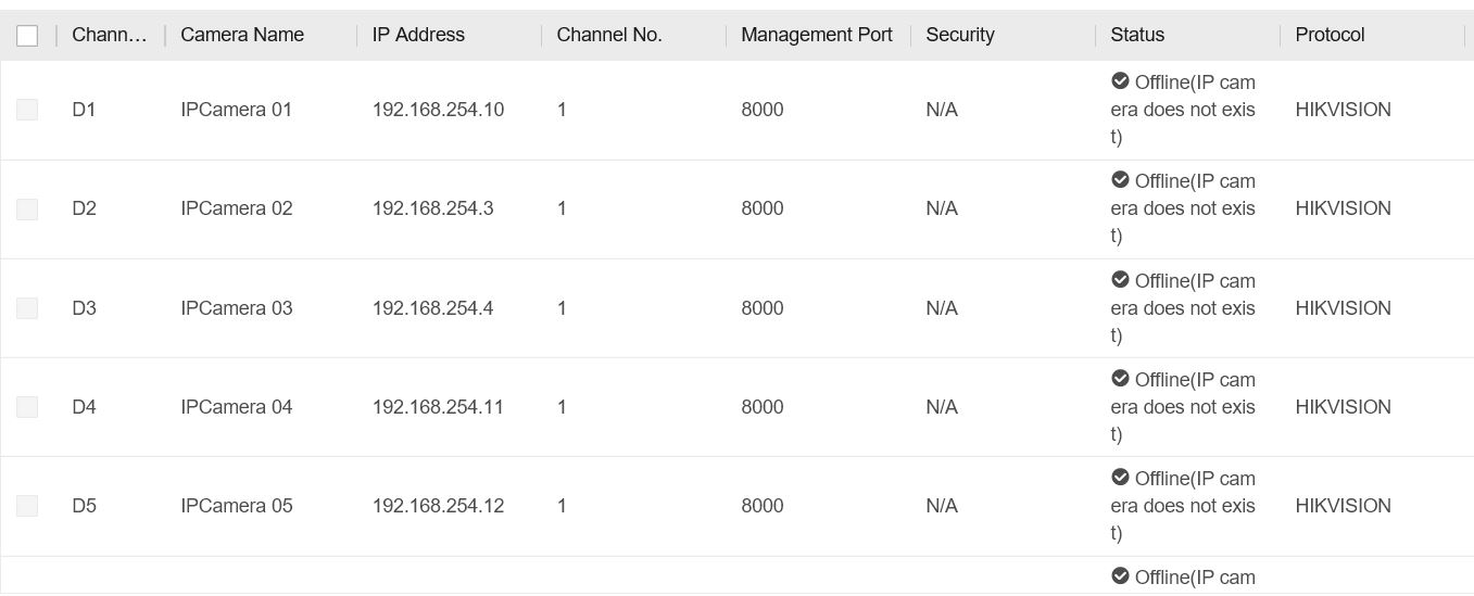

Suddenly all cameras went offline the status shows "Offline(IP camera does not exist)"
NVR
Current Version *V4.51.025 build 210927
Please help what can I do I have rebooted several times to enable the disabled POE option in NVR. My cameras are connected directly to the NVR POE port.
Has the POE port gone bad? all property of NVR works like remote login, user management etc but the camera does not show online nor live view is working. Please help

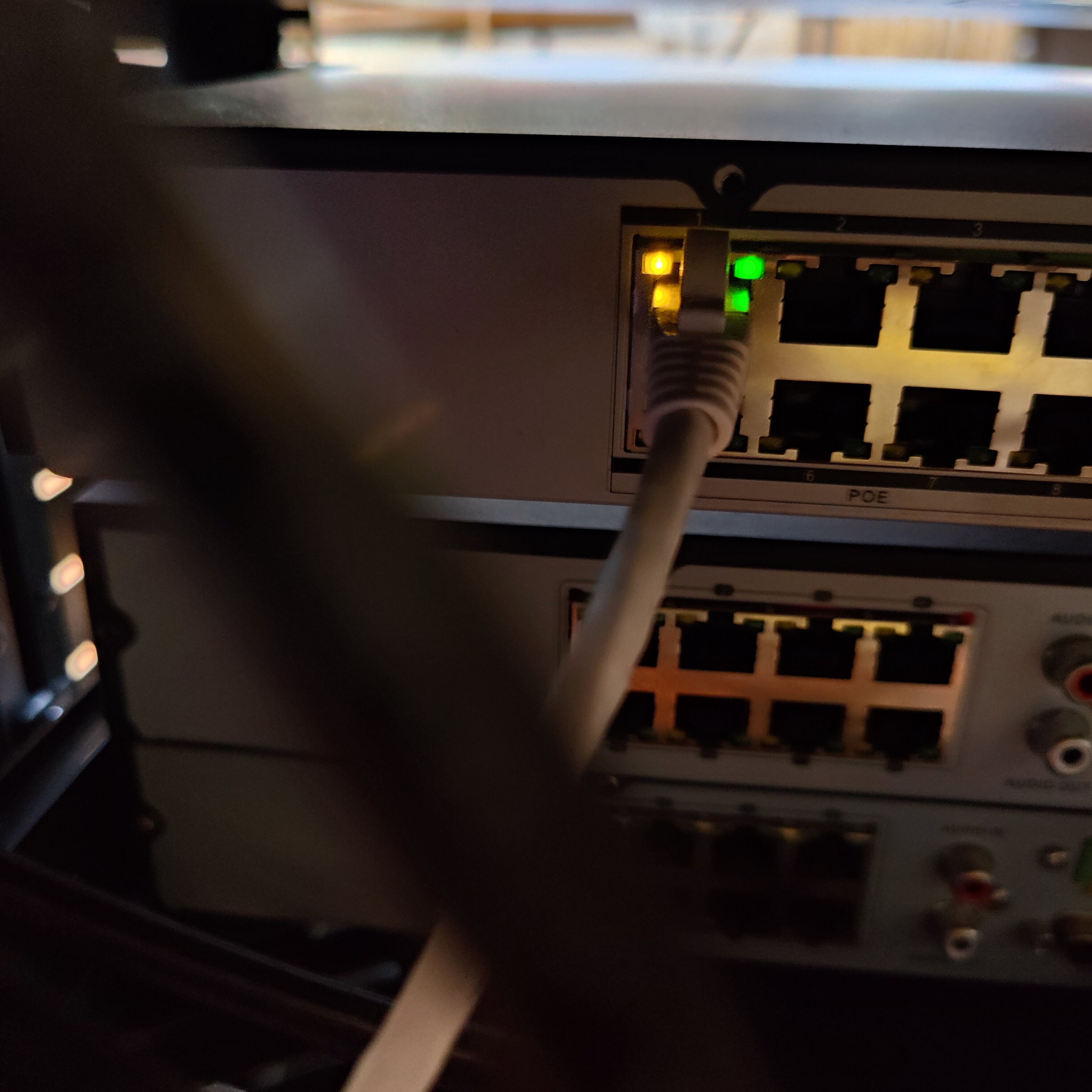

See the attached picture, if the PoE ports are working/providing power to the cameras you should see at least one of the 2 LEDs for each port lit up.
If the built-in PoE switch on the NVR had failed, one potential sign of that would be to see all of these LEDs off.

we searched the log and we are seeing PoE Power supply exception. exactly at the same time in NVR log exactly at the same time when all camera stopped working. So can we use this TL-PoE150S (tp link injector PoE Injector) to test if the nvr poe section is faulty is it safe to do so? will it impact the camera? also, will nvr accept the camera data if poe is not working? The injector is single port so we want to try with one camera. we plan to place the injector in between the nvr and camera while data + power endpoint goes to camera and only data end point goes to NVR. will the test work any precaution we need to take? And we intend to keep the poe of the NVR enable else we dont get IP address assigned. and IP address is 192.168.254.2 for first camera. we will leave the camera in plug and play
Yes, That PoE injector should be fine to test the cameras.
You can connect the Injector between the camera and NVR, but if the NVR's built-in PoE switch is not receiving any power and you aren't seeing any LEDs on it then I doubt it will receive the data from the cameras.
If the cameras still won't work this way, it probably means the PoE switch is completely broken and you will have to move the PoE injector to your local network, change the camera's IP addresses to local network IP addresses, and then add the cameras to the NVR over the local network.
