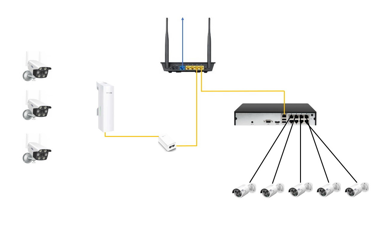

I will try to describe exactly how the network is structured.
Average family house, internet comes via cable. A WiFi router for the household (mobile phones, Netflix, etc.) is connected to the cable modem.
To separate the camera system from the household, I installed a second Wi-Fi router, which is connected to the first router with a cable.
The NVR is plugged into the first port of this second wifi router. The 5 POE IP cameras are connected directly to the NVR, they work fine.
The WiFi cameras are far away, so they communicate via an Outdoor Wireless Access Point. This Outdoor Wireless Access Point is connected to the second port of the second wifi switch with a cable.
I can't connect these cameras to the system with the new NVR and I don't know if it is even possible?

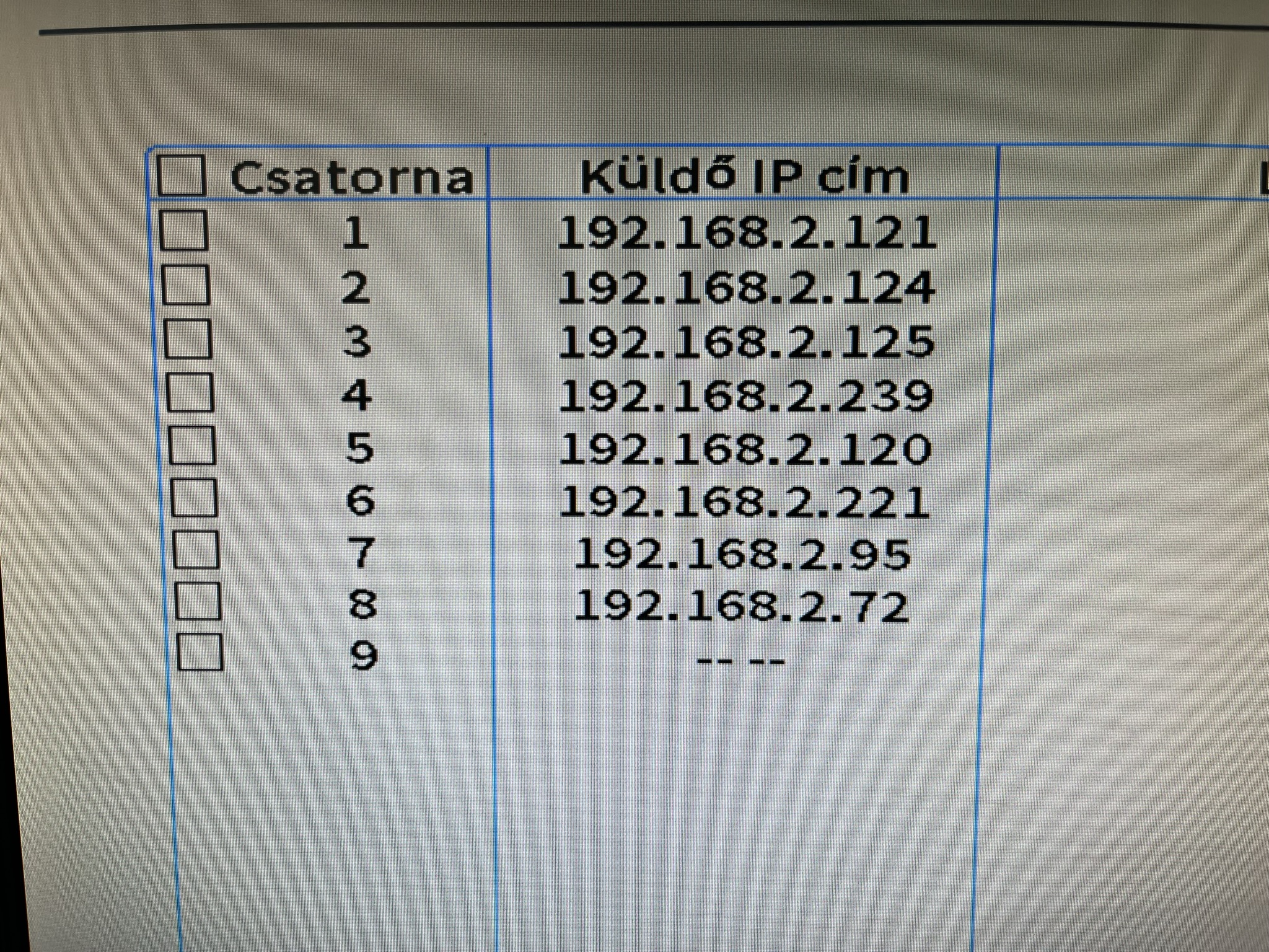

Now I'm at work and the cameras are at home, so I won't be able to check until the afternoon, but I remember the wired cameras are now at 192.168.254.x. I access the WiFi cameras with a mobile phone app, they remain at the "old" IP address 192.168.2.x In the previous system, the wired cameras were also at the IP address 192.168.2.x. This is almost certainly not a good thing...
what IP addresses are the wifi cameras using and can you ping them?
David
These were the IP settings in the old system. Sorry that it's in Hungarian, but the gist is understandable

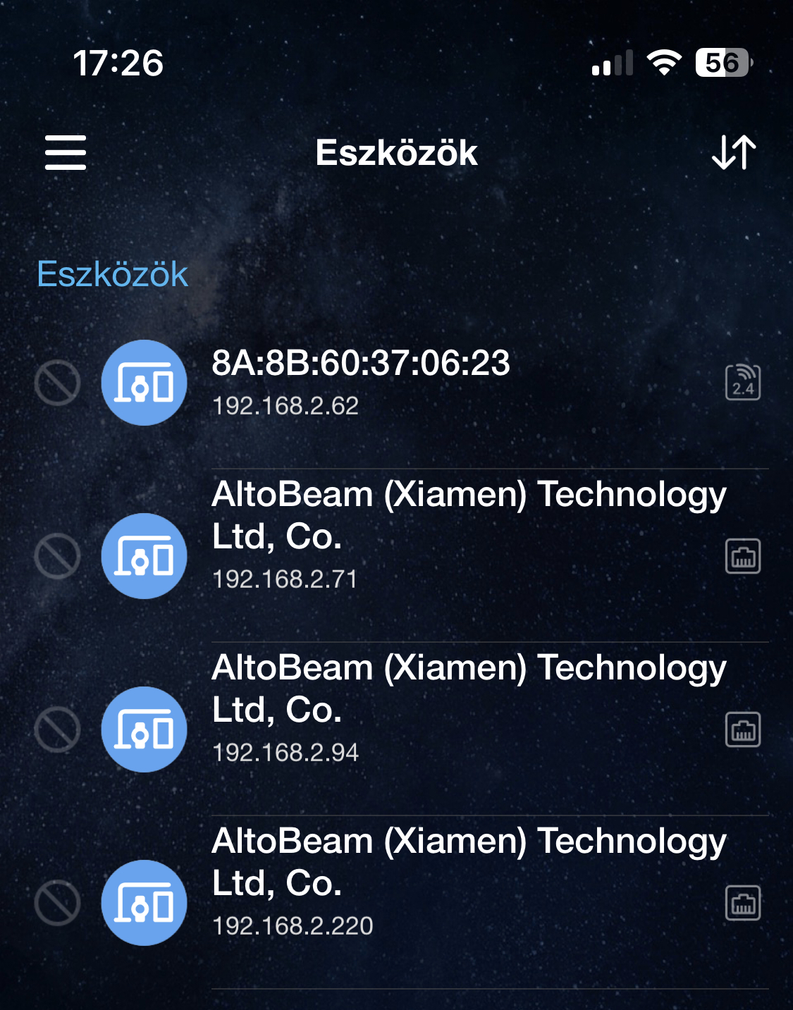

In the router mobile app, I see that all three cameras are available on the network at IP addresses 192.168.2.62,71,94
I tried to add it manually by entering these IP addresses and selecting the ONVIF protocol, but it was unsuccessful

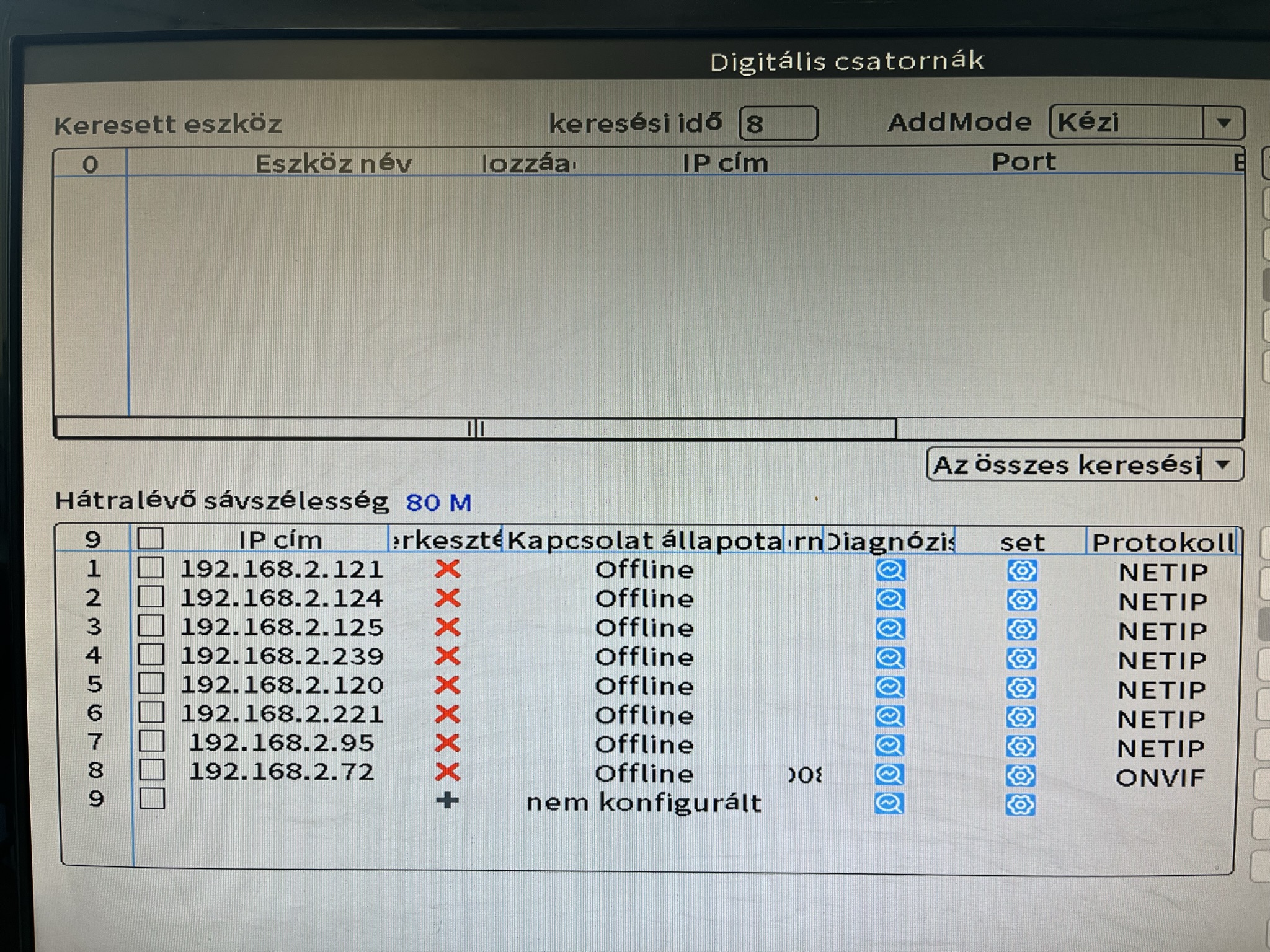

Now I see that in the case of the old NVR, the protocol was not ONVIF but NETIP. Maybe it should be set differently in this case?

Some of my cameras are not hikvision but the sadp tool detects them as hikvision and they work with the hikvision protocol. From one of your earlier images, you may have to use the media port 34567. At a minimum RTSP should work but you'll need the RTSP URL.
What protocols do you see when manually adding the cameras?
