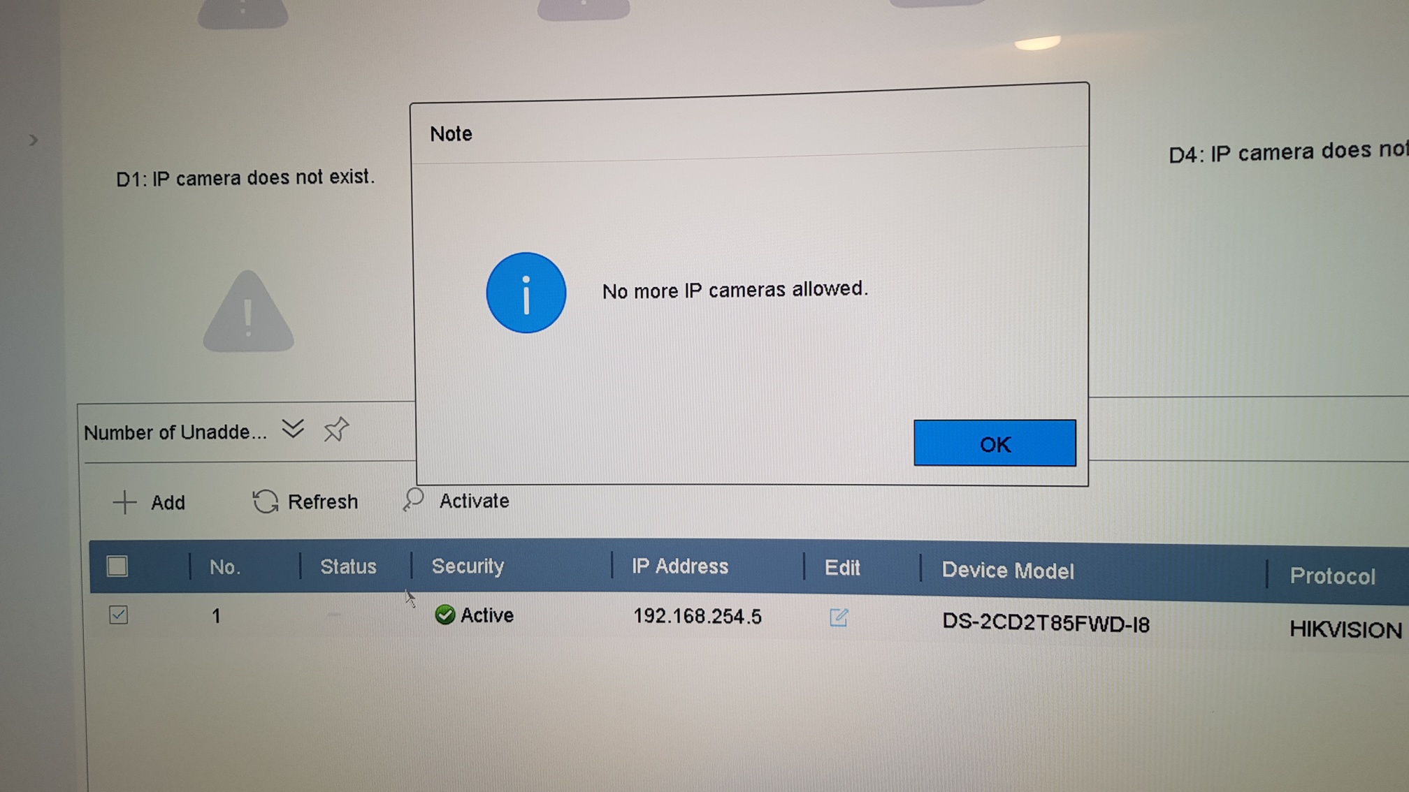

Had my 2 cameras plugged in to my nvr working fine now i have plugged my cameras in to my PoE switch they wont work I get no more ip cameras allowed, Any Help. Thank's Leigh

Not sure why you are getting that specific error message.
The problem is caused because your cameras have IP addresses from the NVR's domain range, and now need setting to IP addresses in your general LAN domain range (by use of SADP).
If you have no other cameras, the quickest route, to the best clean setup, is to reset everything and start again.
Use your browser to access the NVR's Config -> Maintenance -> Reset to Default.
Use the factory reset buttons on the cameras to reset them, then SADP to add them to your network and set passwords.
