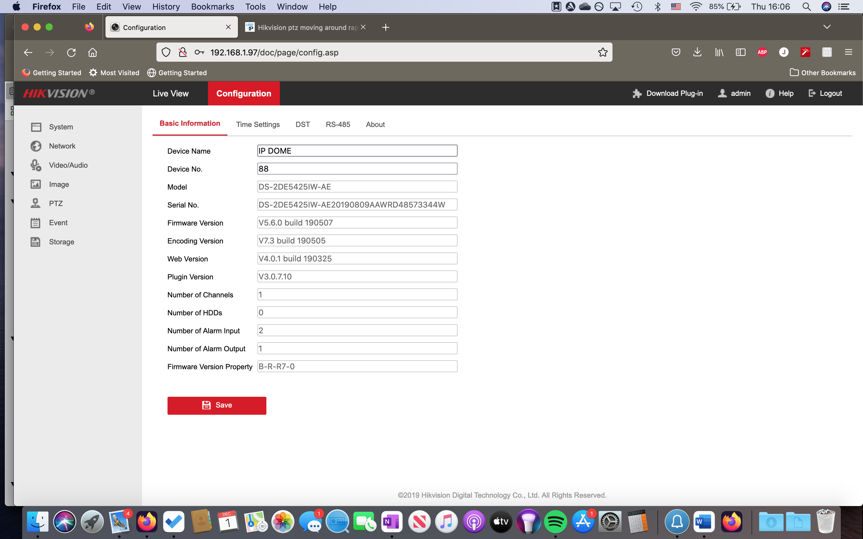

Hi @1jp
Can you send a screenshot of the basic information page for the camera in its web browser interface please, showing the full model number, firmware version, etc, please?

Ive attached a screenshot of the basic information page.

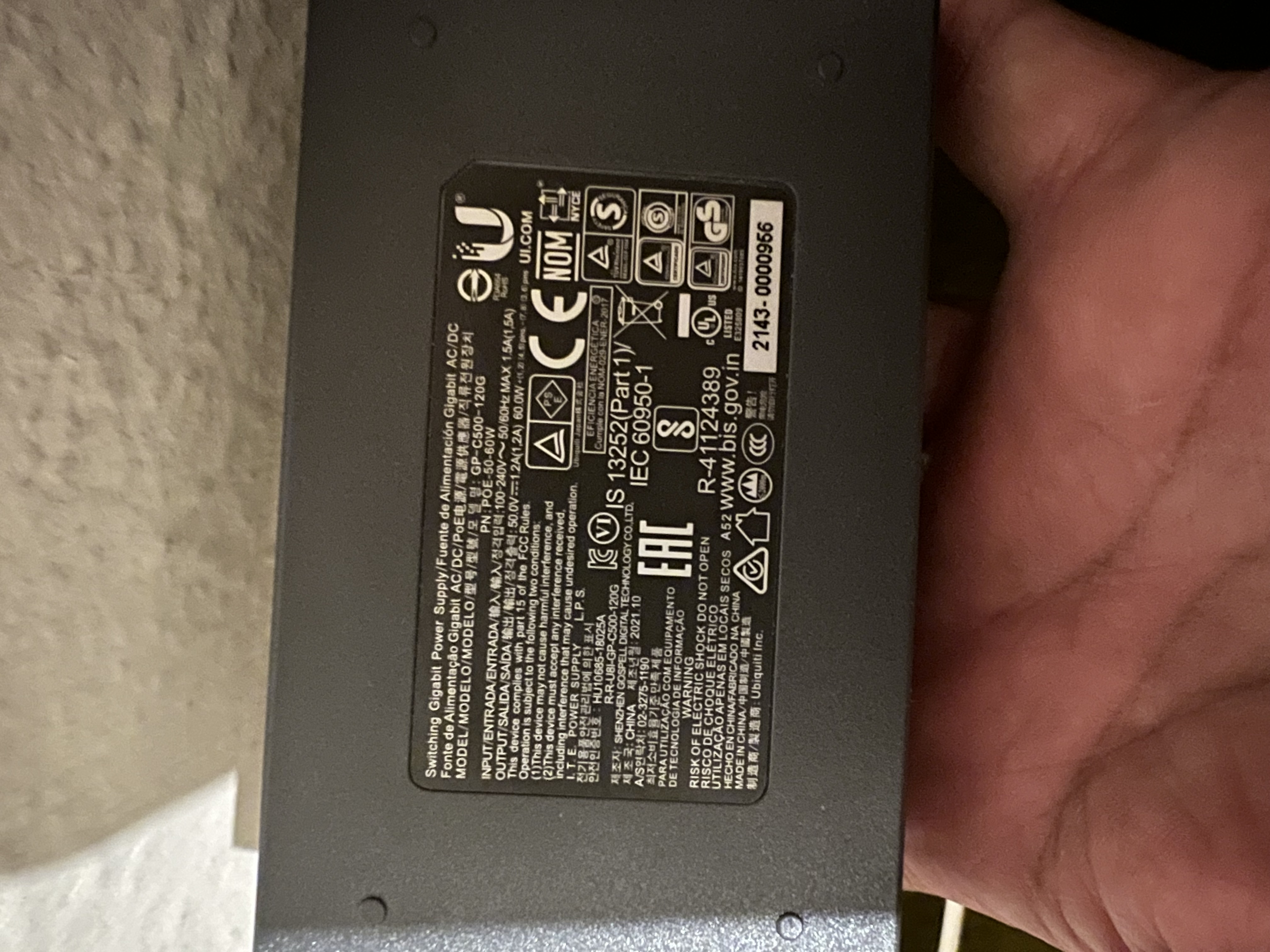

Thanks for that, can you also share a photo of the injector's label, please?

Also, definitely try updating to the latest firmware, which is V5.6.18 here.

attached is label from poe injector. the smart tracking was enabled from the config-ptz-smart tracking, and not in linkage method. Even still, the camera movement speed was set to 2 to reduce any noticable noise from when it does start tracking something. however when its doing its crazy thing it moves at what seems like max speed.

Your PoE injector should be fine, so I would try the latest firmware and a hard reset before anything else - let us know if you still see it happening after that.
