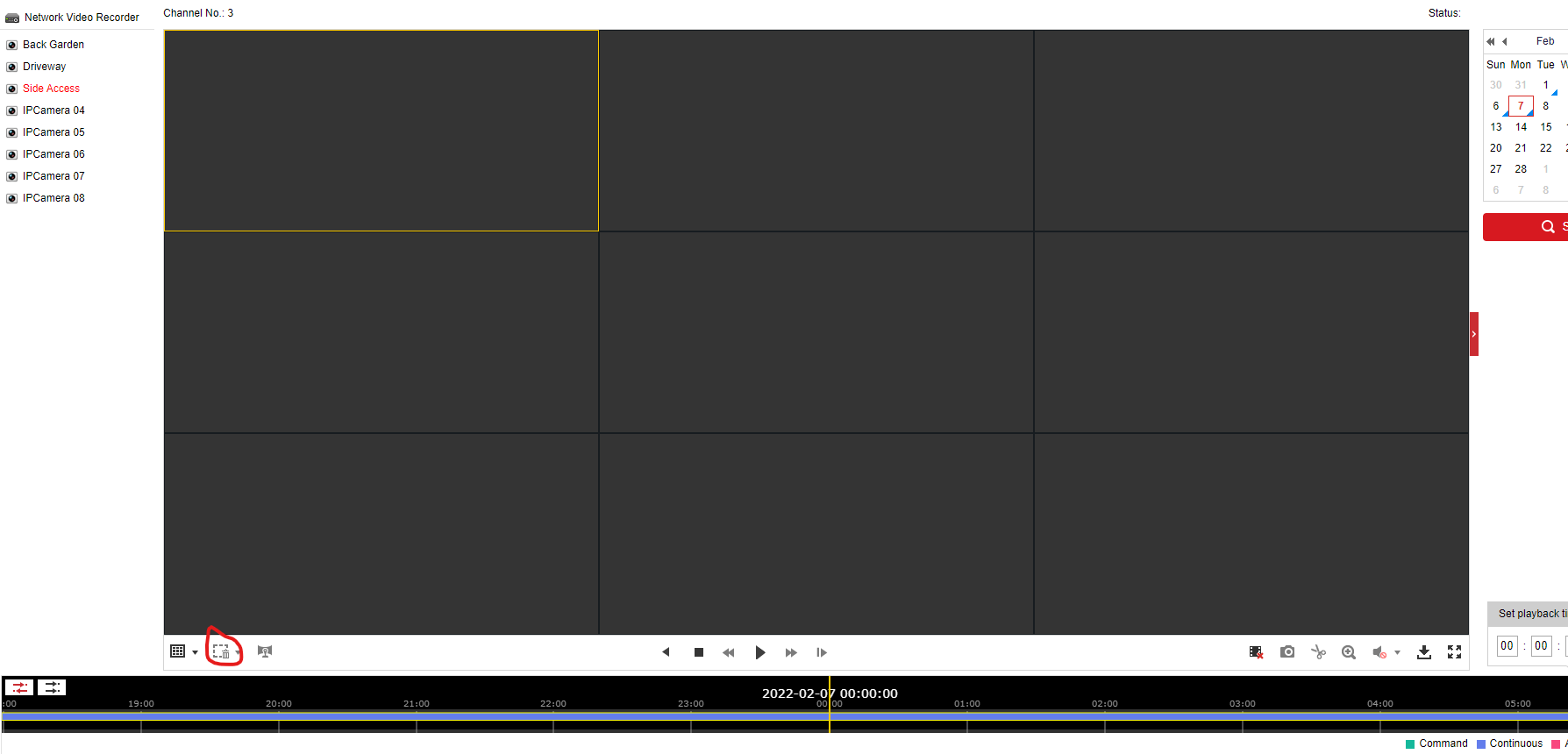

D ditto4 New Member Messages 1 Points 1 Feb 7, 2022 #1 Hello, Can anyone help with the hikvision vision smart search button being greyed out? My NVR model is DS-7608NI-K2 / 8P and running Ver. V4.30.071. Thanks in advance. Attachments hk.png 40.1 KB · Views: 145
V venturis Active Member Messages 32 Points 8 Feb 8, 2022 #2 ditto4 said: Hello, Can anyone help with the hikvision vision smart search button being greyed out? My NVR model is DS-7608NI-K2 / 8P and running Ver. V4.30.071. Thanks in advance. Click to expand... Searching from the playback interface only works when a single channel is showing full-window (not full screen). When you bring up any single channel into full window view the function will become available. Be prepared to be disappointed though. The smart search functionality in the web playback interface is very very limited. Try using IVMS4200 from a PC which is much better and actually works.
