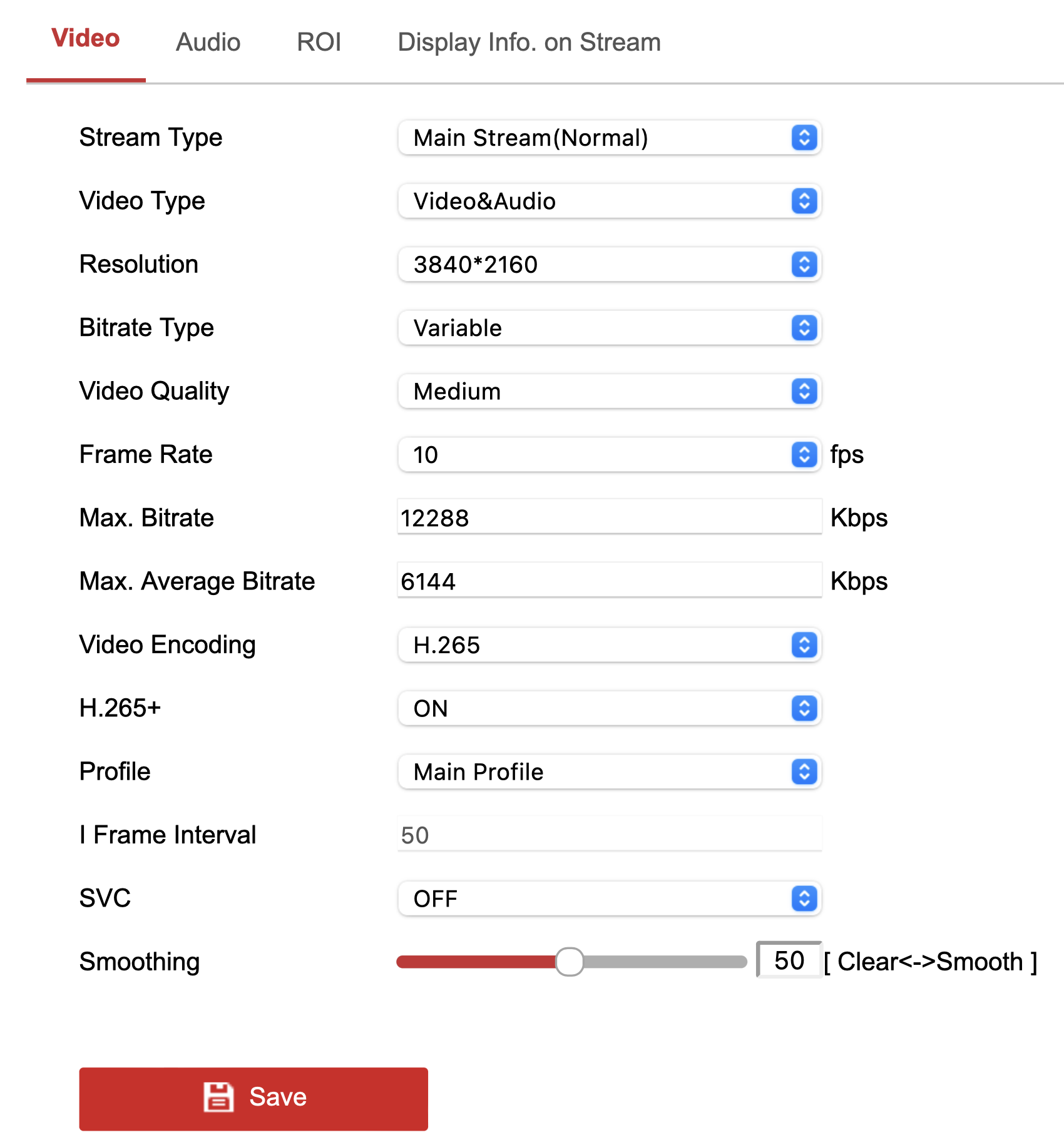

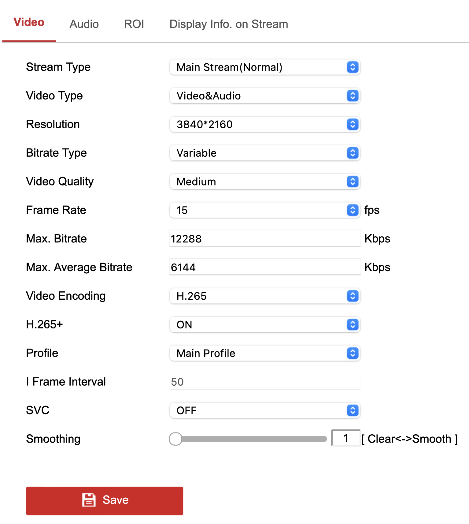

Every so often I get stuttering/skipping of a few seconds one of the Front 8MP 2387's. I will attach a photo of the settings of both cameras, the only difference being 10fps vs 15 fps and the smoothing level.

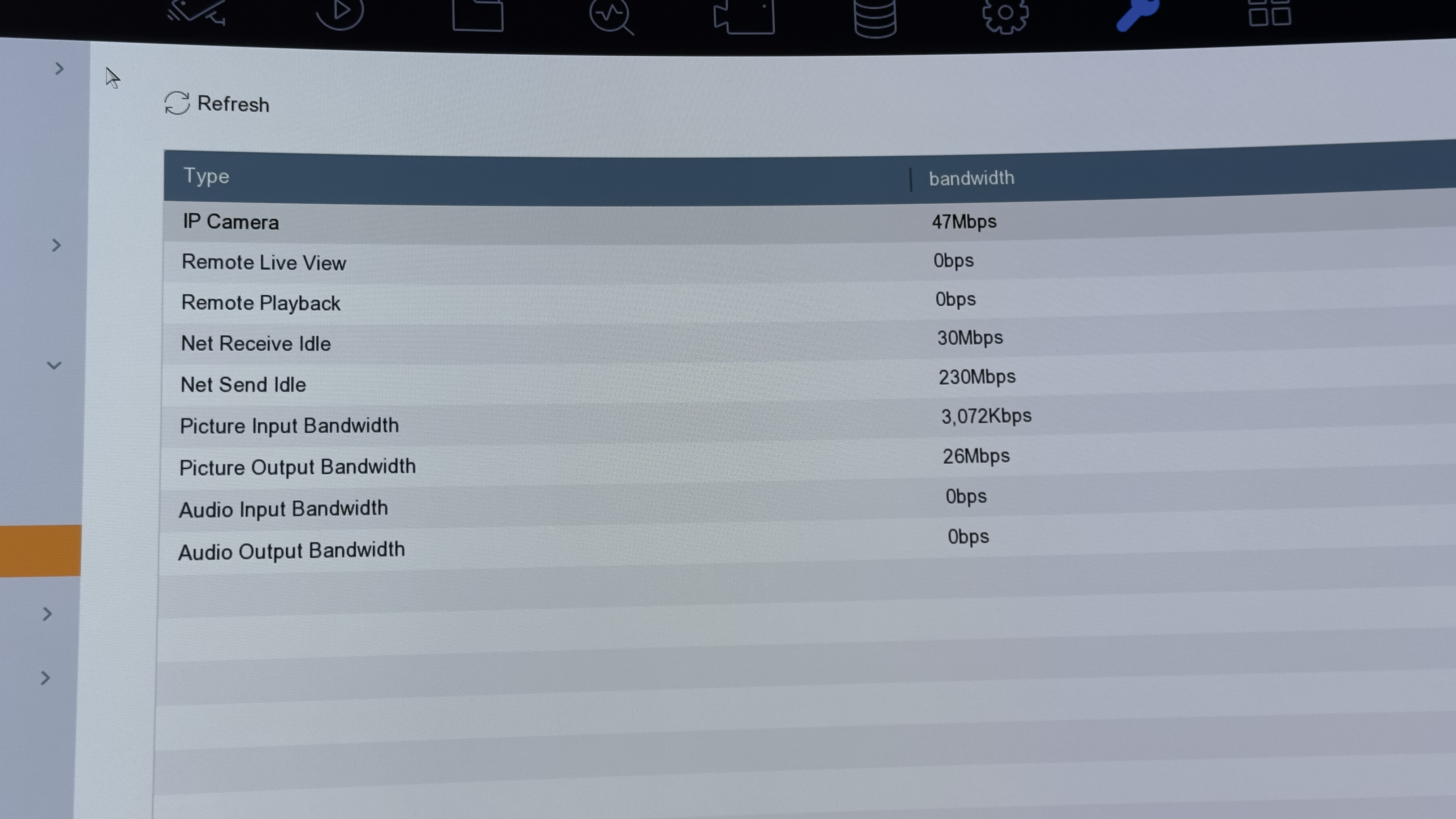

I have checked the Network stats and it shows 47mbps incoming bandwidth, so that should not be a limiting factor. I have had to turn the quality down to medium too as it just doesn't seem to be able to handle it on high or highest.

![front-camera-settings.png front-camera-settings.png](https://www.use-ip.co.uk/forum/data/attachments/9/9516-6787f909a5ae0fae2d2b21ea4a18ad4f.jpg)
![garage-camera-settings.png garage-camera-settings.png](https://www.use-ip.co.uk/forum/data/attachments/9/9517-3813c0e360bc26047fbb35229b7cd944.jpg)
![IMG_1645.jpg IMG_1645.jpg](https://www.use-ip.co.uk/forum/data/attachments/9/9518-24caa9c2c86ef724ce235b4443ab029f.jpg)
