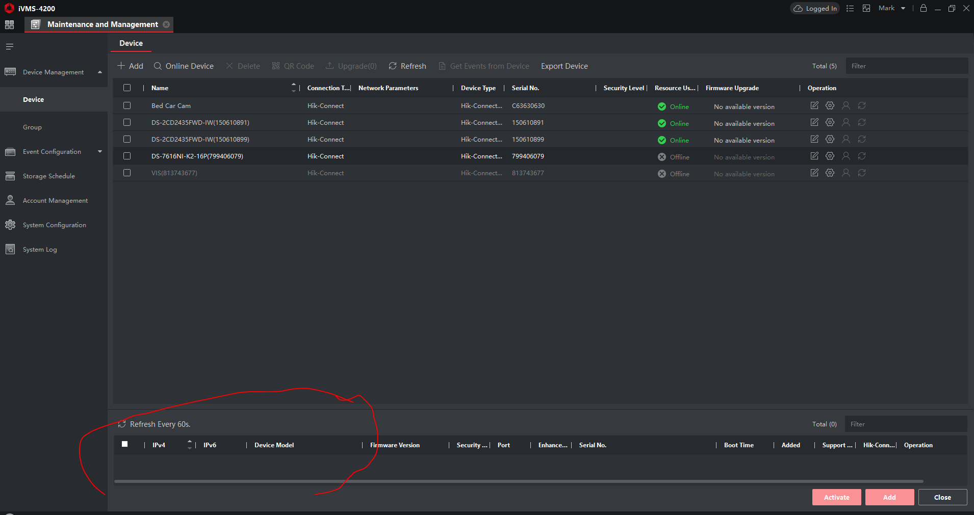

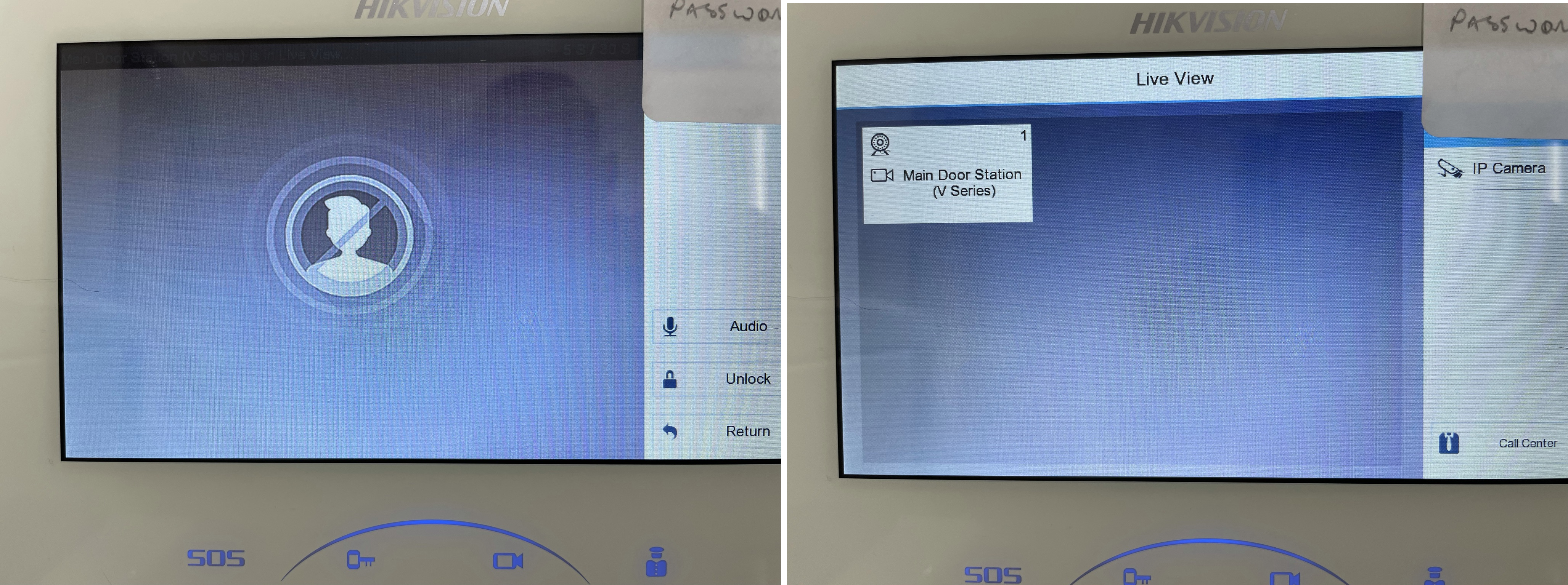

Does anyone have experience with the Hikvision Video Intercom Door Station DS-KV102-IM and DS-KH8301-WT.

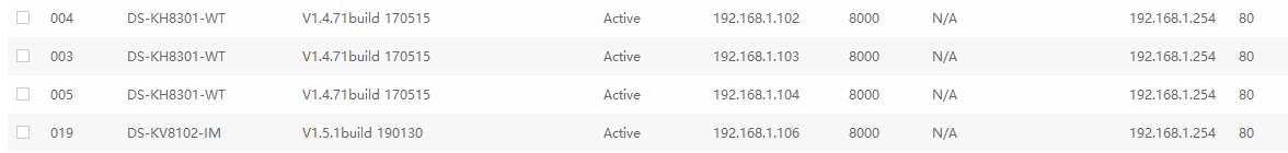

I had a set up that was working fine for a couple of years but I have managed to change something while trying to add an additional indoor station and it’s not anymore! I think there is an IP conflict as one of the indoor stations tells me this 'IP conflict" but there are no duplicates are in the SADP.
I can’t see any 'online devices' in iVMS 4200 when I search, despite 16 other cameras all working properly and running over LAN that should show up.

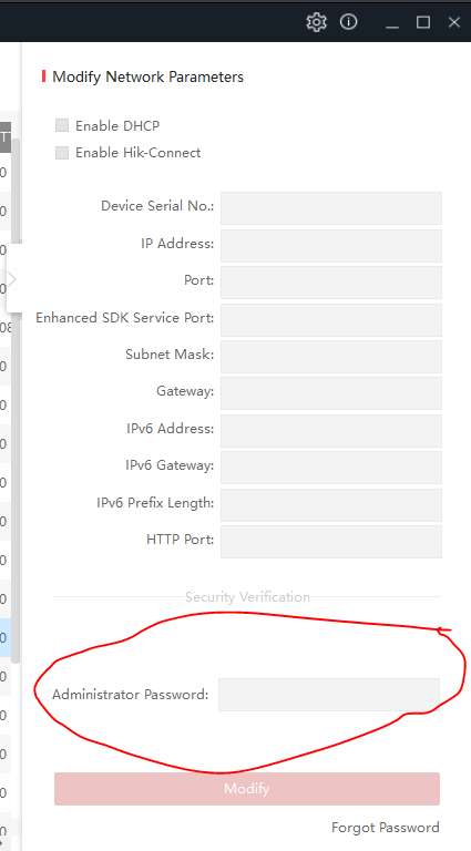

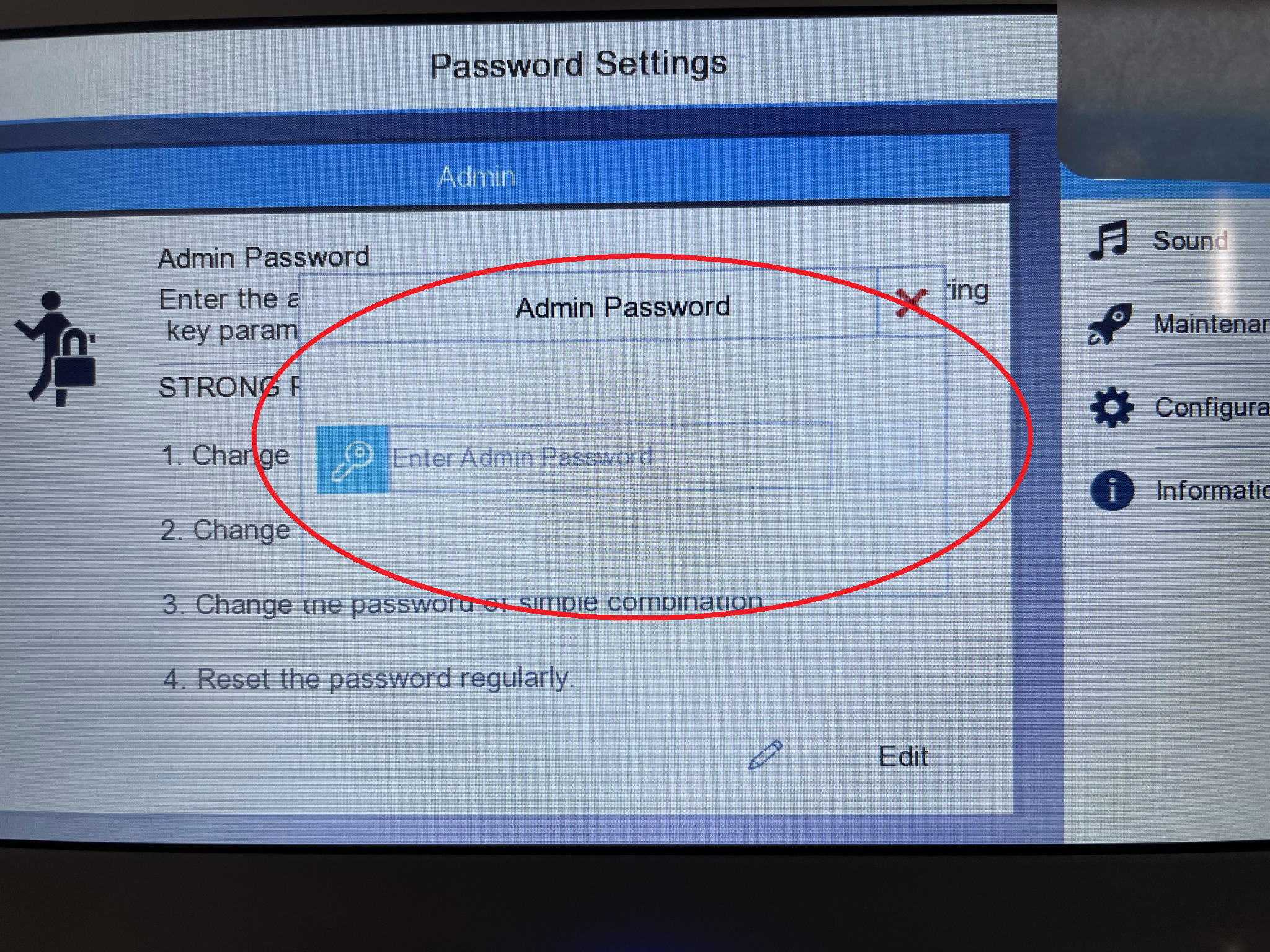

If I try and access the Villa door station over a browser using the IP address shown in SADP it refuses to connect. I can’t reset my door extensions because it says the master password is incorrect, despite setting the username and password in SADP.
Happy to pay someone for remote or on-site support from anyone that can help.
