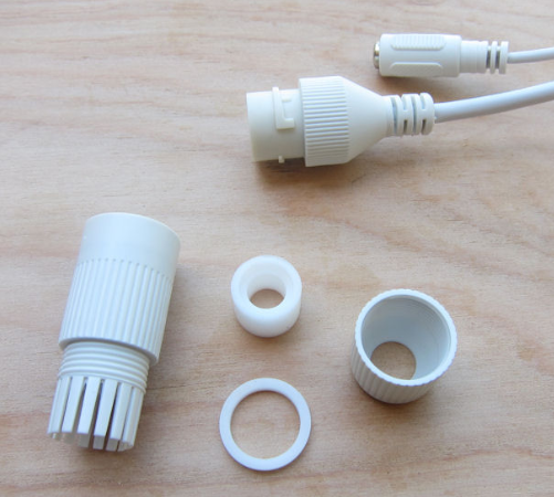

I am really frustrated with
I have installed total of 5 Hikvison all ds2cd2155 two are facesing back garden and two front of house and one indoor
All connected to Hikvison NVR 7600K 8 channels POE my problem is the two facing back garden
They keep going of line mainly at night and when it is cold
The cable run is 20m I thought this was issue so I changed it cat 6 I have covered them well in a conduct pipe
I double checked connectors all fine
I have sawpped camera form to back so it is not fault with camera
Tried diffrent port
I though about switching Infrared off but then no point have this camera
Please some one help I tried calling Hikvison but call never gets answers
