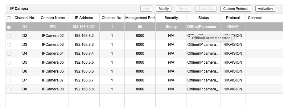

I'm having issues with my HiLook NVR-208MH-C/8P NVR. I've successfully set it up to connect to one third-party ONVIF camera (model is QVIS V TURVIP-2-FG) which is plugged directly into the NVR.
However, if I restart the NVR it does not connect to the camera on startup. Instead, I get an error in the camera management page on the web interface saying "Offline(Parameter error.)" (see attached screenshot). If I try to view the camera through iVMS-4200 on my mac, I get a slightly different error message:

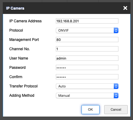

The way to fix the issue seems to be to go into the camera settings and changing the Management Port from 80 to 8000. It will then successfully connect. On connection, the Management Port is changed back to 80 automatically (see screenshot showing settings after this happens and camera is connected). I've tried triggering a new connection attempt by changing other settings here but the same error message appears if I do that so it does seem to be something specific to the Management Port.
Does anyone have any idea what is going on? I assume the cameras should just automatically reconnect on reboot? I'm not sure what the Management Port actually is, or why it should be 80/8000 so it's hard for me to know where to start in understanding the issue.
