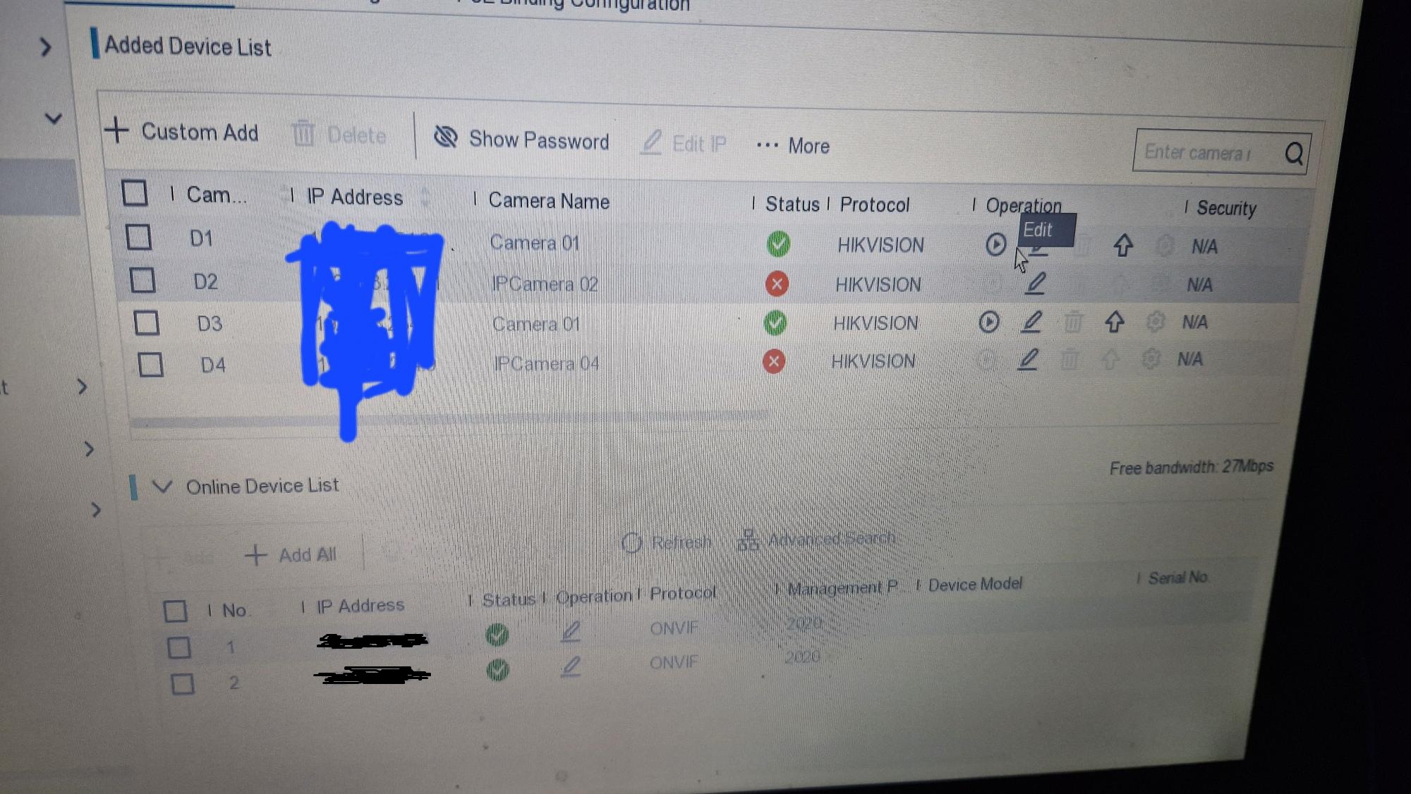

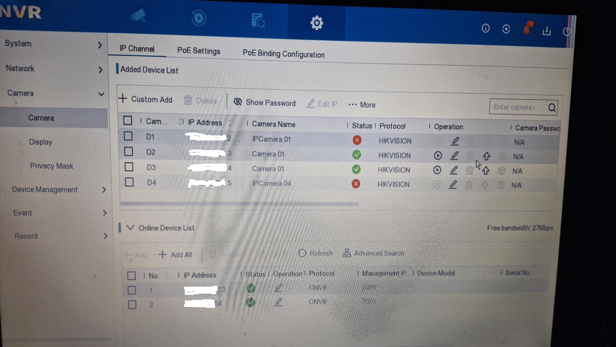

Here's what I'm seeing:
The 2 not posting btw are on 20meter cables and they're the furthest away which I don't think matters.
Any advice would be great as I'm super confused,
Cheers

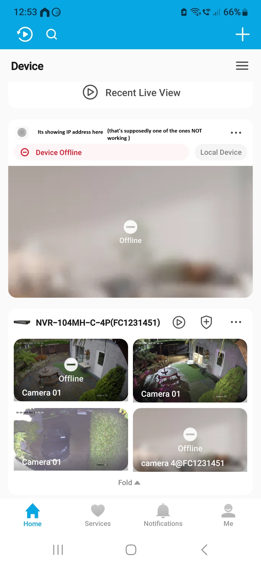

this is how is looks on the phone It naming the npn working as IP adresses or 4@fc .. whatever that means. the only thing i can think todo is a factory reset on the NVR scdreen.jpg

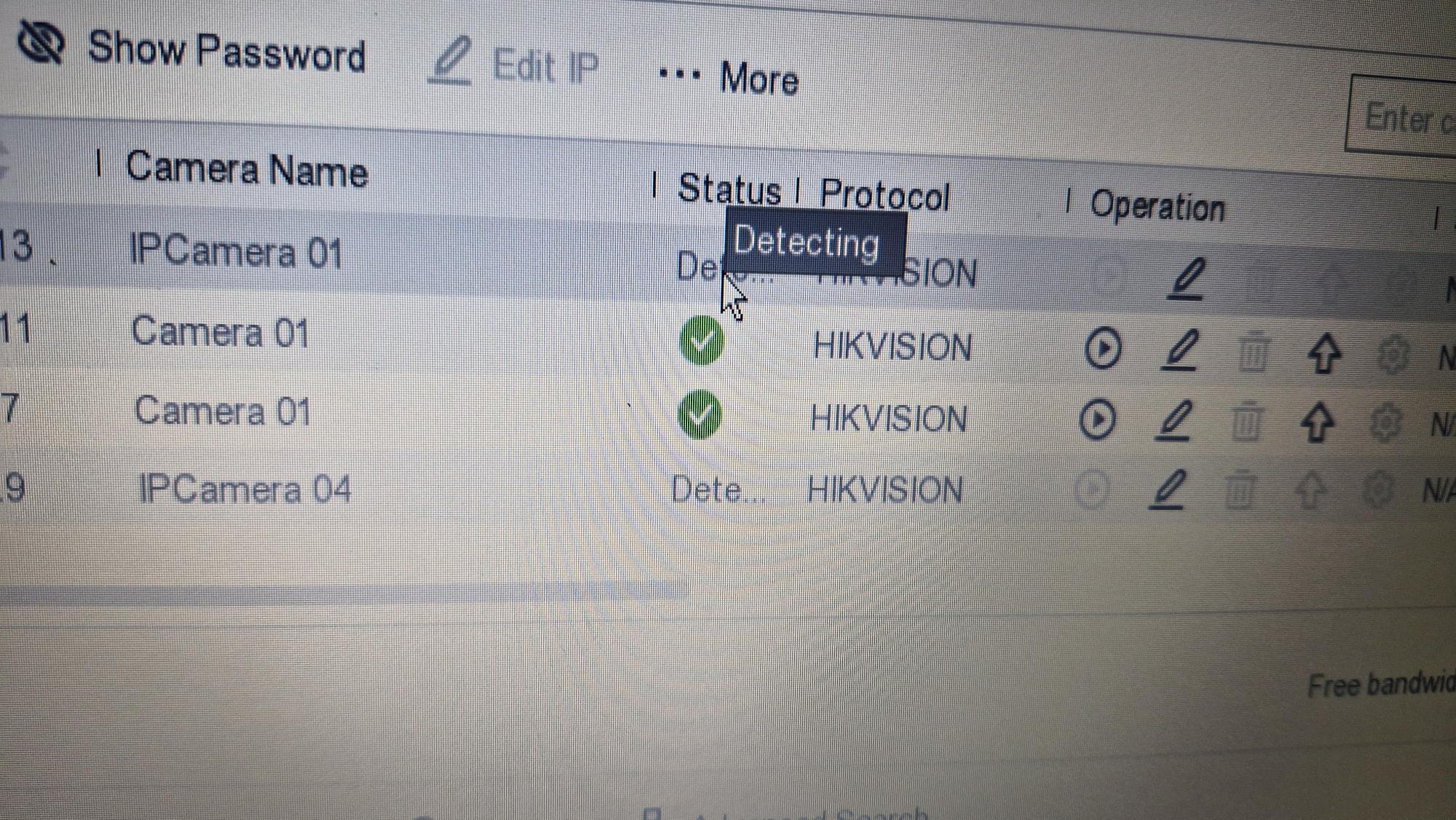

So, I took down the camera and plugged it in with another Ethernet and did the reset but still nothing.
The light on it flashed when plugged in, so it works.
It just keeps saying detecting on screen.

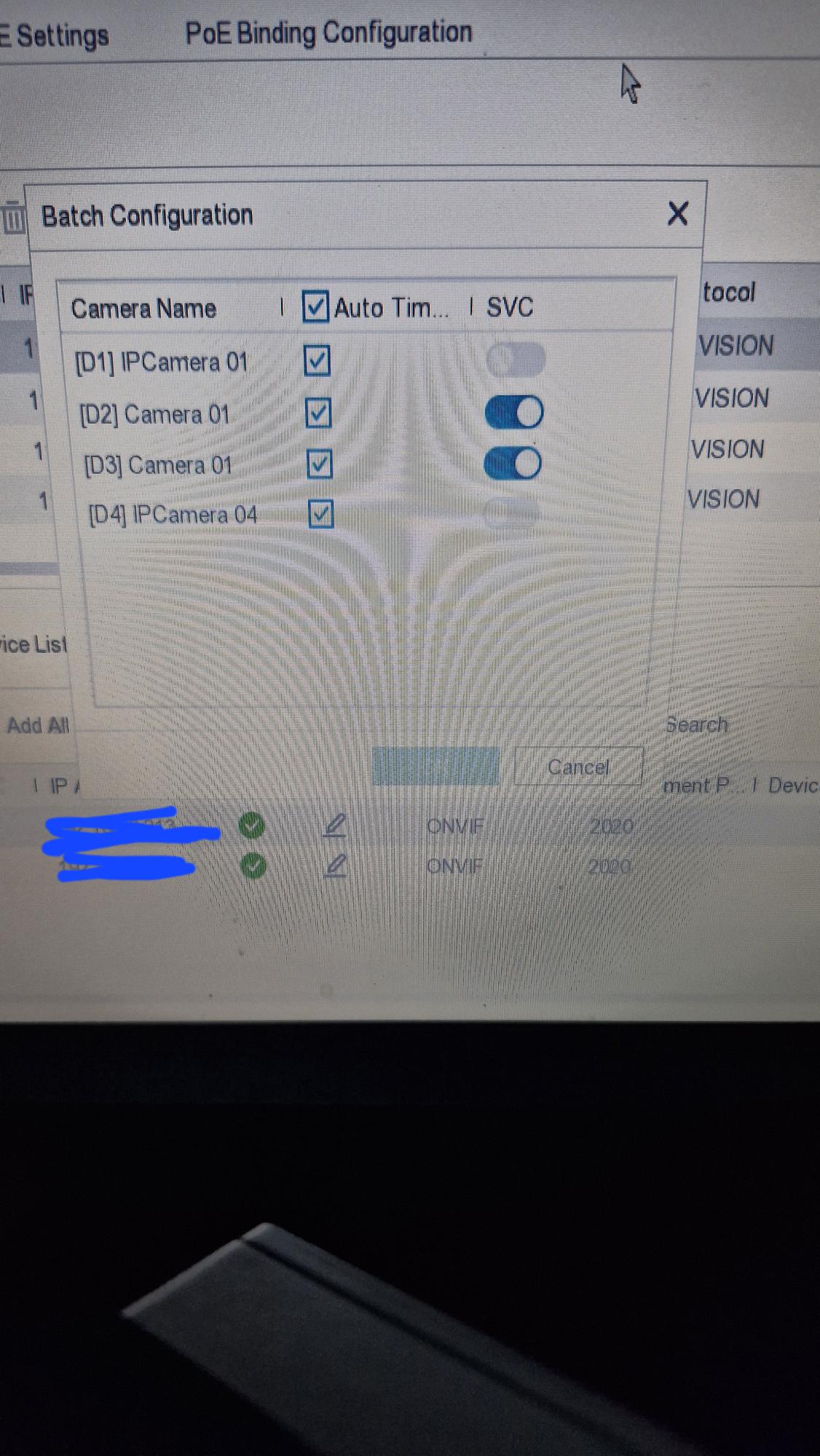

And, I don't think this means anything but SVC is off on the non working 2, but I'm assuming it's because they're not working.
