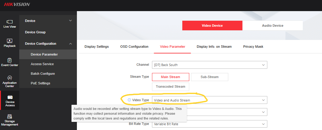

D Donvito7 Member Messages 8 Points 3 Dec 7, 2024 #1 As in the subject line. Is there any instructyion how to record audio from the camera?
J johnfitzy Gives a lot of help Trusted Member Messages 296 Points 43 Dec 7, 2024 #2 Hi @Donvito7 ... Here's how on a DS-7616NI-M2/16P NVR:
