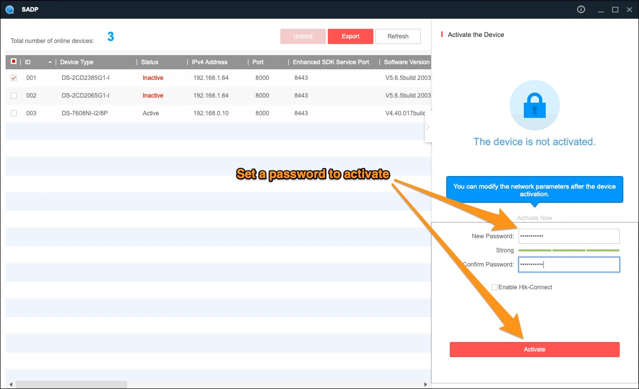

You should see a list of all the devices on the network, any that have not been activated are marked as "Inactive" in the "Status" column. Select the inactive device from the list by ticking the corresponding box on the left.
Step 3:
You should then be prompted to set a password for it in the right-hand flyout:
Set and confirm a password that SADP classifies as strong – you should use a combination of at least three of the following in your password for it to do so:
- Upper-case letters
- Lower-case letters
- Numbers
- Symbols.
If you have existing devices in your system, then using the same password as these means you don't need to keep a list of passwords for each device, as well as saving you time during future configuration.

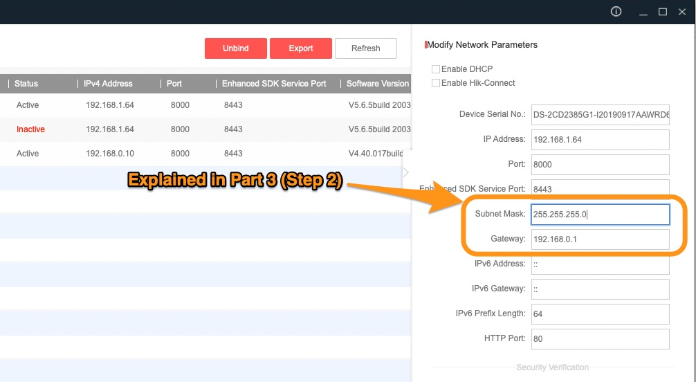

You now need to change a few of the "network parameters" in the right-hand side flyout so that the device can be accessed on your network.

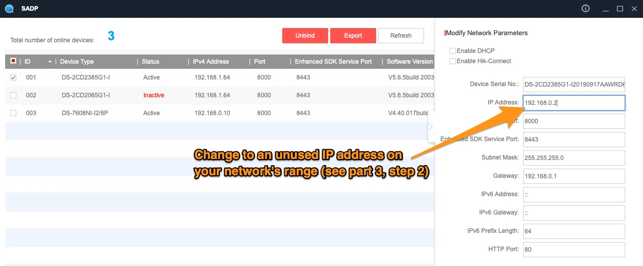

Step 5:
Now, you need to set a unique IP address for your new device, which also needs to be within your LAN range. This is explained in detail in the guides linked in step 3, but if your gateway address is "192.168.1.1", then the device will need an address within the range of "192.168.1.x" where "x" is any unused address (including the gateway) between 1 and 254.

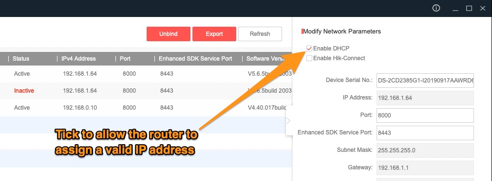

If you don’t need to set a specific IP address, or still aren’t sure which ones are available to use, then you can always tick the Enable DHCP box. This will get your router to automatically assign a working IP to the new device. Once the IP address changes (after you click modify), make a note of it and untick this box again to stop it from changing in the future.
Note - DHCP will only work if the Gateway field is correctly set for your network.

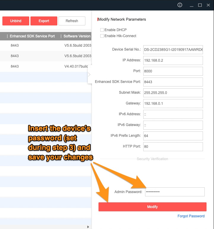

Finally, type in the password that you activated the device with during step 3, and then click "Modify" to save your changes.

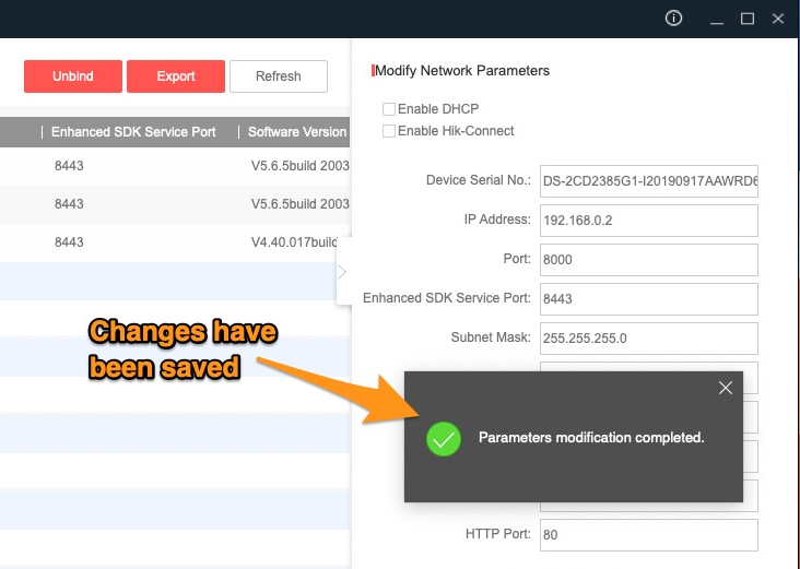

You'll see a "Parameters modification completed" popup to confirm that the password is correct and your changes have been saved:
