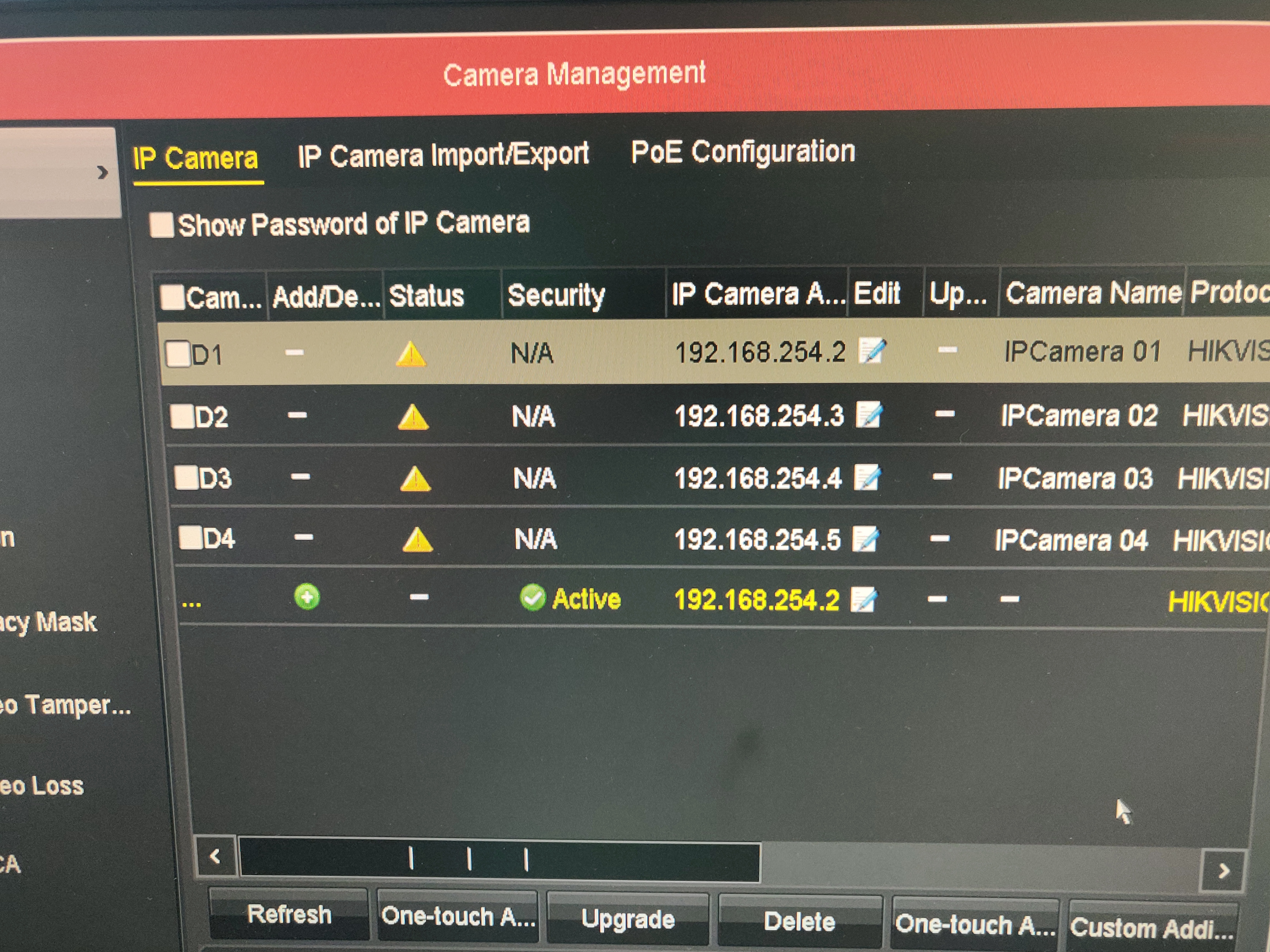

I have managed to do that but having issues setting up the IP camera on the NVR.
When I change the first camera from Manual to plug and play I can see the camera which is now been connect to the POE. However I can't view anything.
I guess how do I identify the new IP address?

Ok, I may have cracked it Phil. I located the IP address of the the camera as now it's connected to the Network switch. There was a no IP allocated.
I downloaded SDAP. Clicked on the IP Camera and enabled DHCP. (I suppose I could have given it a static IP address)
I put the new IP address in the D1 slot and it's working.
