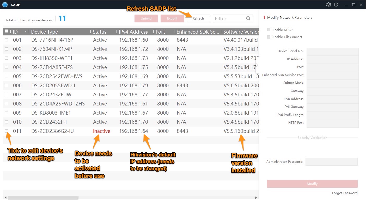

Now, launch the SADP tool again. It should show a list of all the Hikvision devices on your local network and their default network settings. Provided the device is being powered and has a connection to your LAN, then it will show up here. You can also alter the device’s network settings here, and check things like the model number, serial number, the firmware version installed on it.​
NB - Remember that any camera that is directly connected to your NVR's PoE ports will not show up in SADP. This is because the NVR hides any cameras directly connected to it from SADP on its own "subnet", which is separate from your local network. Don't worry though, as you won't need to change the settings for these cameras.

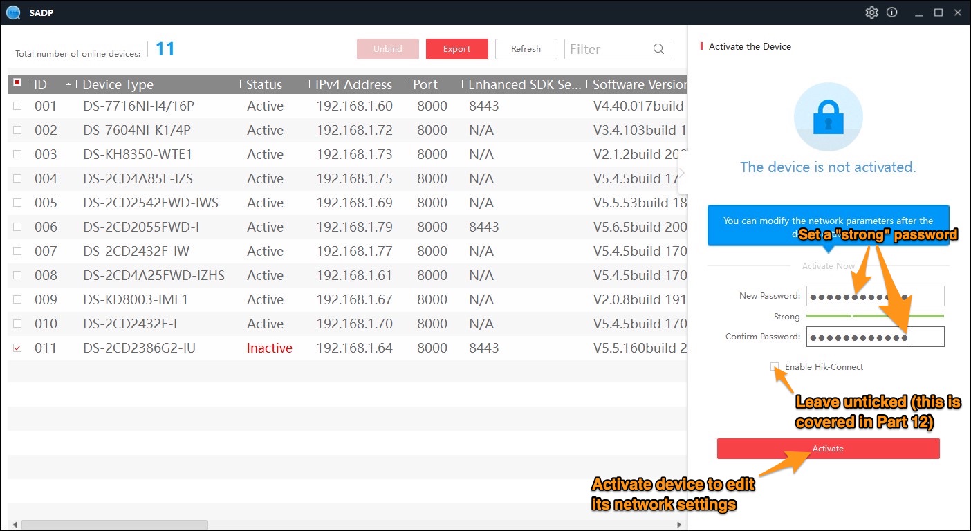

Tick the box beside your device to view and edit the network settings.​

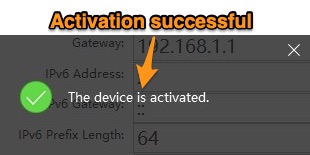

If the device hasn’t yet been connected to the network then it will show as "Inactive". You will be asked to set a password for it when you click the tick-box for it. For more instructions on activating your device, please see Part 6.​

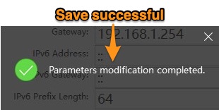

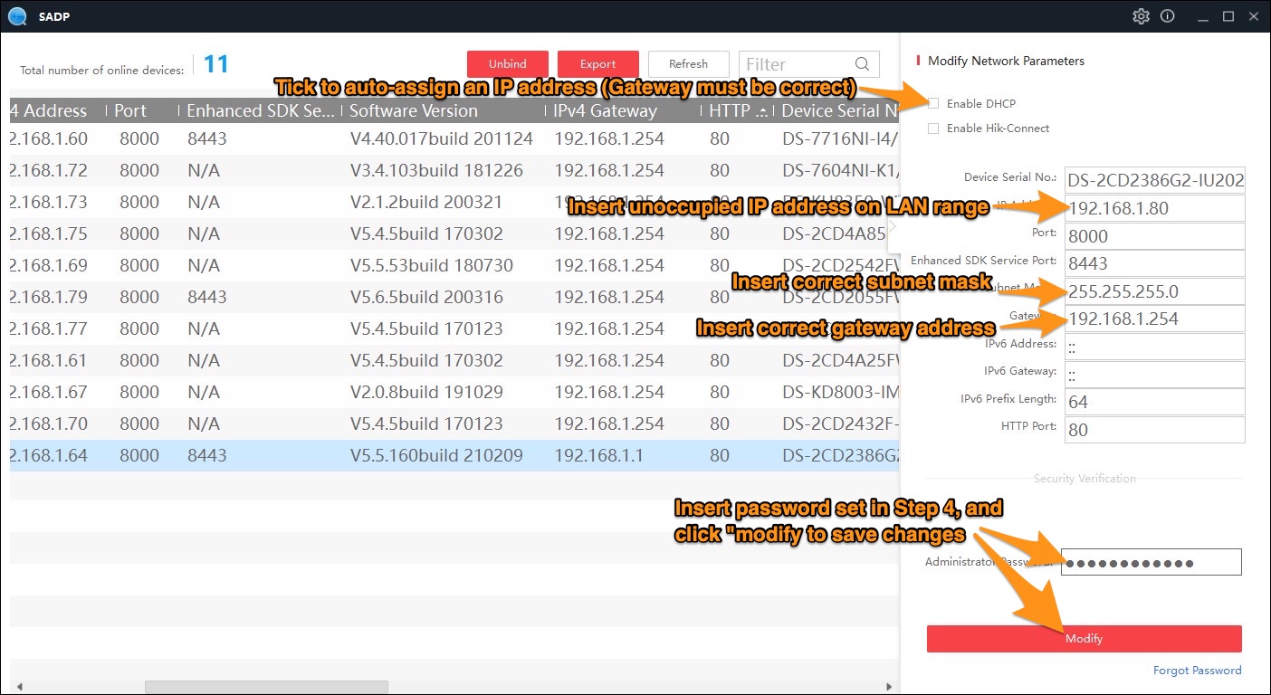

Once activated, ticking the box beside your device will change the network settings in the "Modify Network Parameters" window, so that they match your LAN. You need to make sure that you enter the password for that device before clicking "Modify" for these changes to be saved.​
